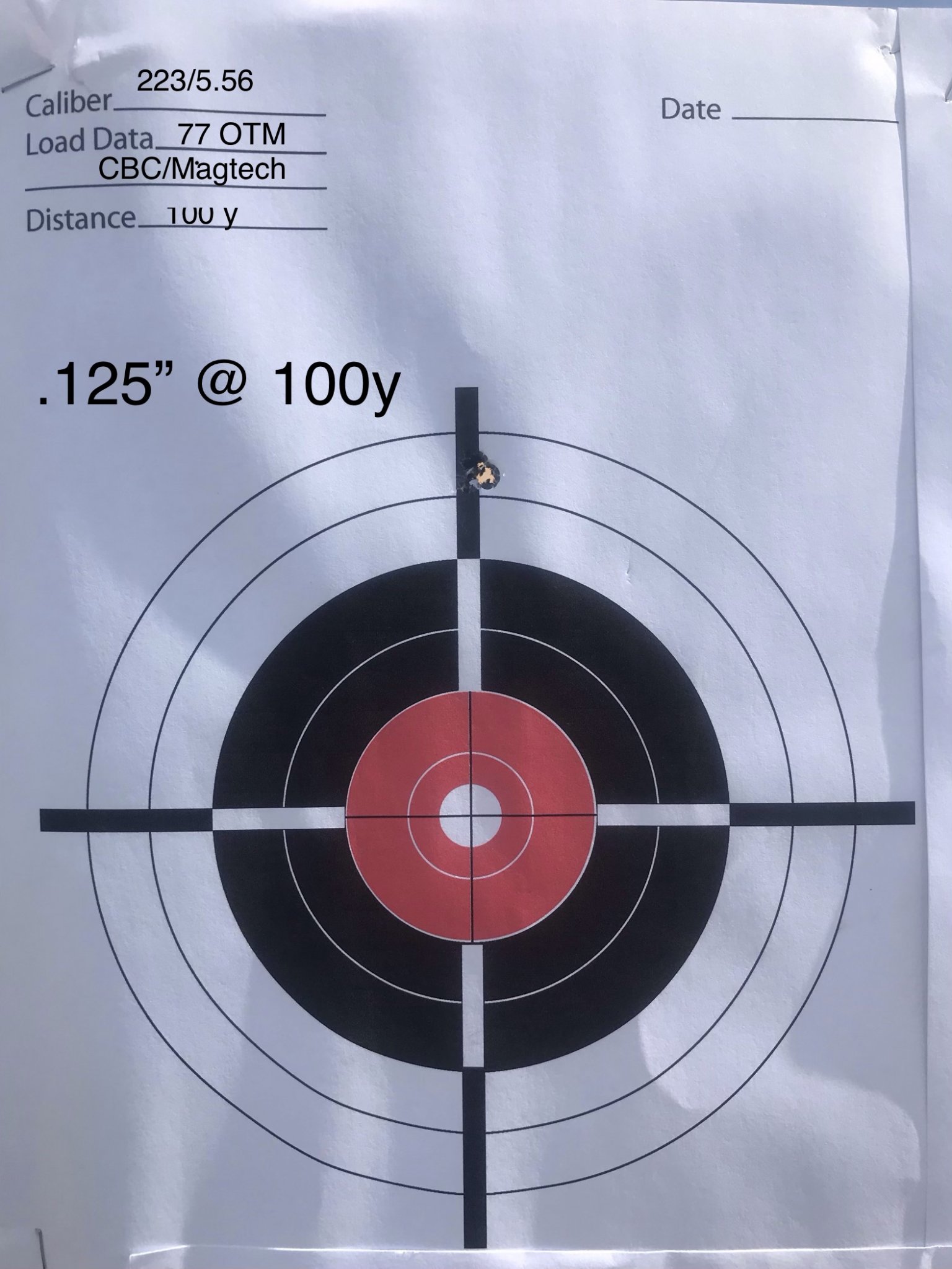

First 3 shots of Magtech OTM 77 SMK out of a 16” 1:7 WOA. I personally prefer 1:7. It shot cheap PMC bronze 55 grain FMJ right around 1” as well. My previous 1:7’s has done very well with 60 grain V-Max’s as well.

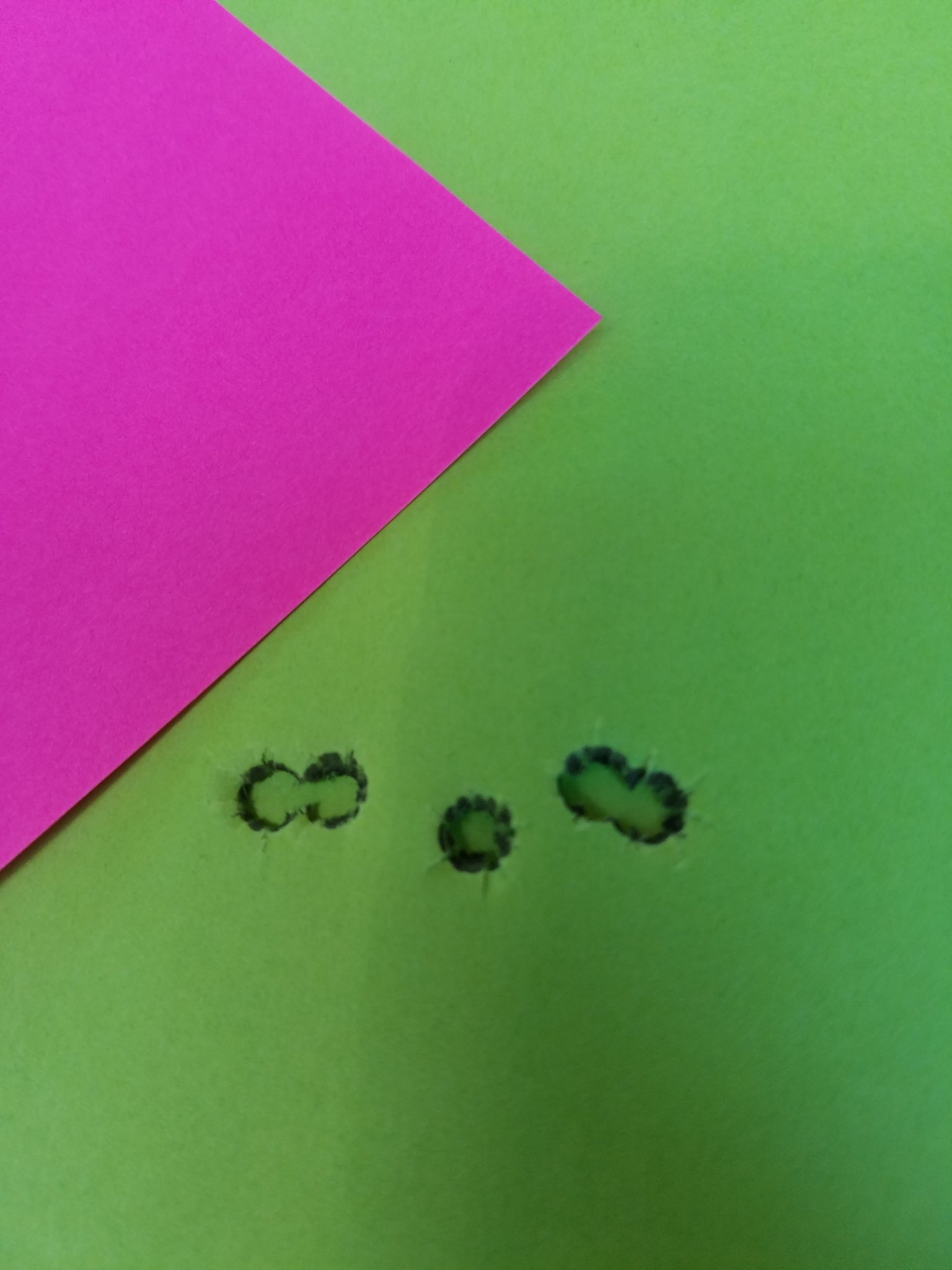

I once shot some light plastic type training rounds through my 1:7 AR
At 25 yards they were going to make a mess if they hit something as they were tumbling end over end by the time they hit the paper HA!
Kind of like when I tried the Lapua Subsonic .308 rounds out of my 1:12 AW rifle... at 100 yards you didn't want to get hit by that bullet, it was spinning end over end.
I'm not sure if that counts for extra kill points at very close range or not HA!
