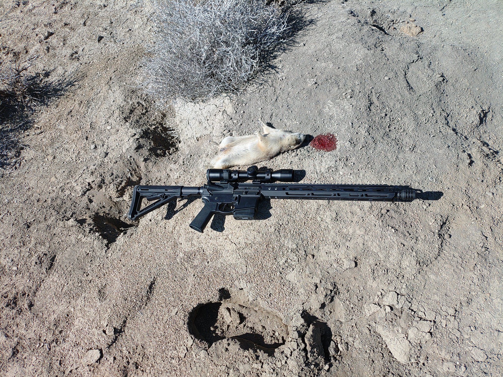

Headshot a pdog today at 143 yards with Armalite barrel carbine. Has a 2-7x Nikon on it and seems to shoot everything from 40gr to 77gr into about 1.5" at 100 right now and cycles everything I have tried in it. I'm pretty sure my optic and myself are the limiting factor on this thing. I'll keep 52gr match hollow points handy with it for now.
Is that a Rise trigger?
