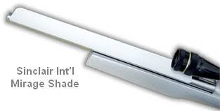

<span style="font-weight: bold">Everybody:</span> Yes while shooting a match with a higher magnification scope you will get significant target distortion from the mirage/heat waves coming off your barrel as you look through the scope. This is easily fixed, for "free."
Sure you can buy a barrel mirage shield. But what I do is go to my local Lowe's Home center. They have "cut to length" vertical venetian blinds for sliding glass doors. The ends they cut off for the customer are of no use (to most) and are discarded in the trash. Drop by and ask for a few of these and they'll give you all you want. They are perfect and work great. Trim to length so it covers from near your scope base to the muzzle. sticky velcro dots on the plastic, as well as your barrel and your set up just as good as "store bought."
Whether you buy from a shooting supply or make your own as i did, here is what it will look like:

This photo is from the Sinclair International website and they'd be tickled to sell you one.
