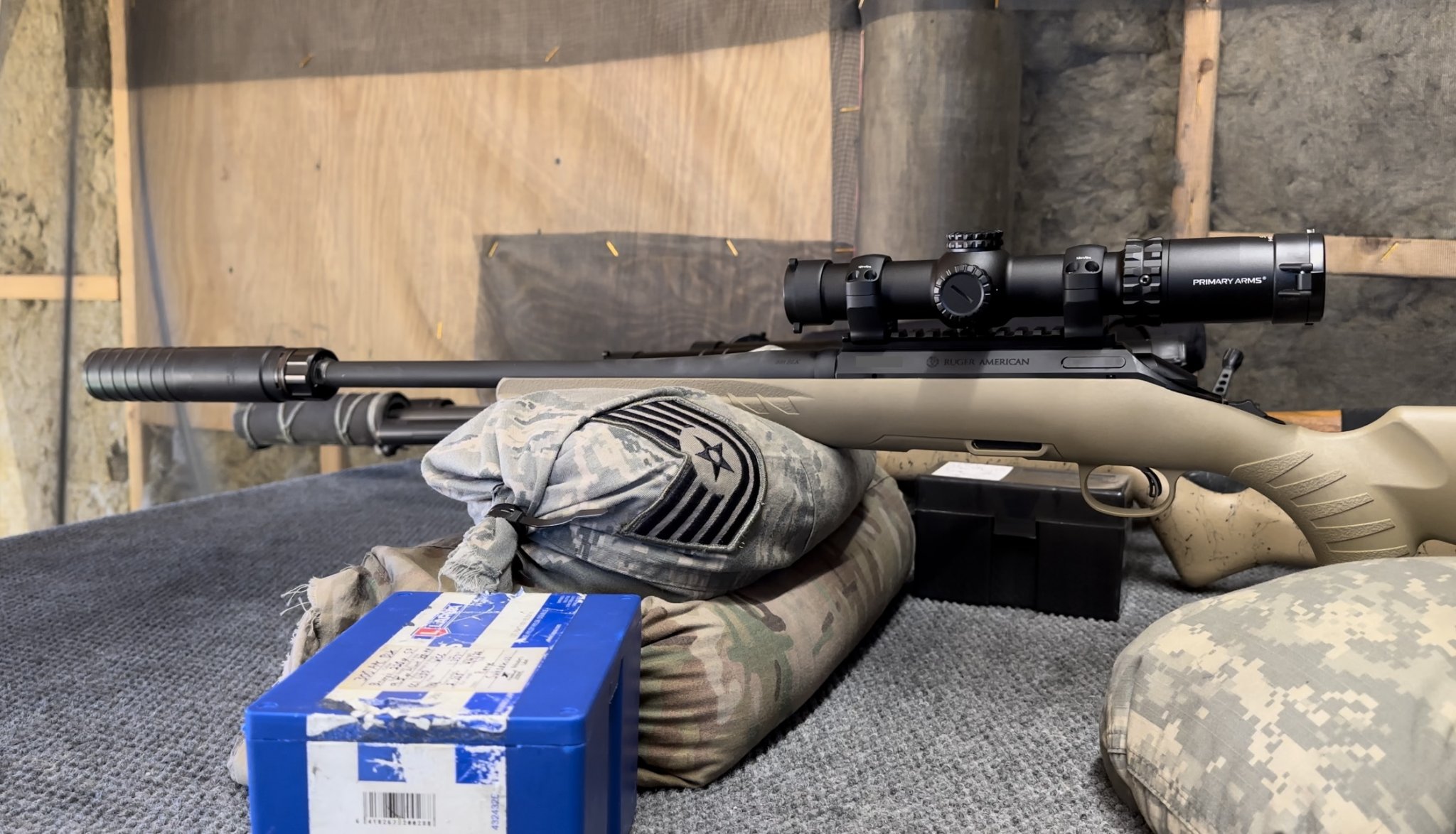

While we're throwing out opinions... Here's one that will probably make some laugh and roll their eyes, but it's my own opinion, and I'm not forcing anyone else to accept it. It just is what it is.
I have a different outlook on LPVO's... Because I'm not trying to shoot more than 500 yards with one. So, alpha-tier glass is not a requirement for me. So, my opinions on LPVO's and some target scopes make folks laugh, but I'm more worried about durability, reliability, repeatability, and function over supreme glass in the SHTF type scenarios. I have alpha-tier scopes, several... But they're on my hunting rifles, where I take care of them and don't abuse them or knock them around. Target scopes...As long as I can see the damn target, I can hit it. So supreme glass isn't a must. That's why I have quite a few cheaper budget scopes (like Arken & Vortex) on those range-only target toys.
So, here's my recommendation on an LPVO for target shooting and SHTF...
This isn't a high-end optic by any means, but the glass is more than acceptable for 500 yard shooting, and it has a 34mm tube, with lots of elevation and windage adjustment (for an LPVO), and it seems to be built like a tank (weighs almost 20oz)... I really like the reticle (ACSS Griffin M10S MIL), and holdovers are quick and easy once getting your 100 yard zero set.
Are there a few things I'd change about it, even if the price went up a bit...Sure. I'd love to see it get an exposed elevation turret (MIL), and FFP reticle. If the price was still under $750, I'd be all about it. Yes, the glass is that impressive in the one I have. Is it Chinesium? Unfortunately... But it's a damn decent scope for the money.
