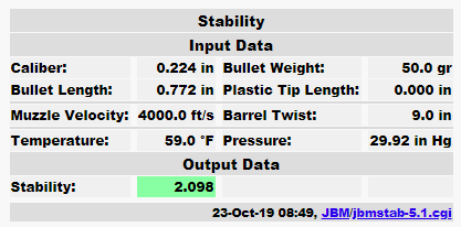

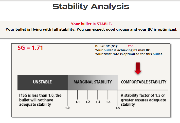

A 50 grain superperformance vmax is .772" long according to jbms length library, you get the following stability results via jbm and berger
9 twist

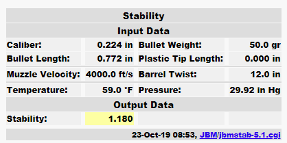

Lets make it a 12 twist with that 50 grain vmax
At 4,000 fps a 13 twist it goes unstable and at 10.6 twist it hits the 1.5 stability factor.
That is with the superperformance velocities, a 12 twist will work fine but wont be ideally stable.

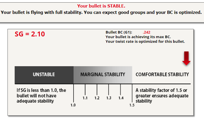

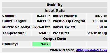

Hornady 55vmax varmint express goes 3,275 by item description and is .811 long
9 Twist
3275x720/9=262,000 very comfortable

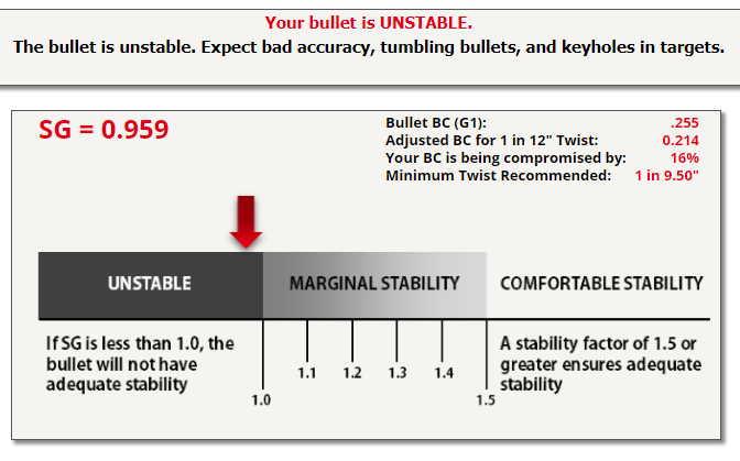

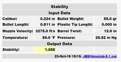

12 Twist
3275x720/12=196,500

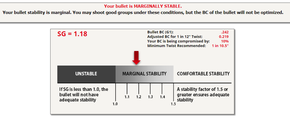

12 Twist with a not overcharged superperformace loading under the 55 grain is on the edge of unstable, jbm says barely stable, berger barely not stable. A 60 gr would be worse. If you want to shoot the 50-60 grain then 9 twist is what you want.
9 twist
9 Twist
12 Twist
3275x720/12=196,500
9 twist
