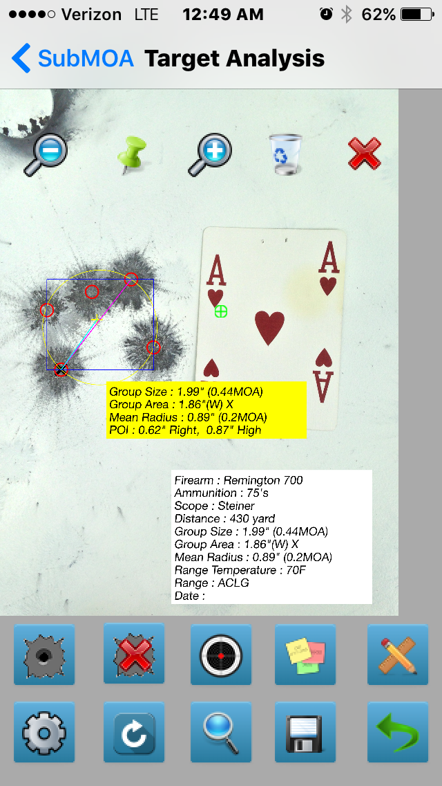

My "junky" Rem 700 1/9 twist SPS shooting 75's @ 430

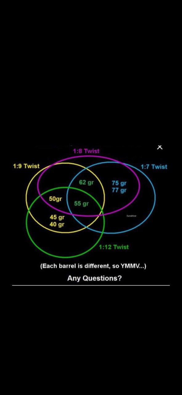

But, like I said, the majority of factory ammo is better suited to a 1-8. Heavier bullets than 77 might call for a 1-7 or 1-7.5 (just look at all the 224 Valkyrie twist rate debates). The graphic someone posted up above is pretty accurate, IMO. 1-9 stops being ideal around 65-69 grains. I guess 1-9 would be better suited to really light sub-50 grain varmint style bullets, but that's sort of niche.
