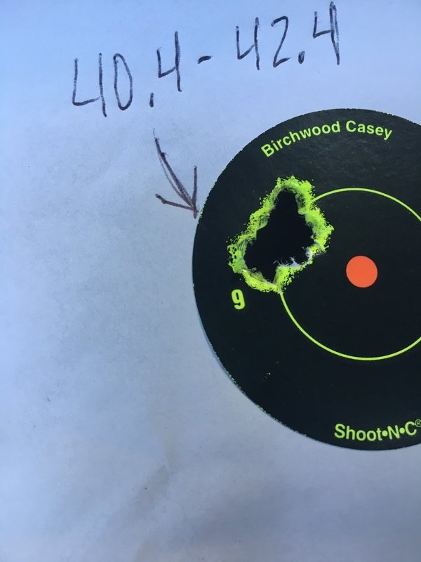

dont have any that span 5 grains, but got these 2 from some load work up i did recently, some barrels just like anything you throw at em...my old 223 was similar
40.4-42.4 was 6 rounds of different charges in 22 creed, 80 vlds
This one was 8 rounds of 1 charge each from 42.5-45.6 w/ 308, 155 amax
