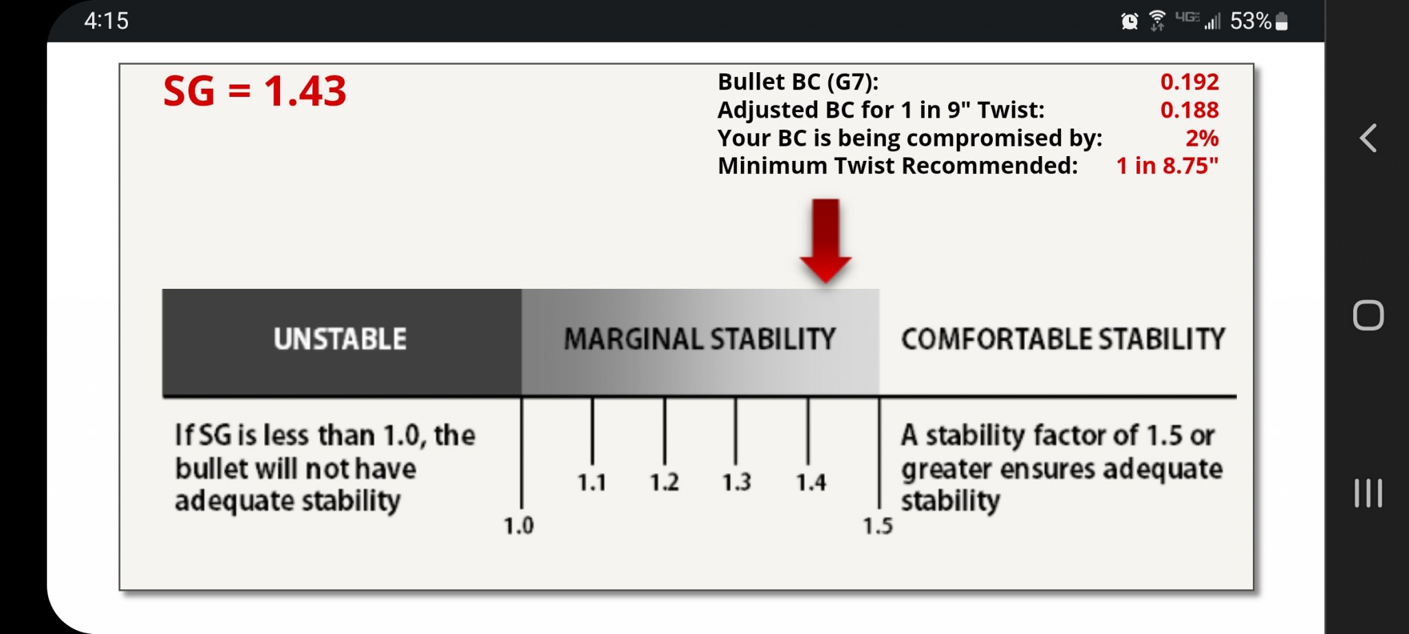

I have a 20 inch hbar chrome lined Delton upper, less than 500 rounds through it. 1 in 9 twist.
My shooting is typically done at 2k altitude and 70 degrees plus temps.
Eventually Id like to reload and figure a hot loading would do better with a 1 in 9 twist. Buffalo bore 77 gr loads are getting 2850 out of a 20 inch barrel for example.
I fired 2 boxes of 77 gr otm rounds at 100 yards and accuracy was about 2.5 moa. No key holing.
My question is can a 20 inch 1 in 9 twist adequately stabilize the 77 grain smk with my atmospheric conditions?
I plugged a 77 otm in the Berger calculator. 2850 fps at 2000 altitude. Came back as marginal. I have a 9 twist and run 73s as it is very finiky with anything heavier. Mine shoots 73 BT bergers really well.
Stability factor
At 2650 muzzle velocity...
Sg: 1.78
The bullet will be well stabilized and yaw will be minimized. This is a good twist for maximum ballistic performance.
At 2750 muzzle veloity...
Sg: 1.81
At 2850 mv ( Buffalo bore spec)
Sg: 1.83
Projectile length of 0.95 inches.
Sg: 1.78
Sg: 1.81
Sg: 1.83
You’re good with those numbers.
  • Love
Reactions: Davo308
Yes. I did multiple Temps. At 95 degrees it goes to a 1.52. Might be worth trying. Me, if I had 69s or 73s I would run those. 9 twist tops out (typically) at 75gr. But different bullets, barrels etc. Just my .02.
Reactions: Gohring65
I wasn’t swiping at you, I just wondered if you entered his temp or not. I figured you probably did, but wanted to satisfy my curiosity. I always ran the 68 bthp in my colt hbar 9 twist and did very well to 550 yards.
Not worries, did not take it as a swipe. I ran 73s at 2960, yes that was a bit warm, but it shot lights out. I ran that at a milk jug challenge and had impacts at 1k, 1200 and 9th round impact at 1500 yards. It was dying at 1500. Bryce ran his 223 as well and his 77gr stuck in the backer at 1500 after going through water filled milk jug. I think he was pushing the 77 at 2850.
Sg: 1.78
Sg: 1.81
Sg: 1.83
Update berger calculator using 0.994 projectile length is still 0.51 stability factor at 2750 fps.
FWIW... I'd suggest making sure your barrels twist is truly 1n9.
Lots of barrels can be faster or slower than the stated twist rate.
It's doing 2.5 moa at 100....the bullet isn't working in your barrel...plain and simple.
Buy a 7 twist and be done with it , at today's ammo prices you'll have paid for a barrel by the time you figure out your 9 twist isn't happy with a 77gr
