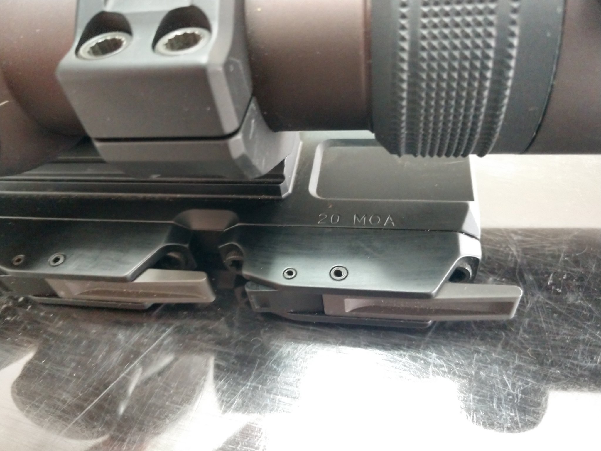

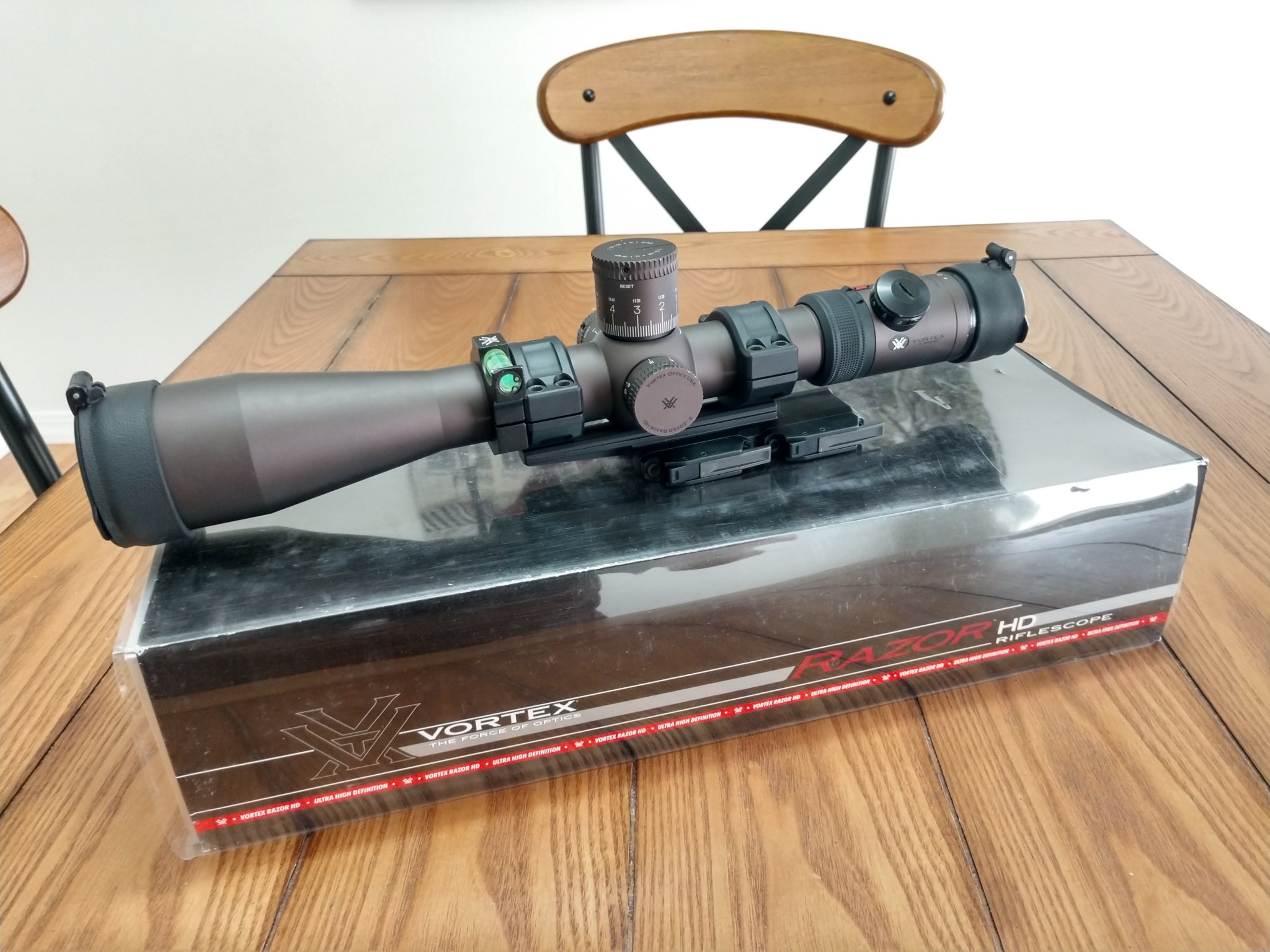

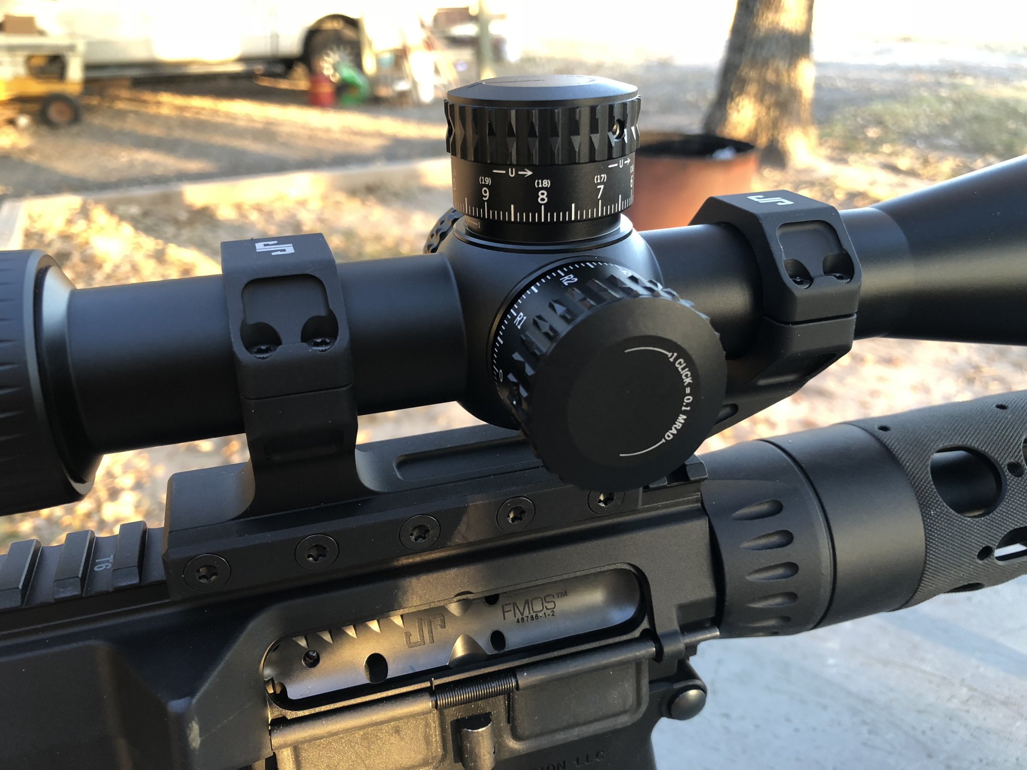

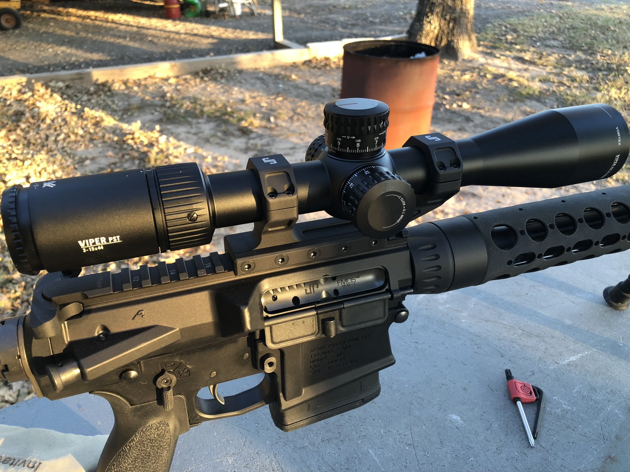

    I use a Bobro on a Vortex 1-8. I normally use Badger Ordnance on everything else and have a Seekonk torque wrench. I decided to try a JP mount and installed one yesterday. I’ve only fired enough to get a good zero but so far, I like it.
