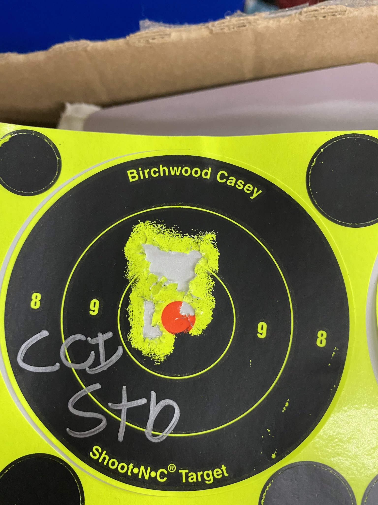

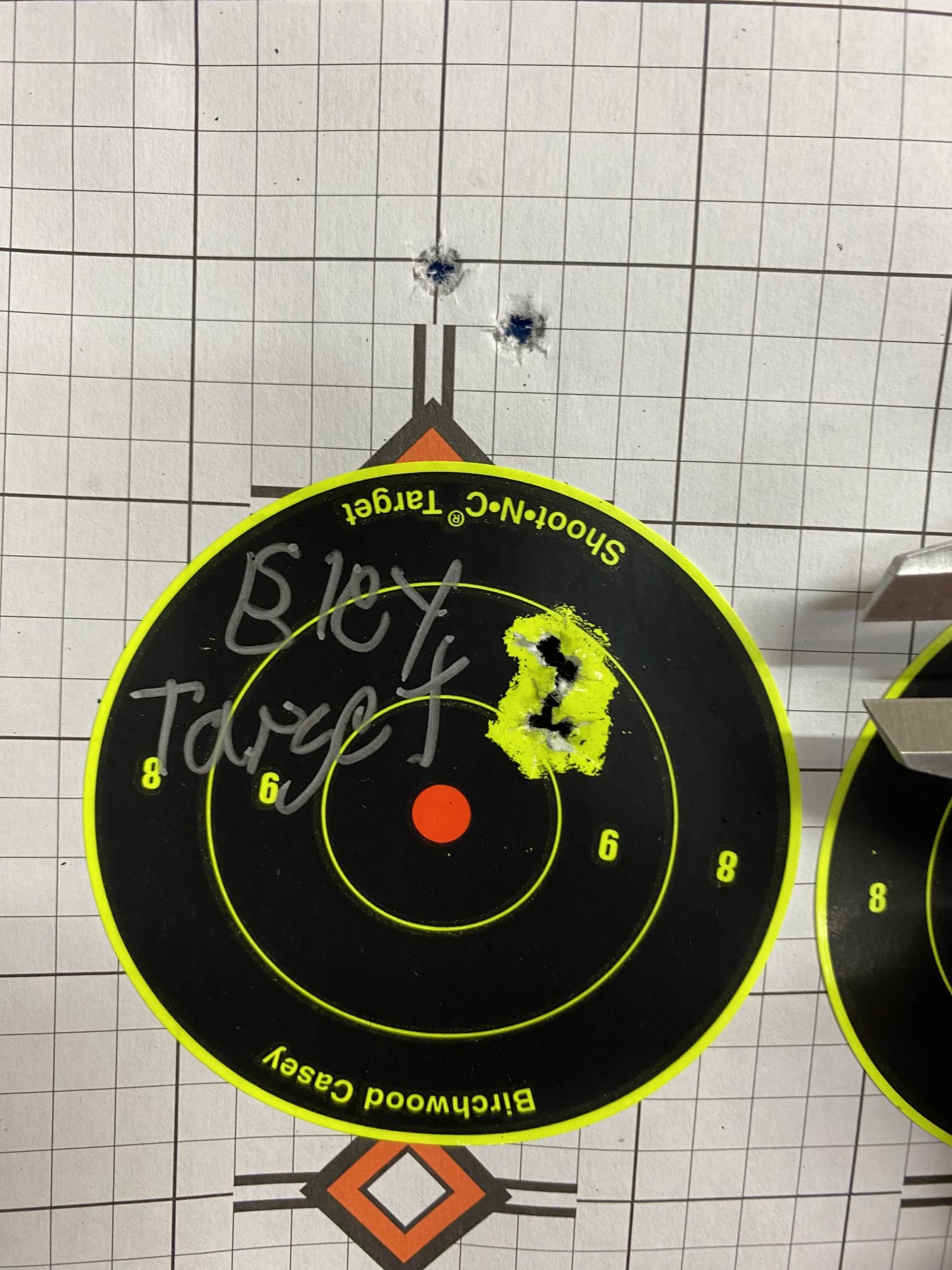

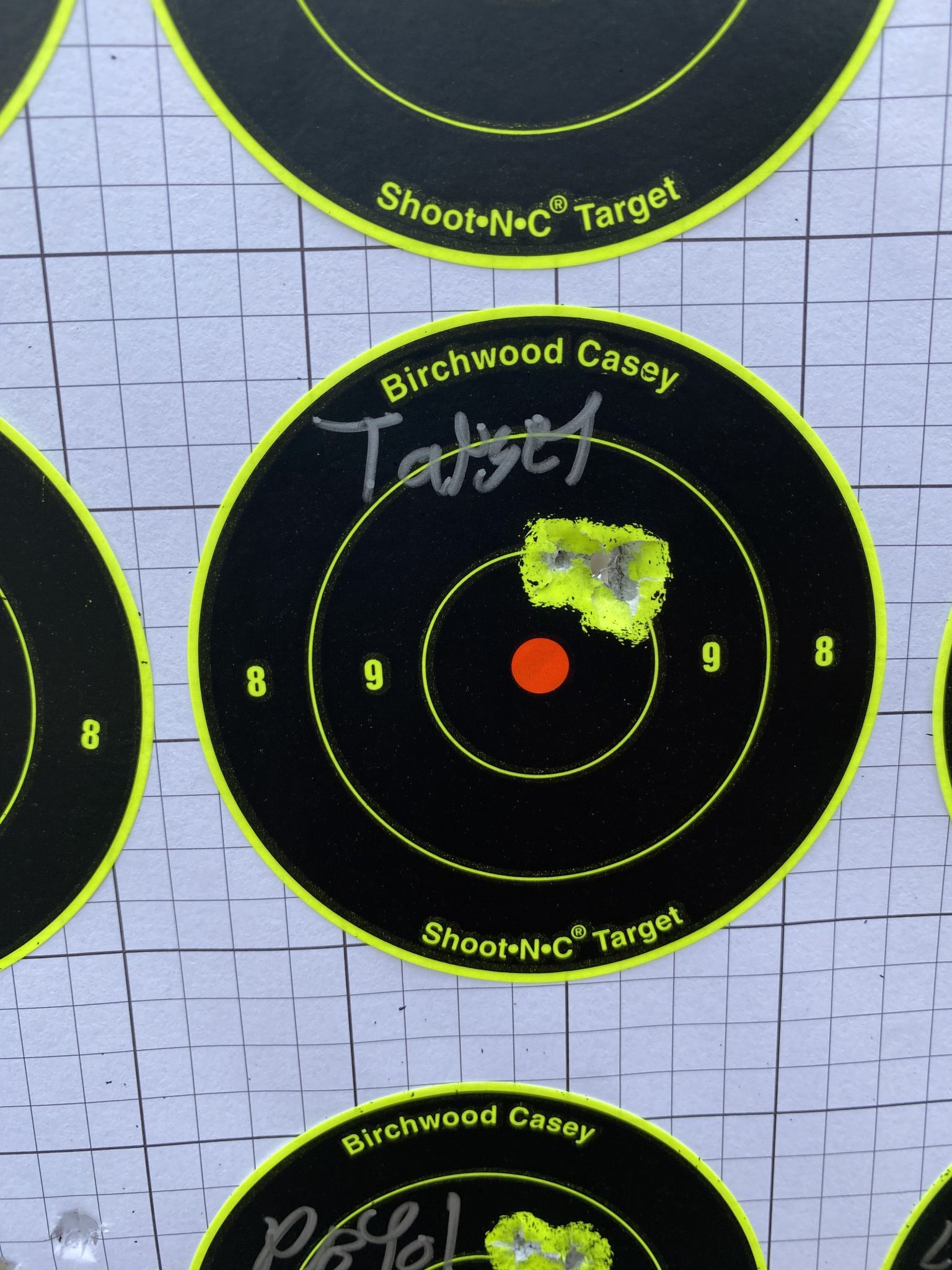

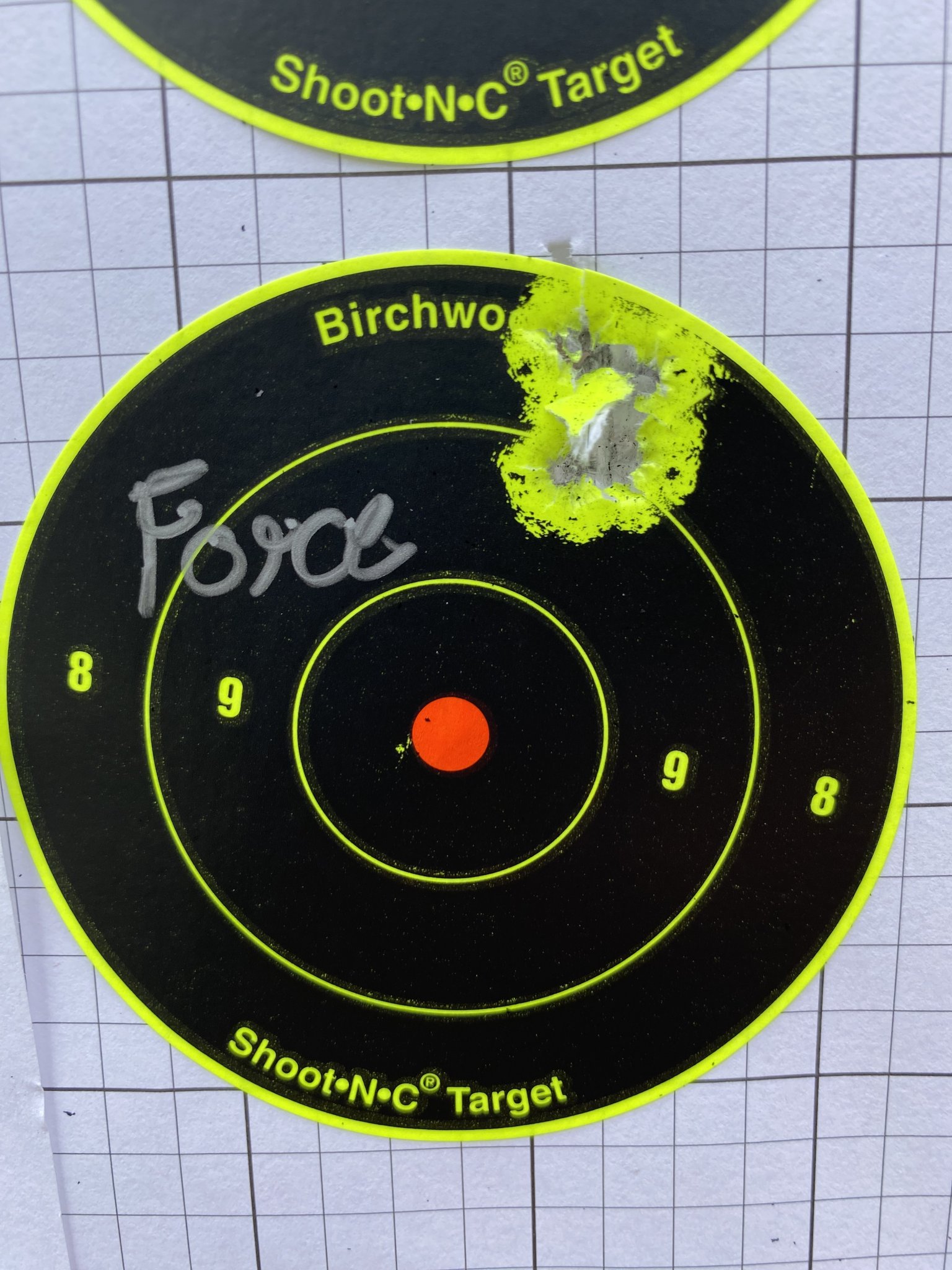

Older thread but oh well, send the barreled action to Randy at CPC best $200 you’ll ever spend. Get the full treatment(receiver, bolt, barrel and trigger job). No parts get thrown in a box and wasted the rifle runs perfectly, Randy has a complete system. Mine shoots ragged holes with CCI standard all day(10-shot group shown). I found Eley target and force shoots damn near one hole 5-shot groups at 50yrds. No cherry picking this is just shooting one after another. Gun never jams and is silky smooth. Throw a Victor titan stock on it and you’ll be happy plus within budget. https://www.ct-precision.com/ Later build another from scratch if you want to go all out but shelving a bunch of perfectly good parts that just needed tuning is not the way to go.
Cheers
