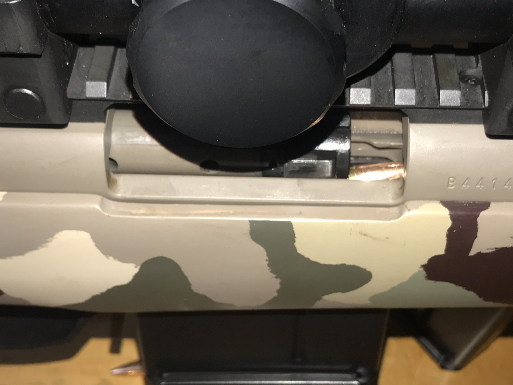

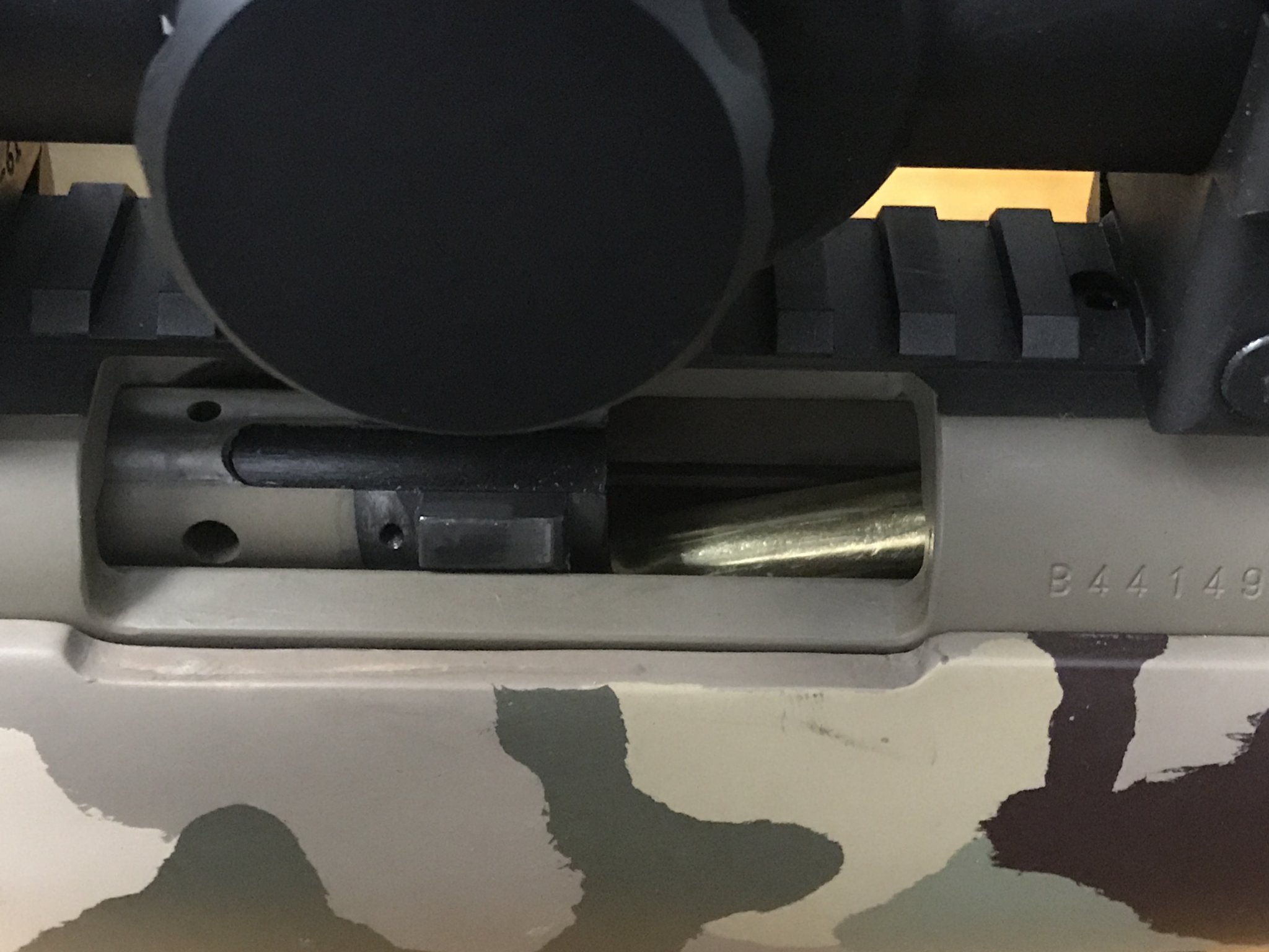

Here are a couple pics of what's going on with my magazine ... it's more of an "assdive" rather than a nosedive.

I have 2 that are doing the exact same thing I have tried putting AI spring and follower in them and they still do it, not every round but enough that it gets aggravating. I am running mine in a Surgeon 591 so I will try the feed lips and see if that will fix the issue.
Surgeons are almost all of the actions that won't work with our followers FYI. Some do run, but most people still experiencing nosedives tell me they have a Surgeon.
