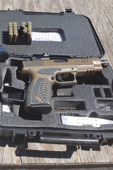

    My primary platform is a Springfield XDm10 4.5 OSP

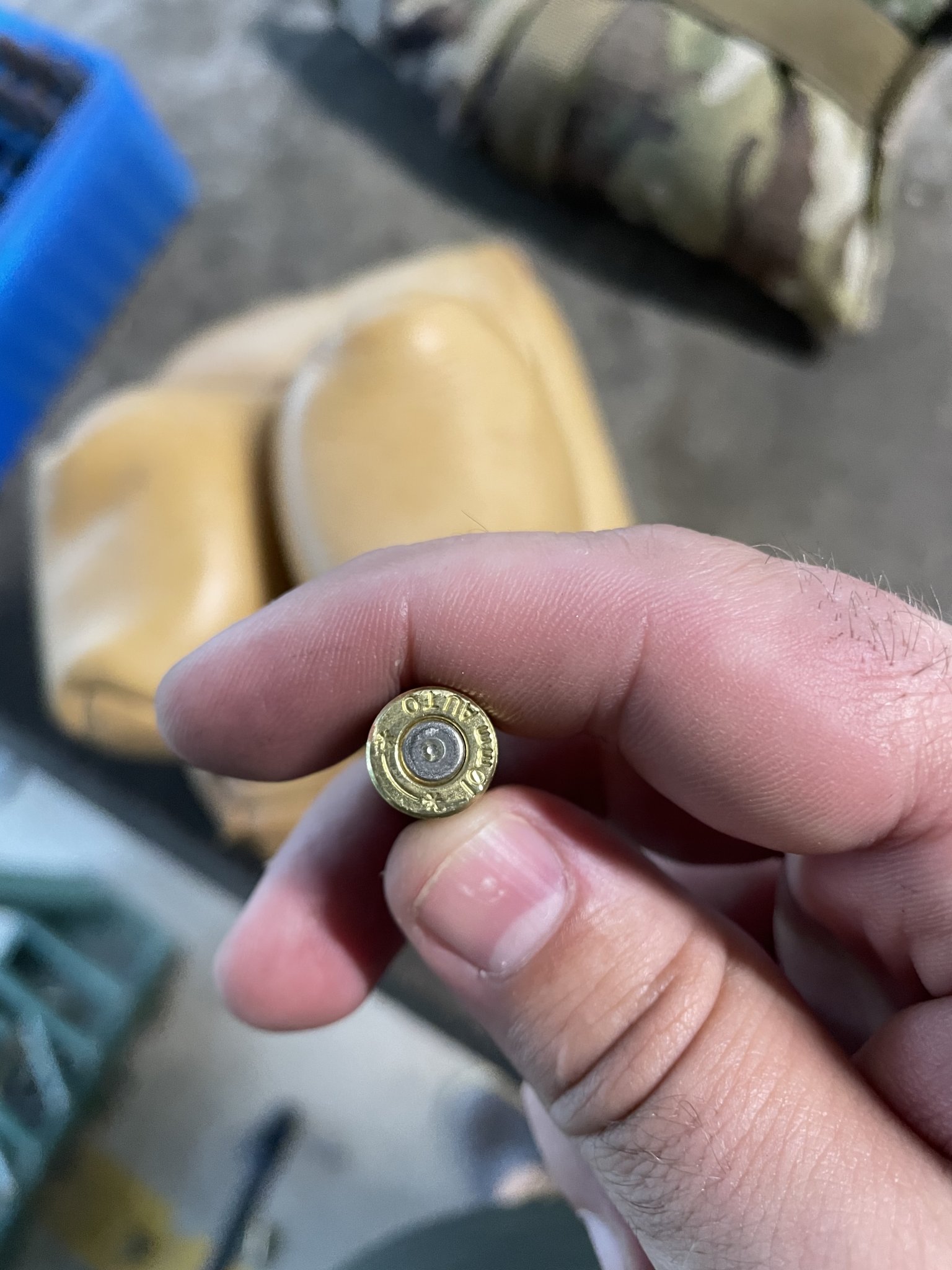

    I noticed at reduced loads this residue will occur in the 10mm.

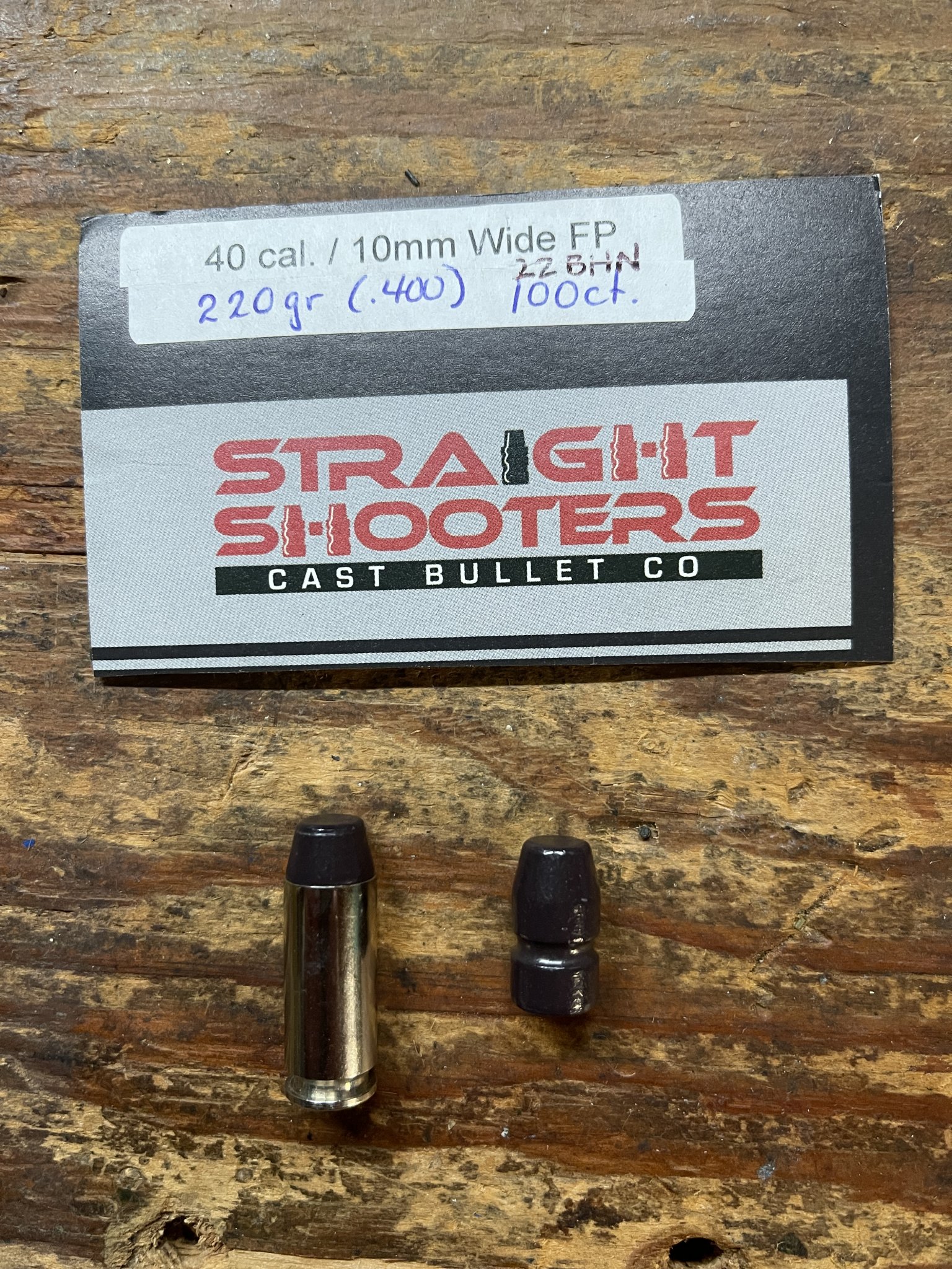

    I've seen molds online for 220 gr. with a similar profile and length at the Xtreme 220gr., but no one seems to be using those.
