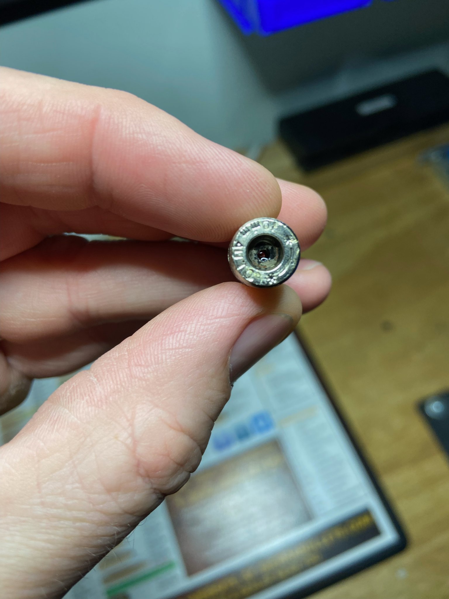

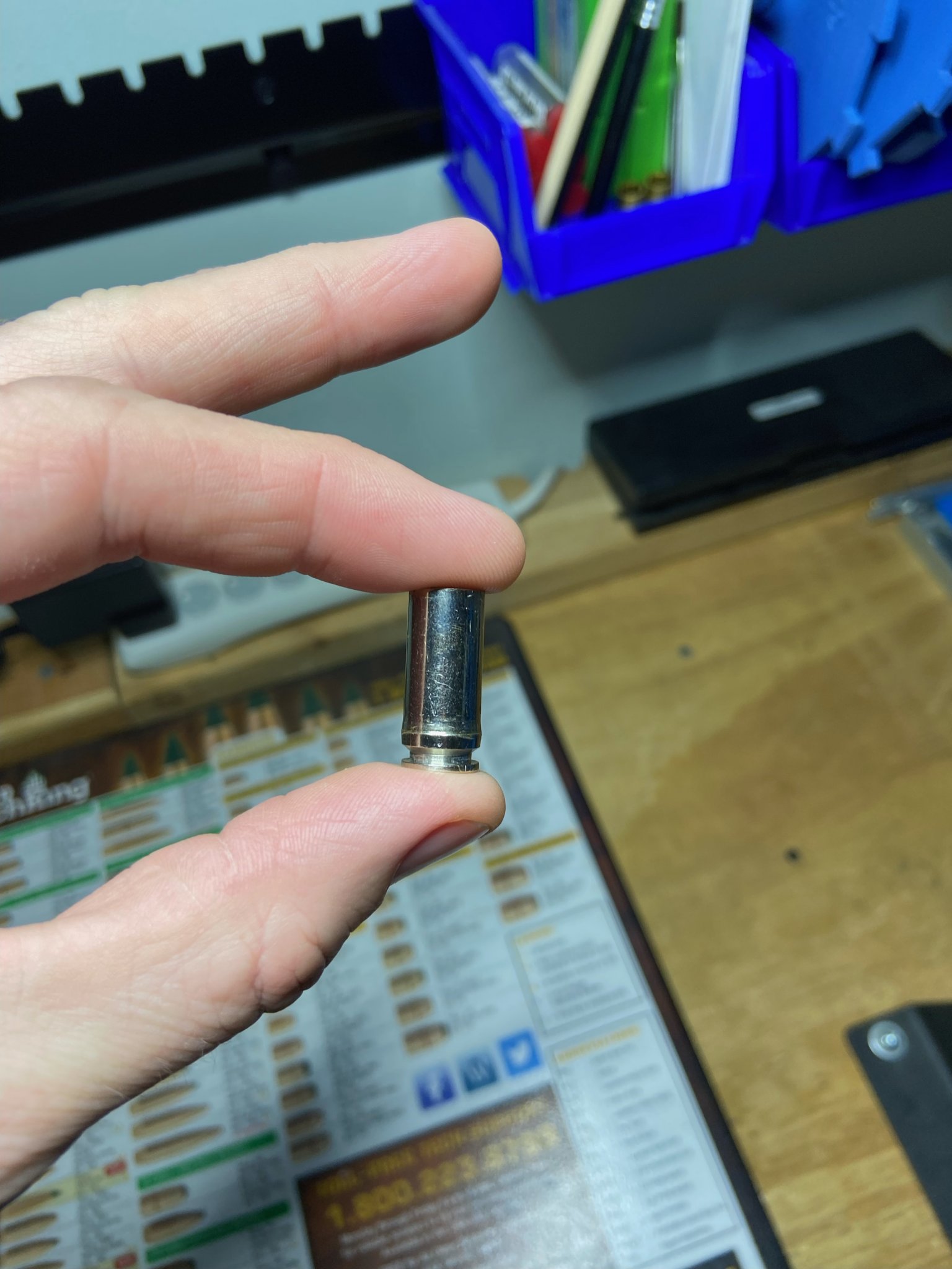

Got 49 of the 50 loaded up last night with 9.1gr of BE-86, but I ran into an odd piece of brass.
Appears to be nickel plated Starline and it just will not get all the way up into the die to resize the whole case. I'm using Dillon carbide dies with their spring loaded, and non-adjustable for height, decapping rod system, but I don't think it's a case of the decapping rod sticking in the flash hole and stopping the case from going deeper into the die. It took a primer easily, but I broke the round down after tumbling the lube off for 15min when I saw the ring around the bottom and it wouldn't chamber.
Also, may a pox be put on the man/men who decided small primer 10mm was a good idea. The 1,000pcs of range pick-up I bought seem to be 20-30% small primer :mad: I think I'll end up culling those along the way and just buying virgin large primer from Starline or another manufacturer in the future.

That piece looks like it was about to separate on the next firing. Good thing you caught it.
It's good thing to have the Lee bulge buster die especially if shooting the Glocks in 10mm and 40S&W which is notorious for leaving bulges in brass. I had the G40 for awhile then migrated to the fine 1911 series and my brass are in better shape for reloading. BE-86 is a good powder as I am using AA #9.

A belted magnum!

Yeah that brass is bulged pretty bad.
While you could force it through a Lee “Bulge Buster” kit (basically a 40 S&W FCD with the top removed), it won’t fix the integrity of the brass. I’ve done that and then sectioned the pieces; the brass ends up with some scary thin spots that aren’t safe.
Chances are that may have had a loose-ish primer pocket anyway.
The small primer brass is stronger, primer pockets don’t loosen as easily, but can be a real pain when mixed in with LP brass.

It's hard to tell for sure, because the sizing die might have changed the appearance, but that bulged case above looks like it happened because of early unlocking rather than an unsupported chamber. That's more common with hot 10mm loads than is generally understood IMO, especially now that 10mm has been making a comeback and becoming more mainstream again. Most 10mm semi-auto pistols are still set up to cycle reliably with the common "FBI Lite" loads - you know, the cheaper ammo that's basically 40 S&W ballistics from the longer 10mm case. When a lot of those pistols are used with real full power 10mm loads, unlocking happens too early and we start to see bulged cases either at the feed ramp or all the way around like the one above.
It also could have been from a blowback action - they're pretty prone to case bulges all the way around due to early opening with hot 10mm loads as well. (On a similar note, I experimented with a blowback 357 Sig carbine for a bit that was not only bulging cases, but pushing shoulders forward too for the same reason. Not a good scenario!)
The G40 is one of the few though that doesn't have as much issue with that; you can feel pretty comfortable that it'll handle much heavier loads than you've been using. Nothing wrong with going to a Barsto barrel, just be realistic to the fact that all tilt-breech 10mm pistol barrels are "unsupported" to some degree at the feed ramp. Most of the horror stories with Glocks though came from the earlier guns, gen 2 and 3. By the time gen 4 guns came around, Glock had put a lot more support back in the feed ramp area, especially in the 10mm barrels. With the right powder choices the standard gen 4 G20 will handle a 200gr @ 1200 fps safely, and the G40 will run a bit faster with the same load of course. Some of the earlier guns would bulge brass way before you reached that point because the feed ramps were too generous.

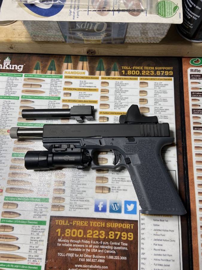

I agree that the jacked up case in my pic was probably from an action unlocking earlier than it should have, due to the fact that the donut is uniform and goes around the entire case. If it was a case of an unsupported chamber I would expect to see the bulge limited to where the feed ramp was.
I'm hoping to avoid this issue by way of a KKM threaded G40 length barrel and the aforementioned 24# NDZ recoil spring. I've read elsewhere the KKM barrels support the case a bit more than OEM Glock ones do.
I had a bunch of .40S&W from the CBP range in AZ when I lived there and it was pretty obvious which cases came from Agents shooting Glocks compared to other firearms on the line. I invested in a Lee Bulge Buster die before I eventually got out of .40 all together.
