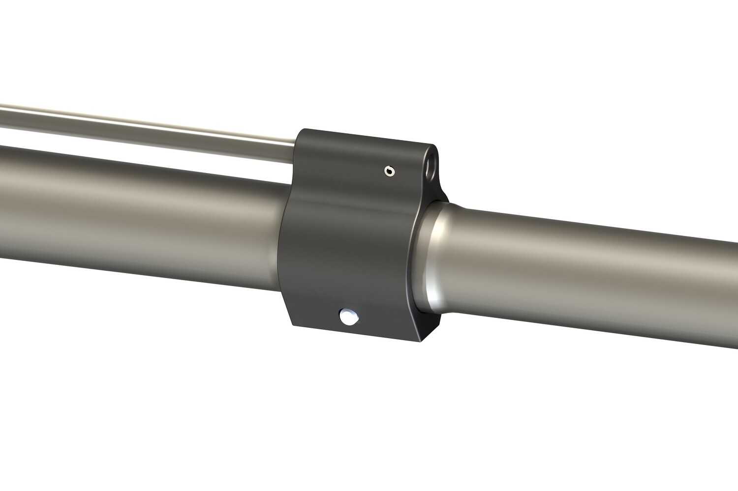

    These work well for dedicated suppressed:
