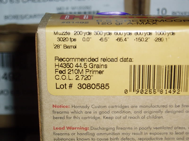

44gr varget was the original recipe printed on the Hornady boxes.

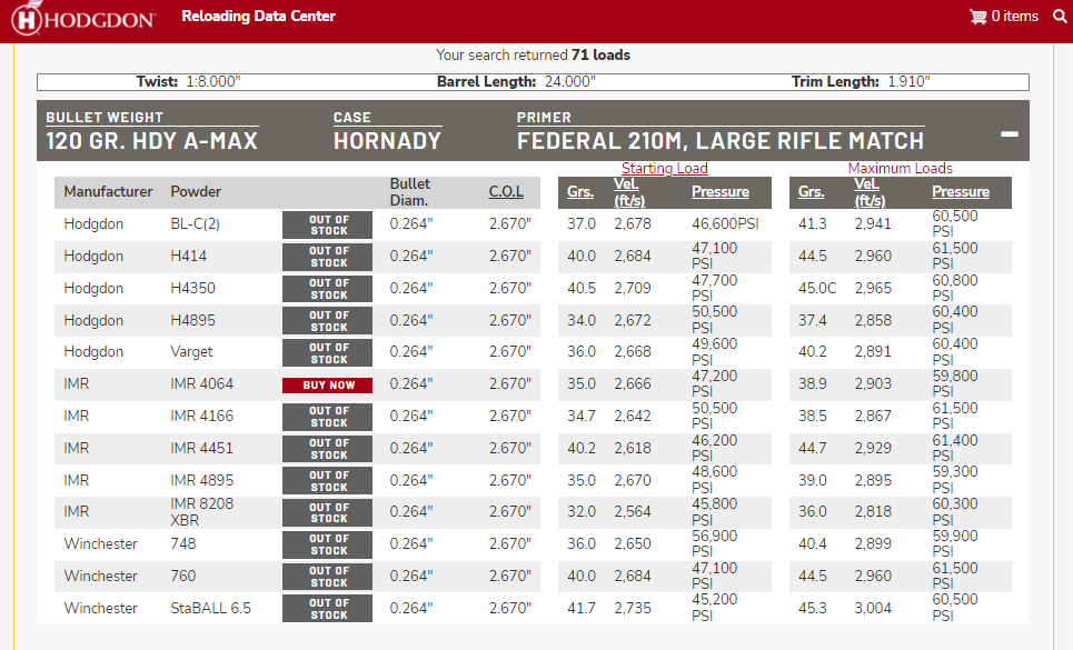

No the original load for 120 AMAX was 44.5grns of H4350. Hodgdon lists 40.2grns as the max with Varget and the 120 so I would work up if wanting to get to 44grns.
