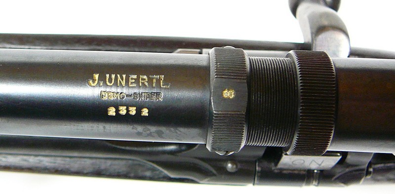

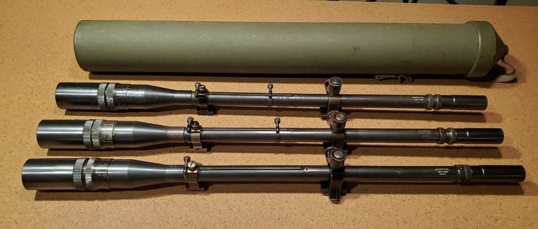

Here's some pics of mine so you can compare.
Could have been an original with the 8x power ocular assembly switched to a 12x. These scopes weren't sealed like modern ones and I believe it was possible to disassemble one. Pictures would be needed to really give an accurate answer.

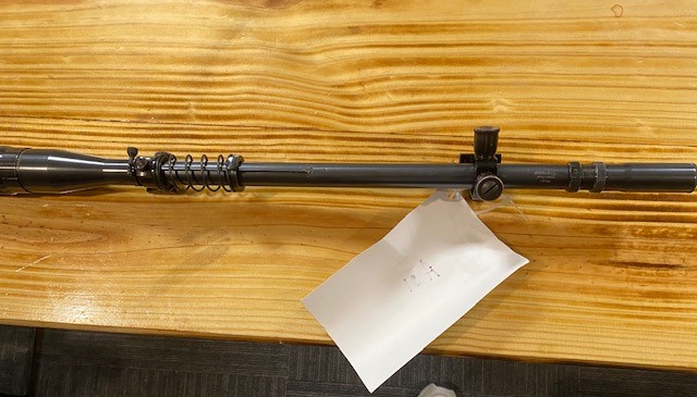

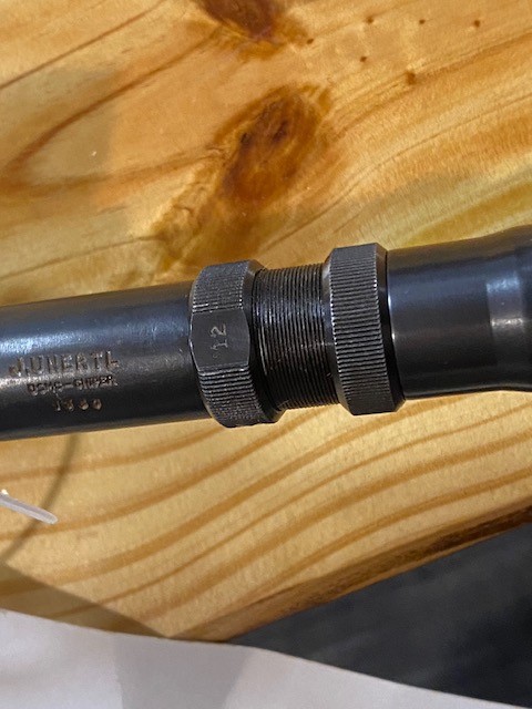

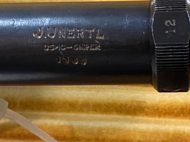

I'm attaching a couple of pictures. Please let me know what you think. I want to thank everyone for their responses. They have been most helpful. Judging from the serial number, it appears to be in the correct range. Any thoughts as to value (I'm hoping to buy it and don't know what a fair price is). It also has the Micarta case with it

Its real just set up for small bore most likely with the 12x and spring.
Deduct some of the value because it will he impossible to find the parts to make it 8x.
The early serial does help some though.

For me and my buddies with real rifles, we see that early serial number and it becomes very desirable for us. All evidence is that the early serials were the ones actually sent to the Pacific and many do not exist anymore. The early serial numbers are rare and most serials you see are in the 2000 serial range which always look new.
If that scope was 8X still, I think the scope by itself would sell for $4000 to $4500 just because of the serial.

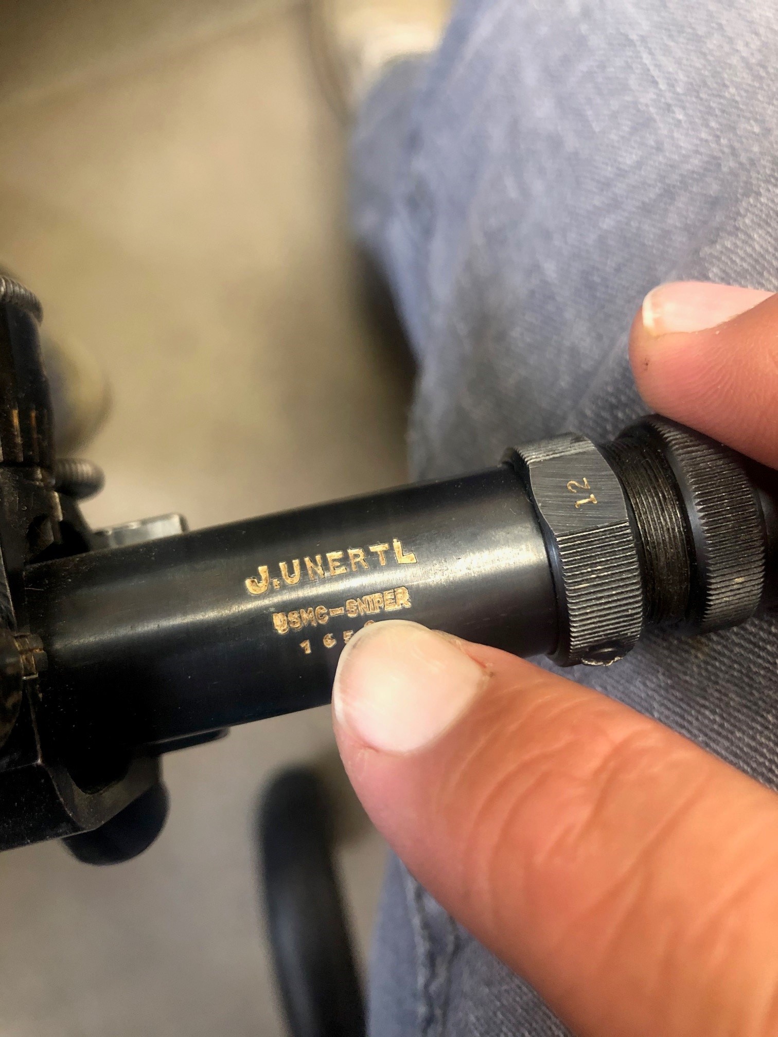

Ive seen and own them from 8x 10x 12x and 14x. Not uncommon as mentioned to change out the eye piece and VERY easy to do.
The last 3 I saw sell on auction on ebay went from 2800-3100
My 12xx ser range scope I got for 2200 on ebay. It is different than all the others as it looks parkerized. I believe it is 10x eyepiece.
GL!
DT
