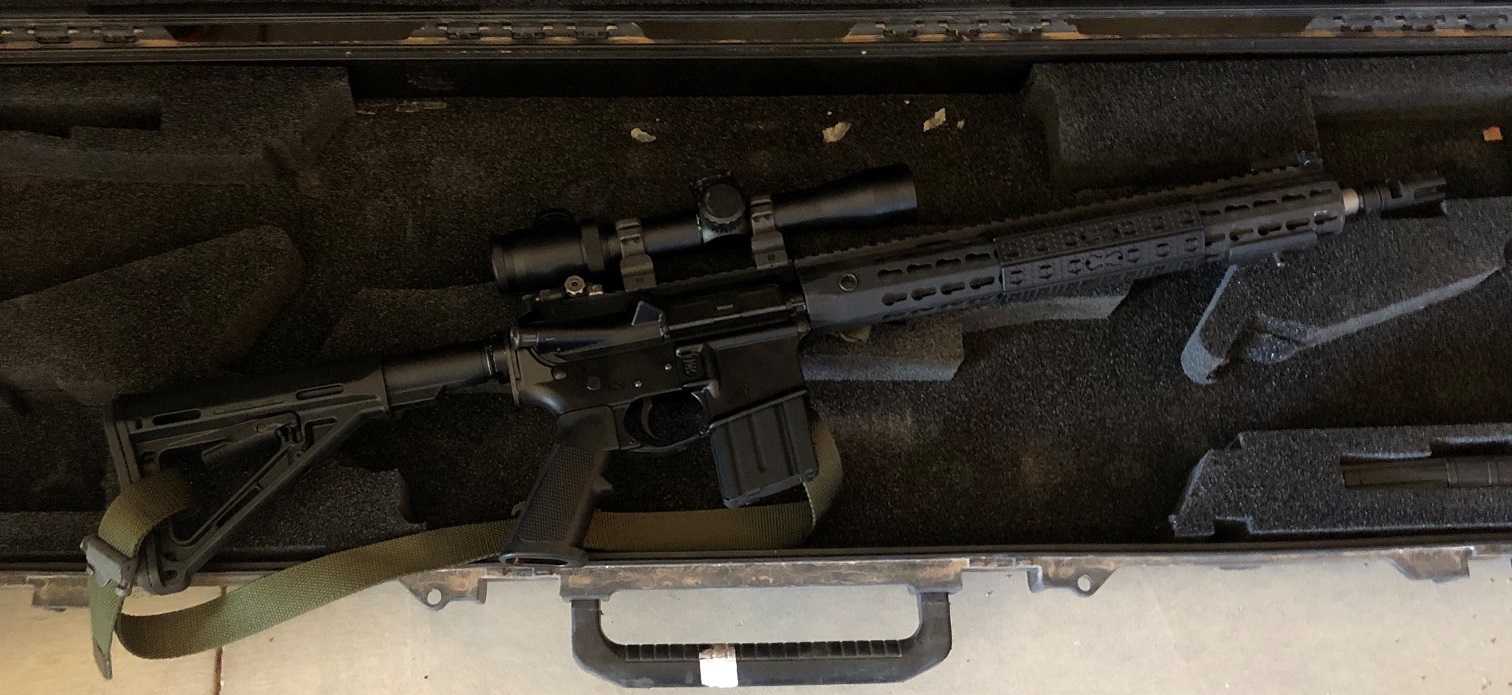

That and the huge rails that are popular, I feel kinda silly with this much unused real estate on mine. A 10-11" rail and a 13.7" barrel would make more sense imho:
If you shoot on/around/through barricades and such on the clock eventually a shorter handguard is gonna make you feel silly when the barrel contacts something.
