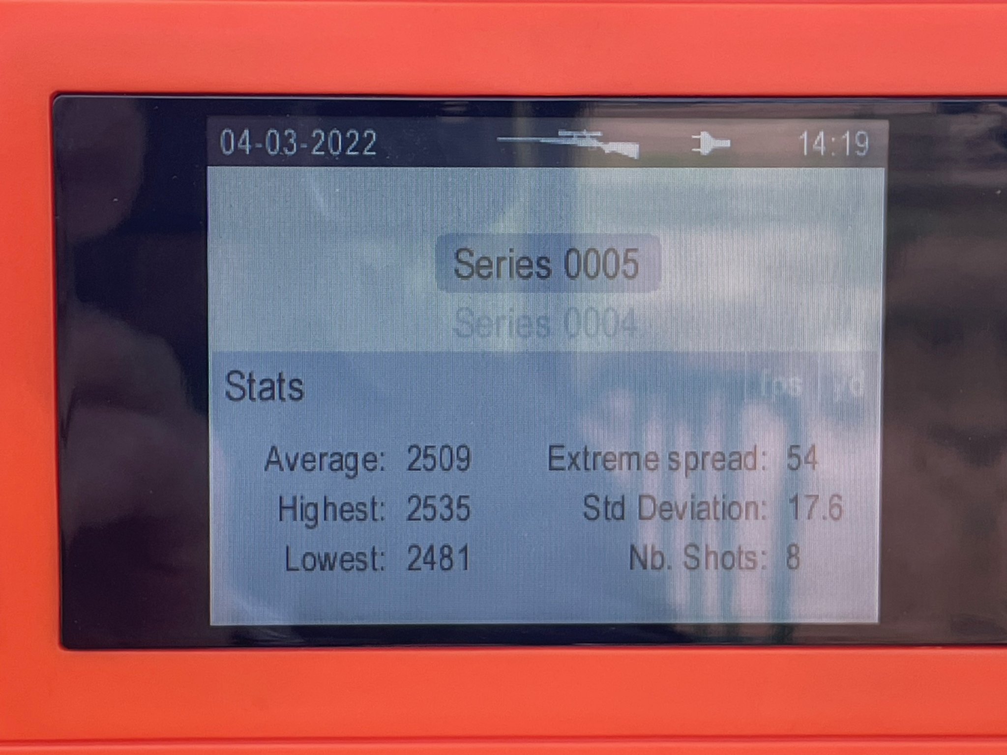

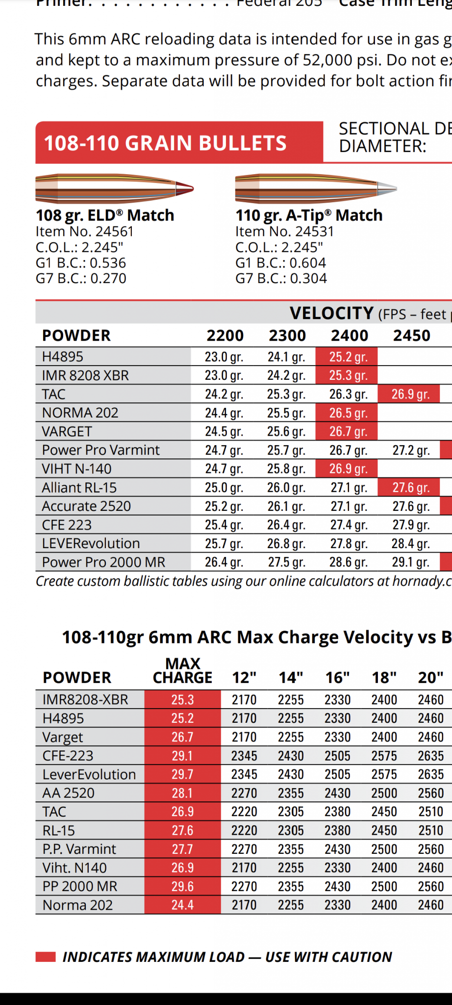

Looked it up cause I'm a dork-
105 is .530
108 is .536
110 is .604
So assuming 2500 fps for all three (which isn't true) and expansion velocity at a conservative 1900,105 is ~400 ish 108 is maybe another 10 yards and atips get you to 450.
But they'd probably open up well past that, so I think ND nailed it, if you wanna shoot an elk at 500 with a recce, you'll be set 🤣

Might bubba it up to 2500 or so but yea, nah
105 is .530
108 is .536
110 is .604

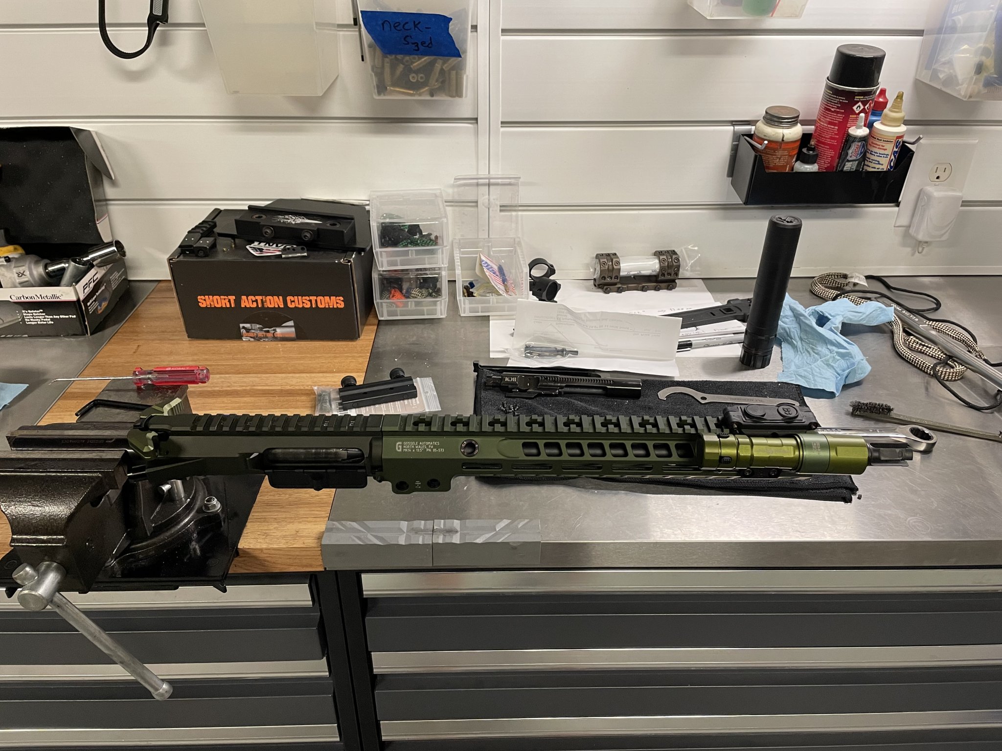

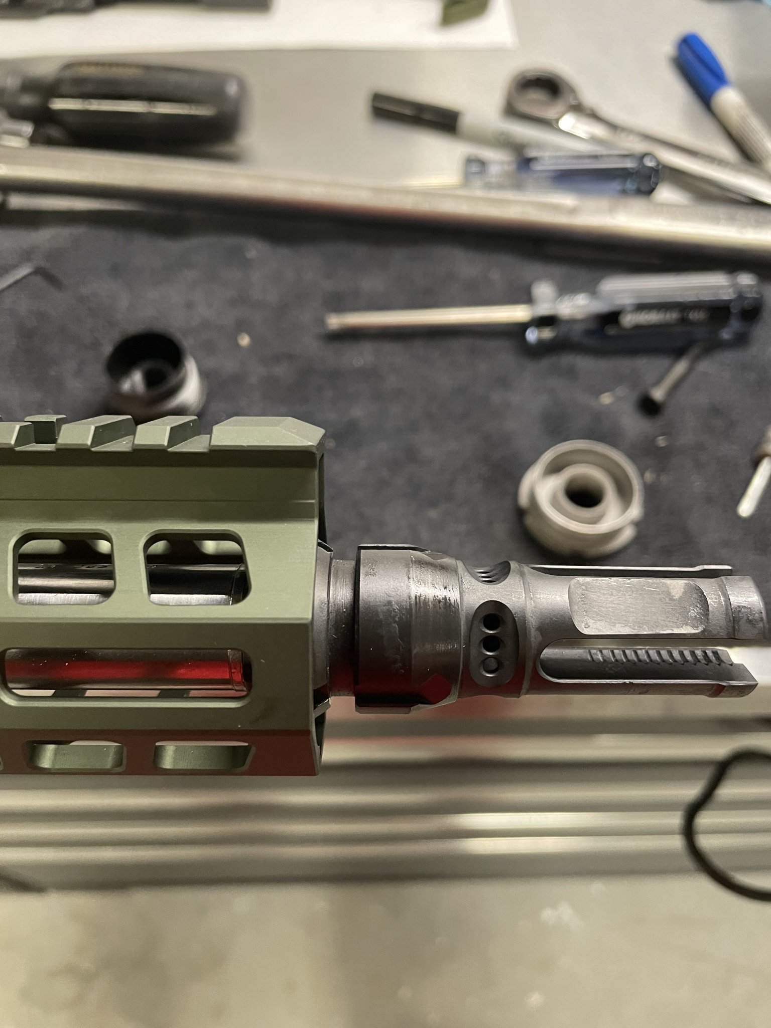

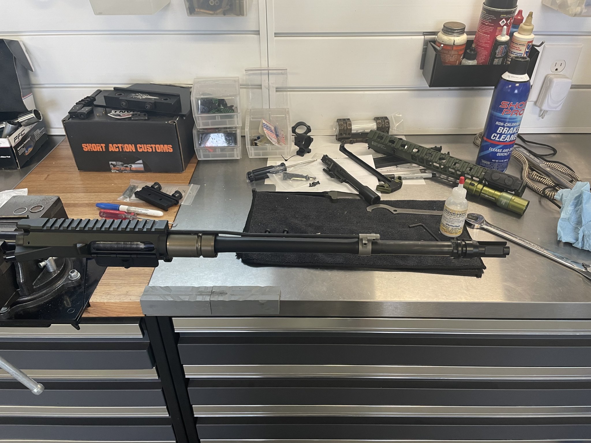

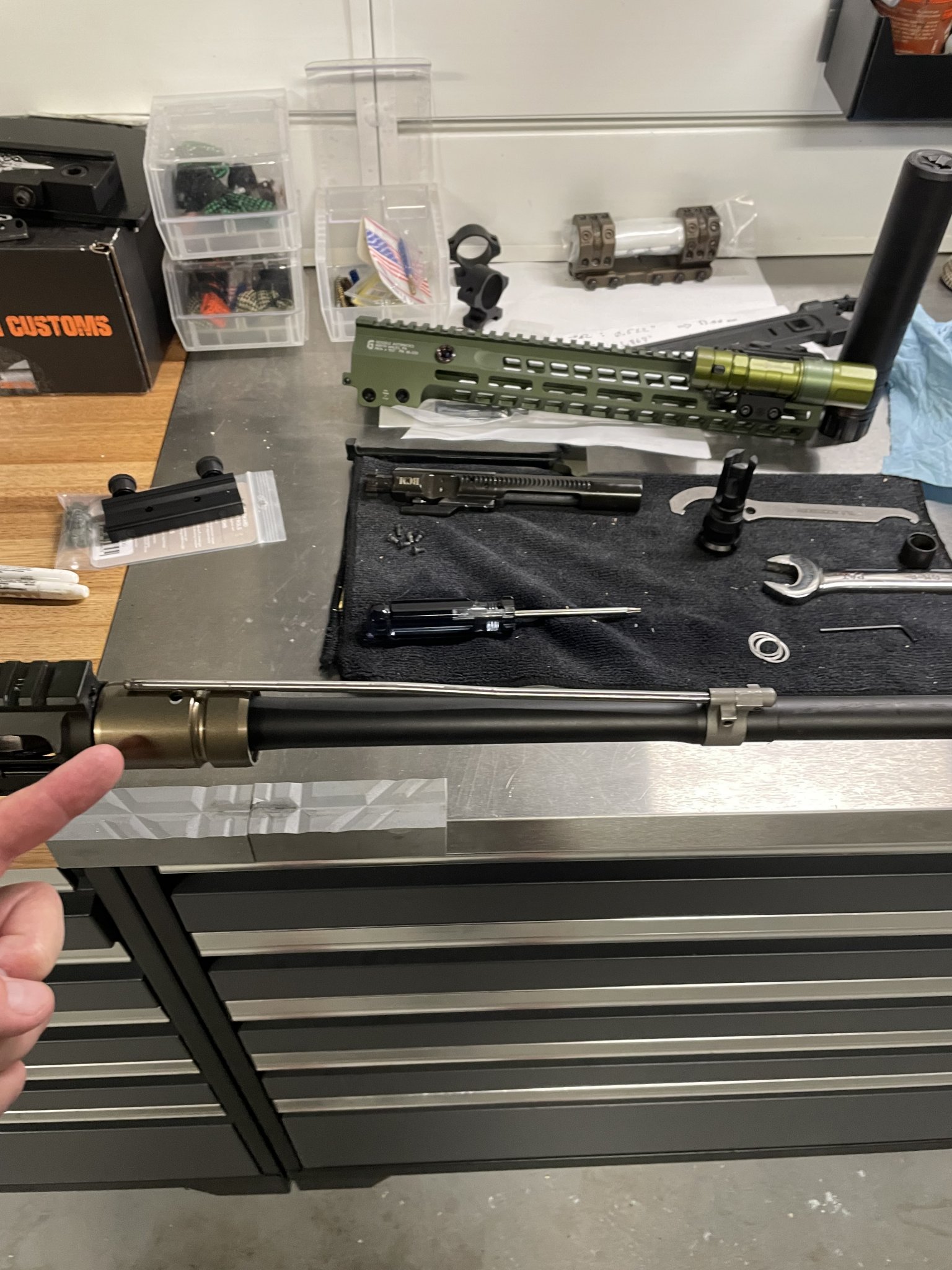

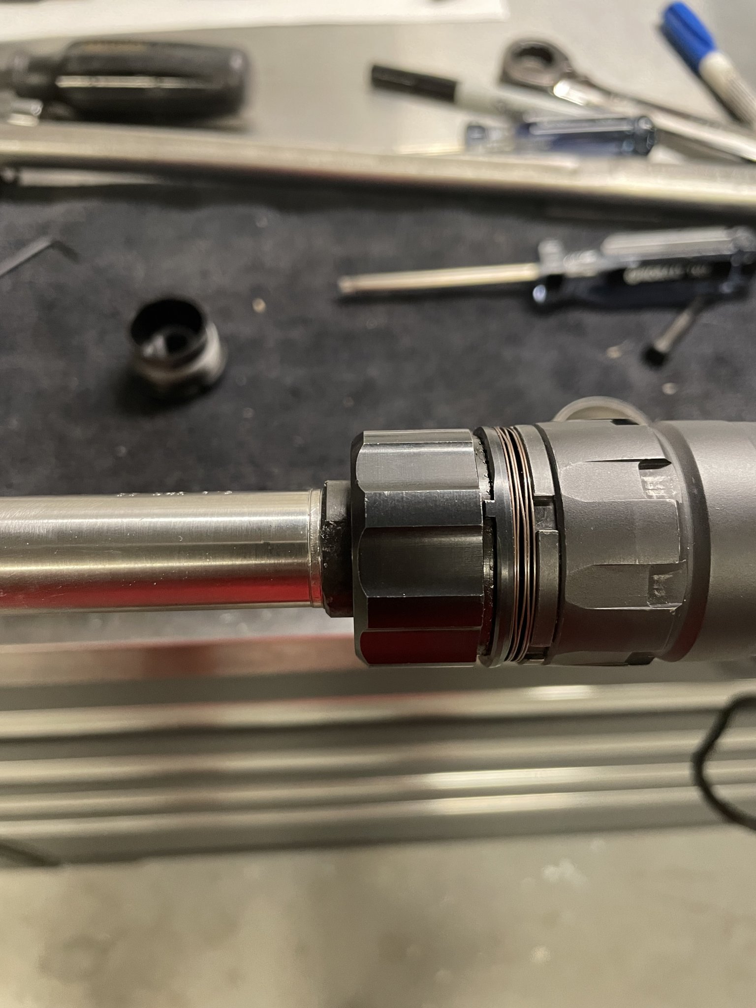

Bit of a thread necro, but after picking up a MAWL, I recently bought a 13.5” Geissele rail to get a bit more rail over my old 12” JP hand guard for my 13.9” 6.8SPC pig gun.
Only problem is that I didn’t account for the overlap of the muzzle device on the threads, and I’m short by 2-3mm to be able to fit any of my cans…and I only shoot suppressed these days; too many years flying jets, and I need to save what little hearing I have left.
The hand guard is too small to recess any of my 7.62 cans, I even tried direct thread mounts, so that’s not an option. I also have a 16” barrel in 6.8SPC as well, but already have a dedicated upper with an LPVO for that one. So the obvious answer of course is: Build another upper! LoL
I know the 6 ARC is the latest hotness, and I’m sure it works very well, but I’m too heavily invested in 6.8 to go in another direction for an intermediate caliber, and frankly, this round just flat works on pigs and coyotes. My favorite pig round by far…. Well, .308 works better, but the 6.8 is a lot easier for me to get follow-up shots on running sounders of hogs.
So, who still makes a good 14.5” barrel for 6.8SPC-II ? I’d prefer a lighter weight profile, and make this one a daytime brush gun; probably fitted with another red dot vs LPVO or scope.
I don’t need another 16”, but I guess I’d consider an 18”-20” barrel; again, in 6.8 though…would swap my current 16” barrel into this upper (along with the LPVO), and could put a longer barrel on that other one that has a 15” hand guard, and probably fit a mid-range scope for longer range work.
thanks in advance for any tips/pointers.

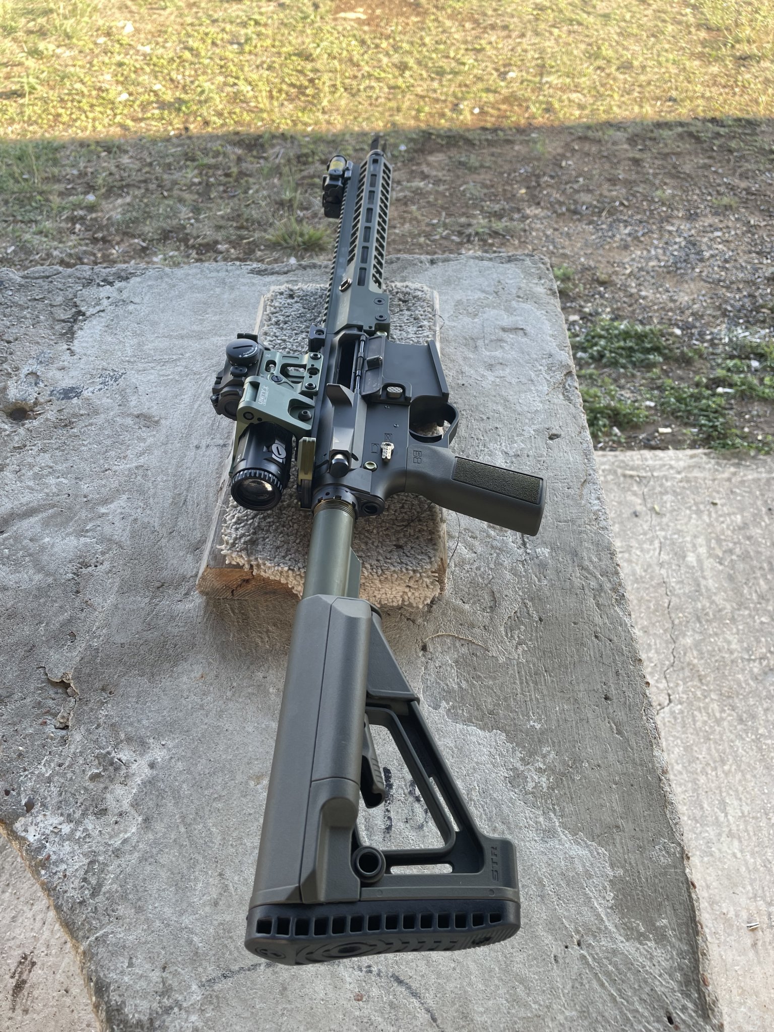

to go in this:
Now to decide on an optic…

I haven’t chrono’d the 110gr PPU factory load yet, but it’s flatter than I expected. I used 107gr SMK data in my program just to see what would happen, and it seemed to match up enough for me to see impacts then adjust with the 17.6” Lilja Grendel. I had to take a lot of drop off my turret compared to 123gr ELD-M. 123gr hits harder though and can be heard clearly impacting at distance, whereas the lighter weights sound just like a 6mm.
I loaded up a mag of 110gr PPU in the 12” Grendel and then connected 3/3 at 780yds, then 1st-round hit at 900yds on a reduced size plate.
107gr SMK is doing 2450fps from one of the 12” Grendels on top of 8208XBR without pushing it.

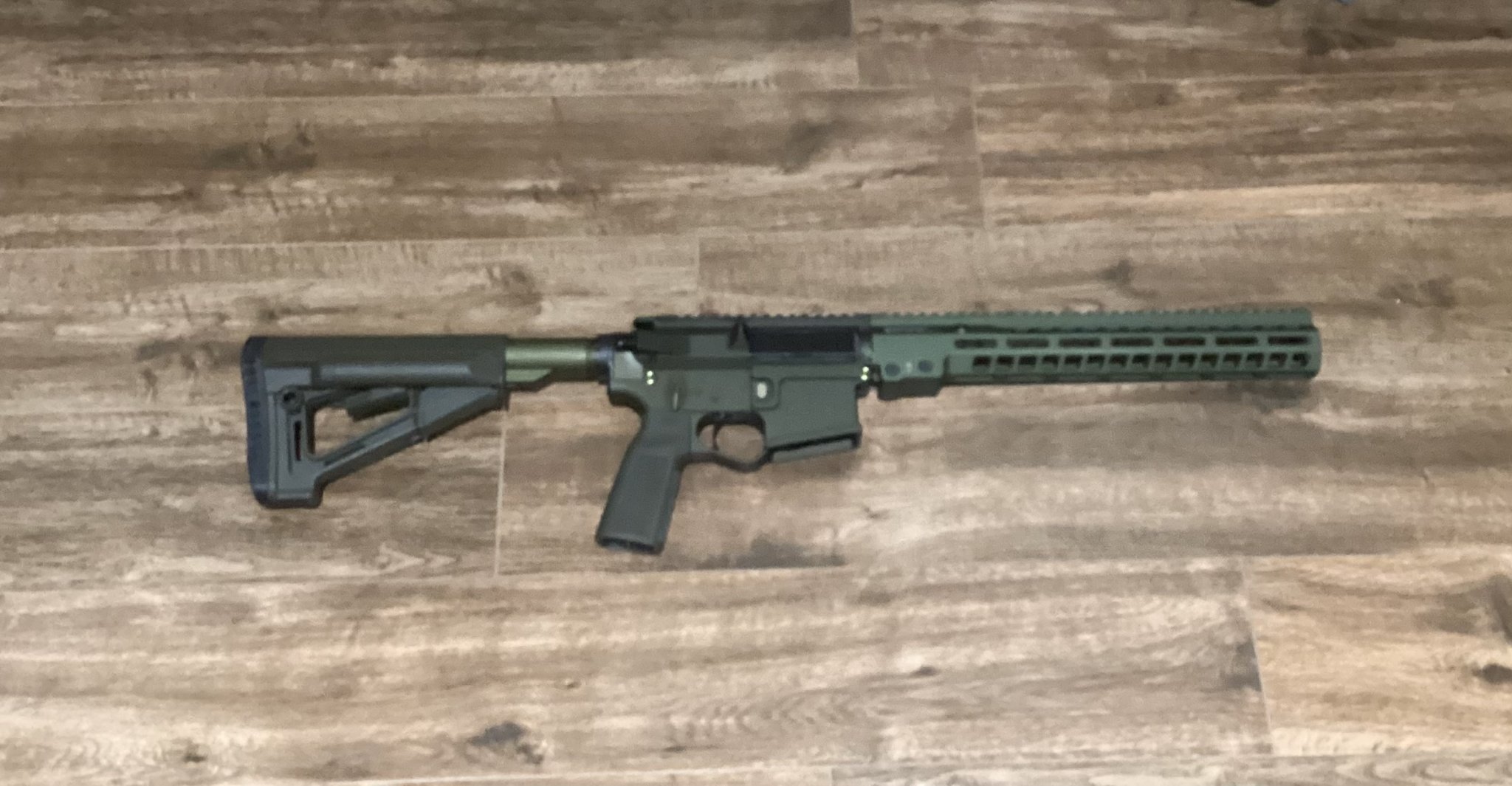

Update to the update, then I’ll stop highjacking this thread, LoL
Grabbed a gas tube:
And swapped the red dot from the 12.5” upper over to this one (have another one OTW that I’ll put back on the 12.5” upper) to get a “minute of deer” zero:

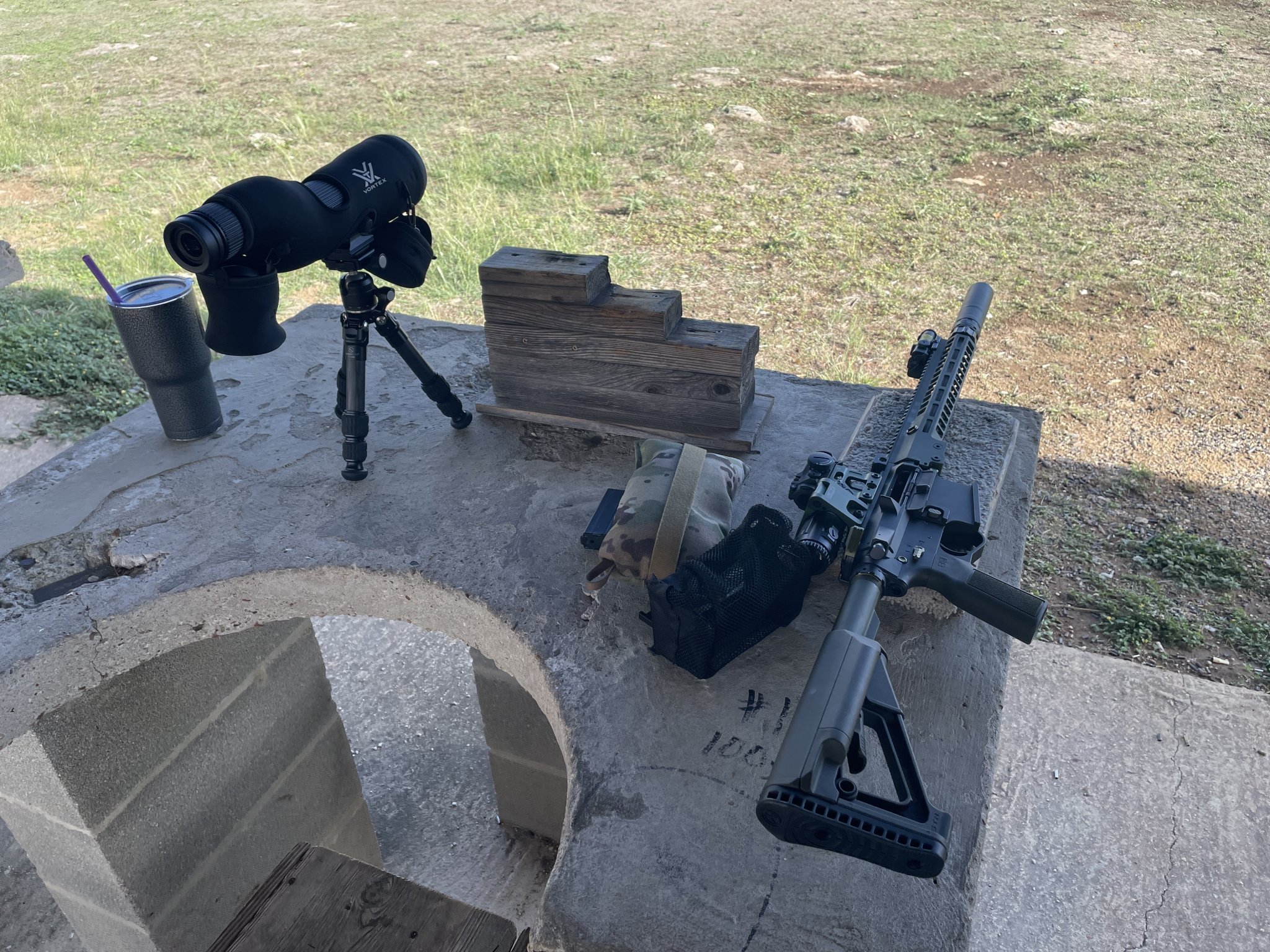

Took a few rounds on the target on the left (lane 17) to walk it in, then a couple 5-rd groups, plus a 10-rd mag dump on the top target on the right-hand target (lane 18), but close enough for today…will give it a good cleaning, and get a better zero with an actual rest and better squeeze bag next weekend.
Still diggin’ the 6.8 round 😎
Grabbed a gas tube:
Who‘s gas block?
Who‘s gas block?
Gotta say, I honestly don’t recall. Swapped it from the other upper… Sort of looks like the old Aero adjustable gas blocks, but don’t think that’s it. Maybe Battle Arms Development?
Honestly don’t recall where I got it, but since it’s not V7 or 2A Arms (my usual choice of GB), likely something on sale from Pri Arms or PSA a couple years ago.
