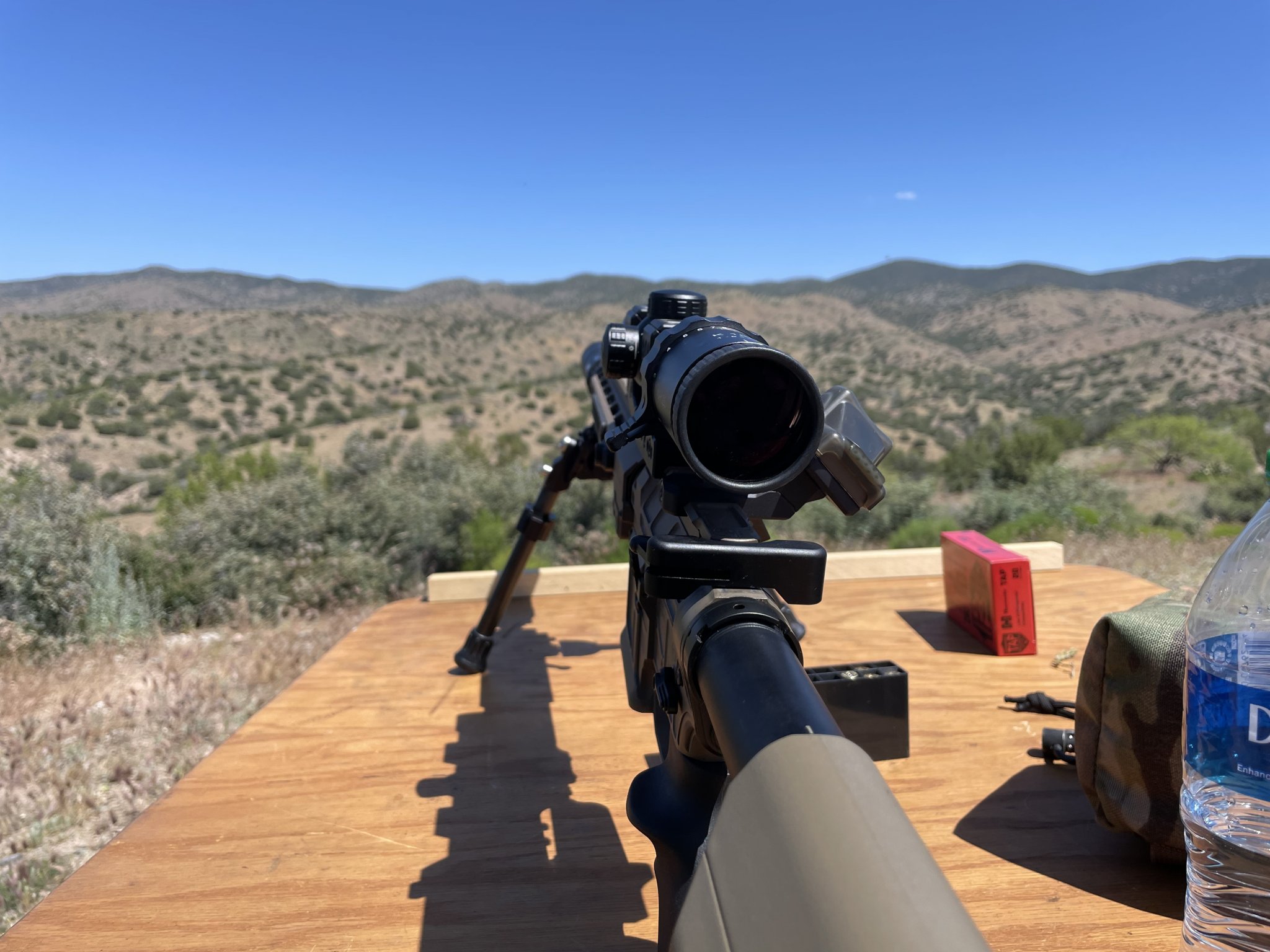

Someone else who chrono’d it said the SDs on the 100gr ELD-VT were crazy-tight as well.
I’ve only shot it out of the 17.6” Grendel with my kids on 2 occasions so far, and I have not been off-steel from 700-1000yds, on large gongs.
My 8yr-old was at least 4/5 or 5/6 at 1000yds with it on the big gong.
I noticed it pattern a really tight waterline at 1000yds in the wind. I was 10.8 mils at 1k at 6300ft elevation.
To me, it feels like shooting a 6mm AR but is a bit louder on the steel, maybe due to larger diameter and the tip causing rapid expansion.
If you already have a Grendel, 100gr ELD-VT is 6mm AR/ARC in a box for you. The factory load has been great, even if driven 140-160fps short of its potential.
