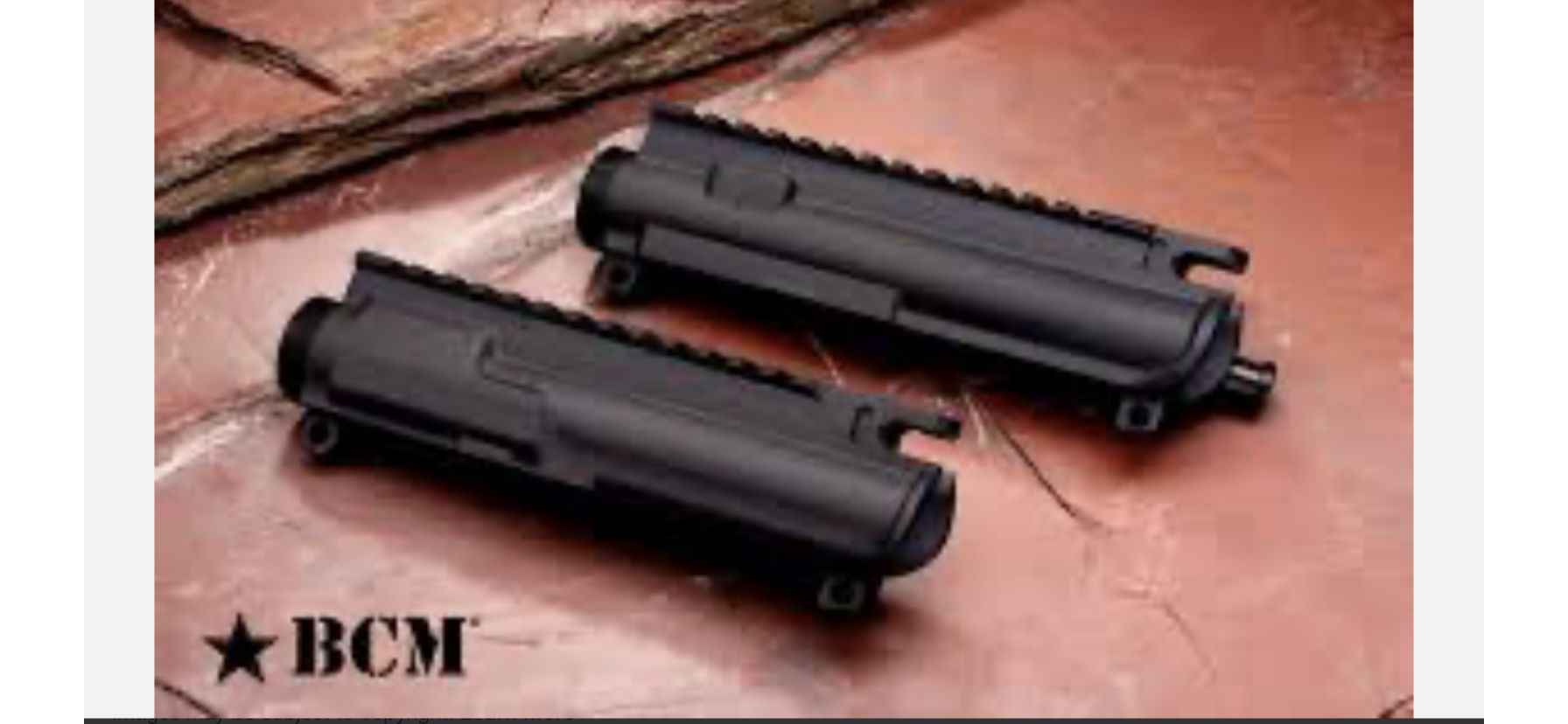

Here is the BCM side by side Mk2 vs mil spec. Some billet receivers JP and Iron City especially have an even more material the length of the upper. BCM made the MK2 as an improvement but with minimal extra weight. Thermal fit is a more solid design watch Joe Carlos explain the importance of fitment. Longer heavier barrels benefit from a stiffer receiver. How much exactly, I’ve never seen a test moving a barrel from receiver to receiver to see the difference. If you’re buying new you might as well get those features provided your not pack hunting with the gun. I used to be a regular bolt action accuracy guy and had Colt AR to blast with and shot some high power with open sights. Then I started working with some serious AR guys and shot a JP AR-10 .308 that will shoot right with all but the most accurate bolt guns. After shooting ragged hole after ragged hole with that JP I started building AR’s. Done right with careful attention to the parts the results are amazing.

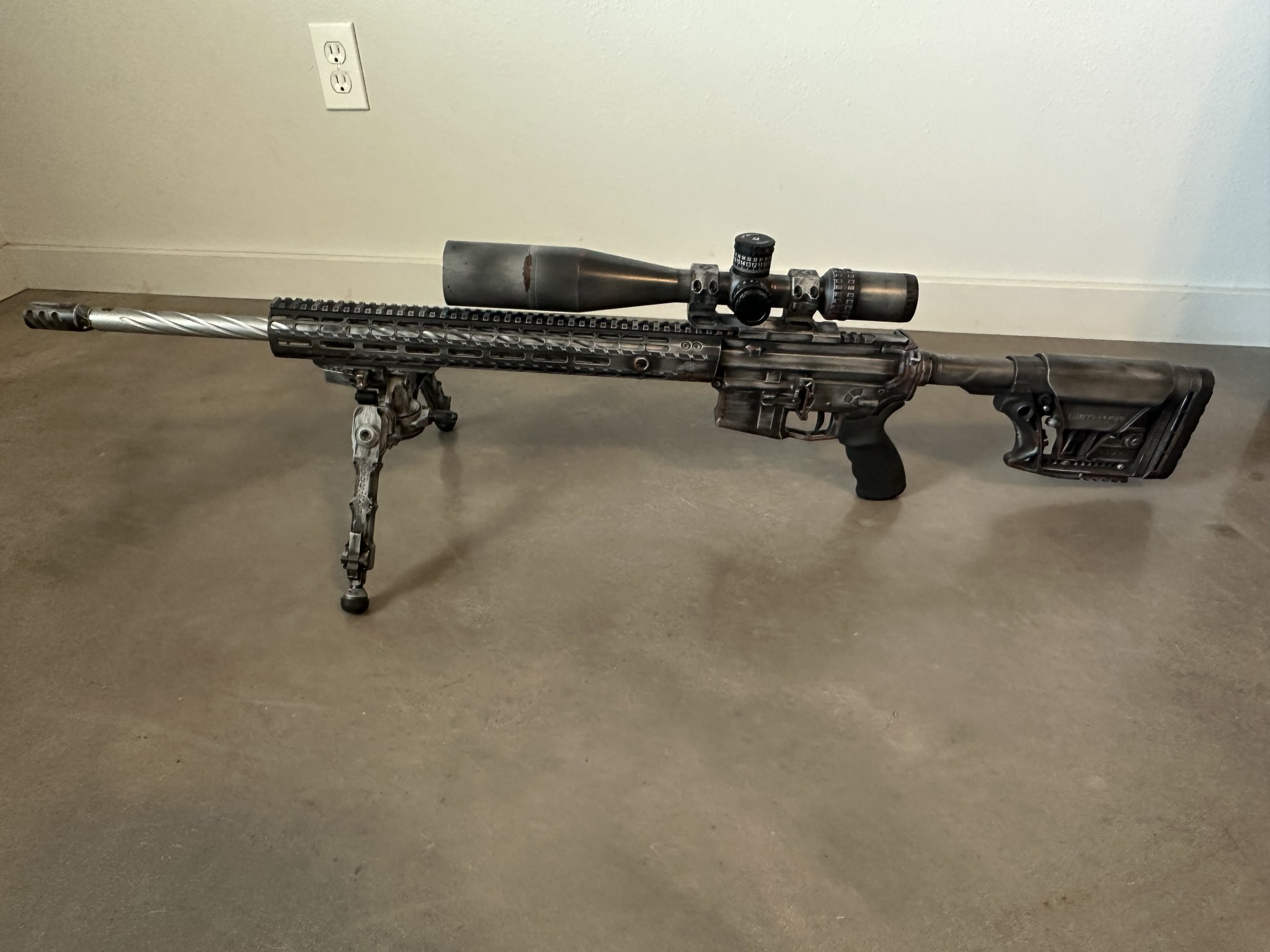

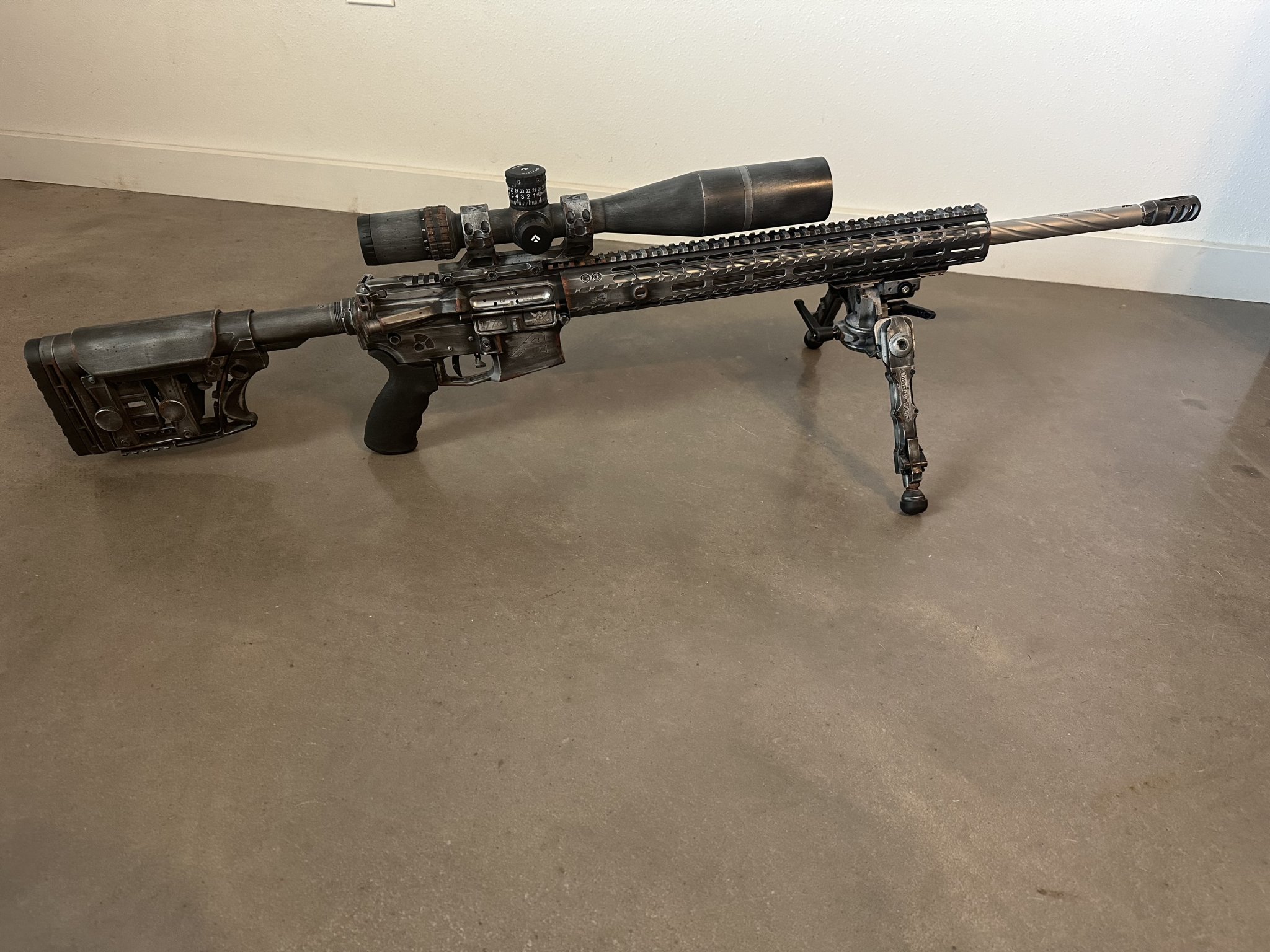

Well it only took a year but it’s complete. Front to back. Hart barrel, 24” 1-7 twist spiral fluted with RL+1 GS. Accu Tac bipod, Aero precision adj. gas block, advanced upper, lower and hand guard. JP LMBC, SCS and buffer tube. Rise Blitz defense trigger, rise upper and lower parts kits. Phase 5 extended bolt catch. Luth AR butt stock. Arken EPL-4 glass. Cerakote finish by Mycrow engraving and coating. All in all I’m pretty happy with the build. Down side is I had rotator cuff surgery before it was complete so haven’t shot it yet! Fingers crossed it performs as planned
