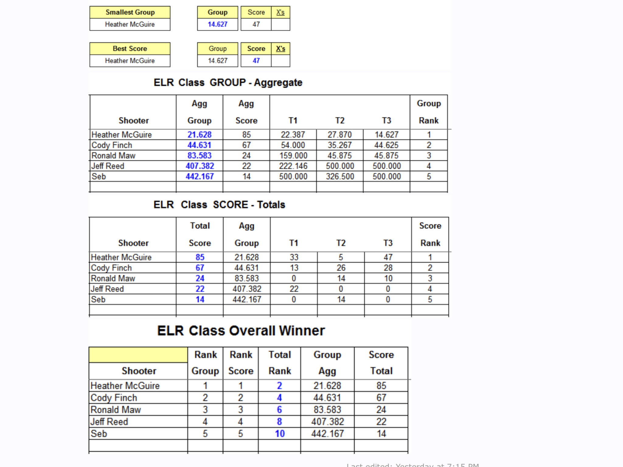

Congrats too Heather Mcguire on winning the first ever 2000 yard benchrest competition held in Townsend Montana over the weekend. Pictured here with her impressive 14.627" 5 shot group. Terrific shooting! Rifle is a .416 Reed built by Gunsmith Shawn Williams, Northridge Rifles. 36" Lilja barrel, Bat Action, Mcmillan stock, and Cutting Edge Bullets.

Edited To Add: Congratulations to all those that competed in the 2000 yard BR comp and thanks to Alex Wheeler for all his work it bringing that competition from thought to fruition.

Hopefully a fulsome match report to come?
This, gentlemen, is what the future of extreme long range shooting should look like; it combines accuracy with precision and produces measurable results.
