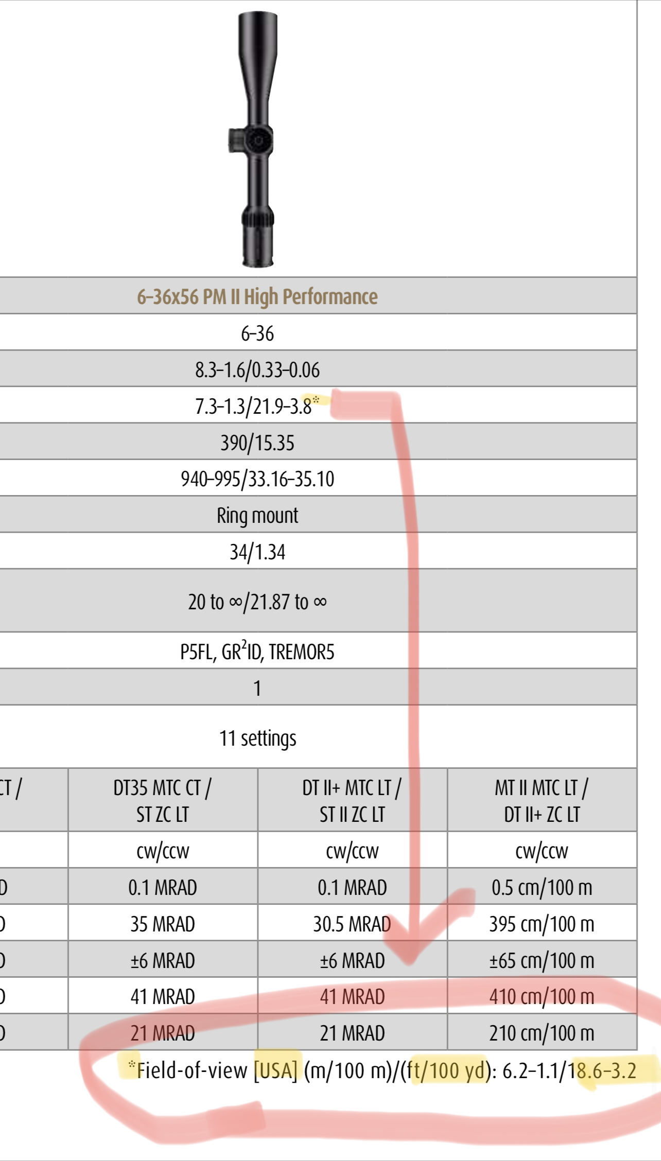

FOV spec-wise, the the USA 6-36 at 6x:
  • 18.6ft @100yds (euro = 21.9ft)
The ZCO 5-27 at 5x is at:
  • 21ft @100yds
@koshkin has mentioned ZCO states, ah, optimistic numbers for FOV.

Maybe I was reading the wrong thing but what I read was FOV was 7.3m @ 100m (24ft) and 21.9ft at 100 yards…I could have been reading the euro specs. But, when I had them side by side it seemed slightly better on the low end than my 5-27…take it with a grain of salt because I can’t directly confirm that anymore.
Reactions: carbonbased
Yeah, there’s this sneaky asterisk
Reactions: chase723
