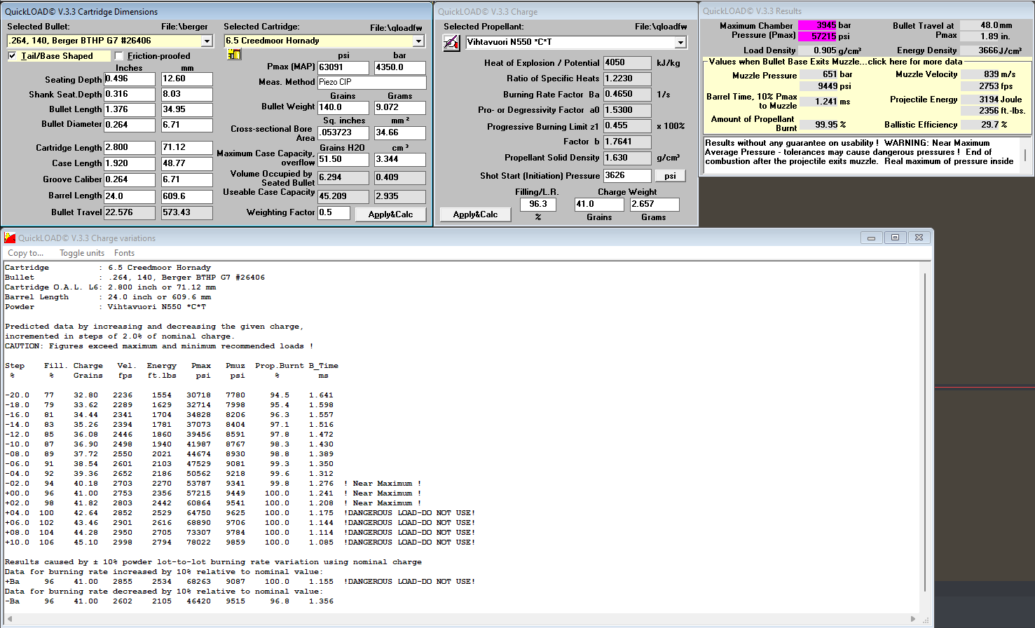

Exhausted the search for this exact load and found basically nothing. Reason I ask is I know the powder “works” but I’m just wondering if I can get some specific hands on experienced feedback from this combo. I have a lead on a good stash of this powder local, so I’m wondering if it’s worth my time to work with or is it a no starter from the get go. Just curious as I’m finding the usual go to powders very elusive locally.

Sure, I'm using 40.5gr of N550. My velocity is about 2730fps, and I've got a 22" barrel.

QL load says that you're going to get similar velocities with 6.5C in a 24" barrel using N550
