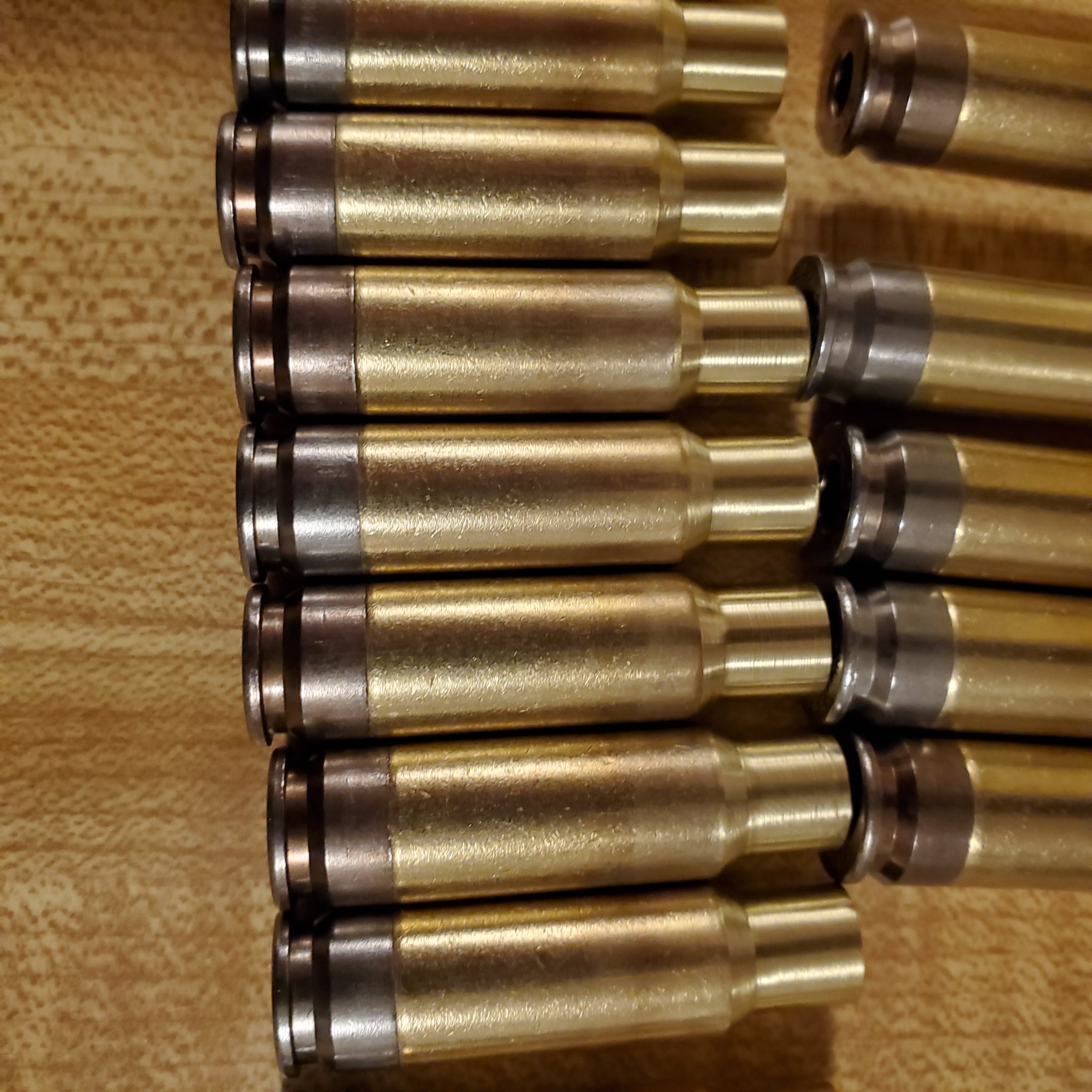

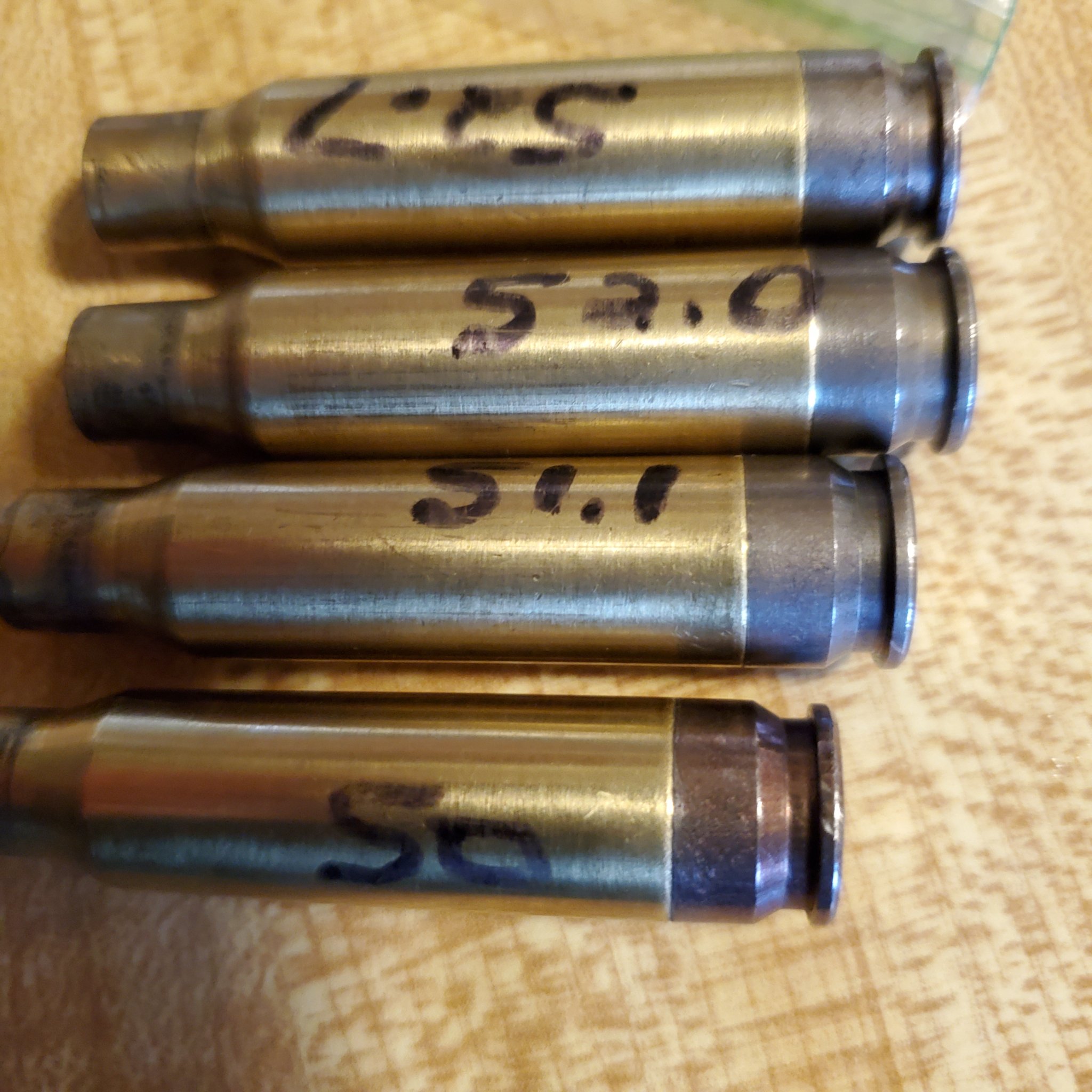

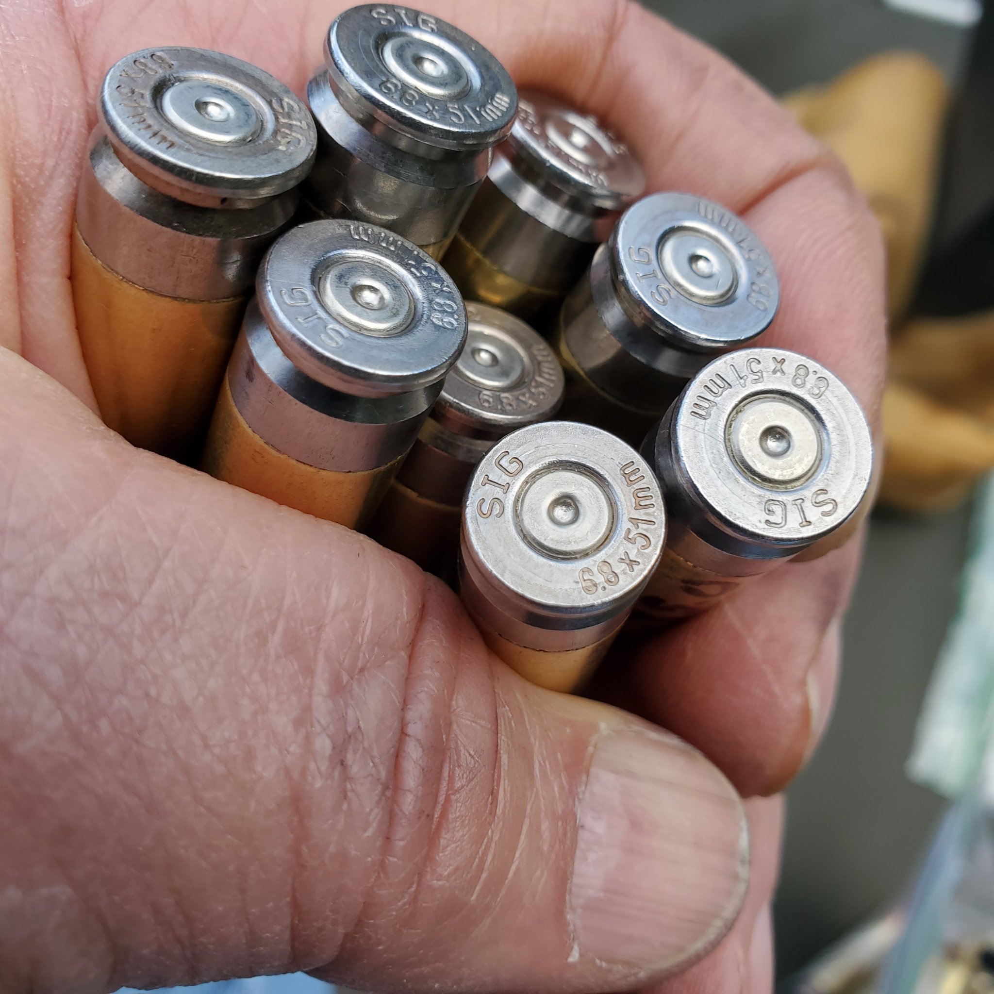

I have a couple thousand, and I purchased the last 300 available...for now.
I use them for 8.6 blackout, 6.5 CM, 308 Win, and 358 Win.
Here are some pics, and one string of 308 Win 200 gr SMK .715 BC at 2874 fps ave, probably out shoots your factory 6.5 CM, in every category, and they have been up to 2952 fps in the long barrel.
So that's why the cases are needed to bring my anemic 6.5 CM back in contention with the 308, using 150gr SMK or 153 Atip bullets.

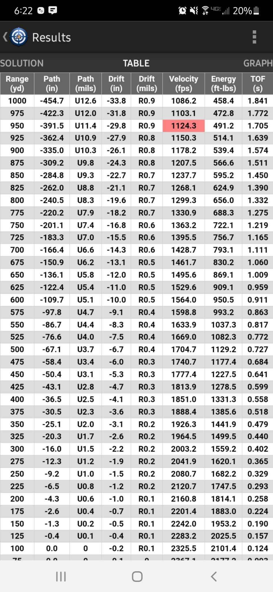

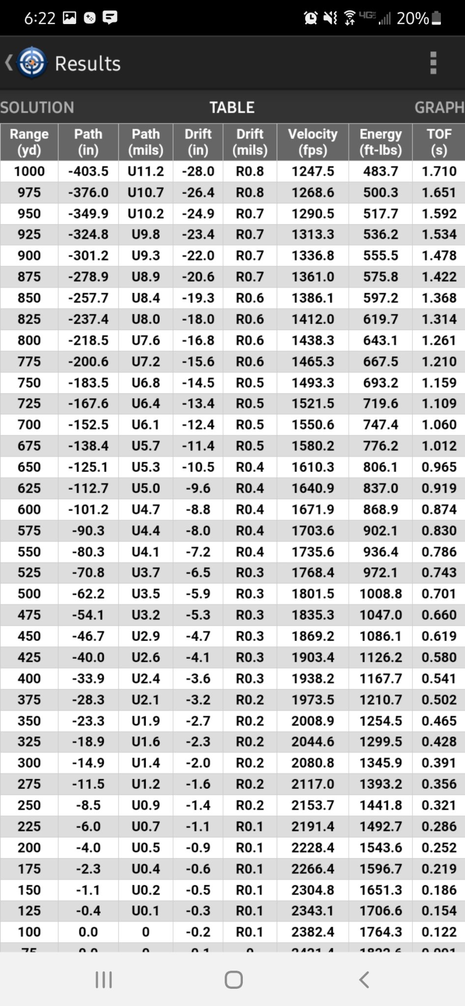

Here is a 16" 308 vs 16" 6.4crees. 308 running 175smk at 2497 and 6.5 running 140smk at 2542 . You can get a but better performance out of say a 169smk/178bthp/185jugg etc and a 142smk for the 6.5 but the 140/175 are in my opinion equally anemic in terms of bc for their calibers.
You can see the 308 doesn't even stay super to 1k. Only .1 mil different at 1k for a 3mph wind and a significant drop difference.
6.5creed
308 win

But at the 4200 altitude of much of the high desert the 16" 308 loaded with 208 eldm is good to 1500 yds, with Hornadys G7 and a muzzle velocity of 2442 fps...the ballistic numbers, it looks like this.
1000 yards
Drop Wind 1k yd velocity 1k energy
34.8 moa 60.7 in. 1489 fps. 1023 ft/ lbs
This is just mag length 208 eldm bullets in a light 6 lb 16" 308 AR 10.
More than enough energy for 500 yd elk, cause many will be at higher elevation, so the range could actually be extended.
It is, what it is... just change components or use the same old inferior components and same tired arguments...makes no difference to me. But facts still exist that you can greatly improve the 308 performance with modern components.

It would be cool if someone made a factory load with those hybrid cases for .308 that are gas gun port pressure friendly.
7mm SAW with that hybrid case would be a treat with 180s and above.
Absolutely. Even with the 162 eld-M, imagine getting 7 PRC speed out of a short action standard bolt face.
