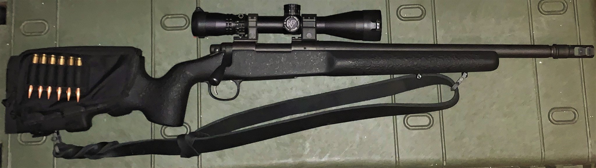

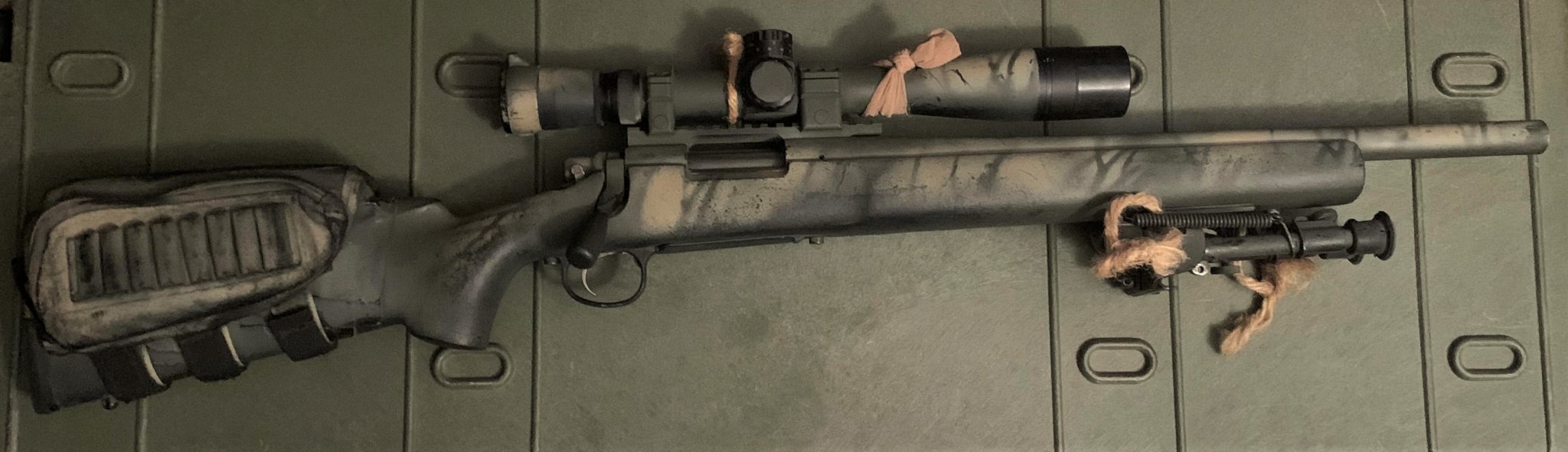

The Remington 700 AAC-SD's with the 16.5" barrels are awesome. I have had 2 in .308 (sold one) and they have been some of my all-time favorite rifles. I think it would serve your purpose of a farm truck gun perfectly.
You didn't really state a budget cap but yes, the factory stocks need to be replaced for tuck-ruggedness and more so, accuracy.
There are many HS Precision stock on eBay for short money +/- $300 or if you can spend a little more a basic non-adjustable A5 form the McMillan retail store which is the best bet.
Another suggestion is to get an R700P (Remington Police model) that will already be in an HS stock and consider cutting the barrel down to 18".
