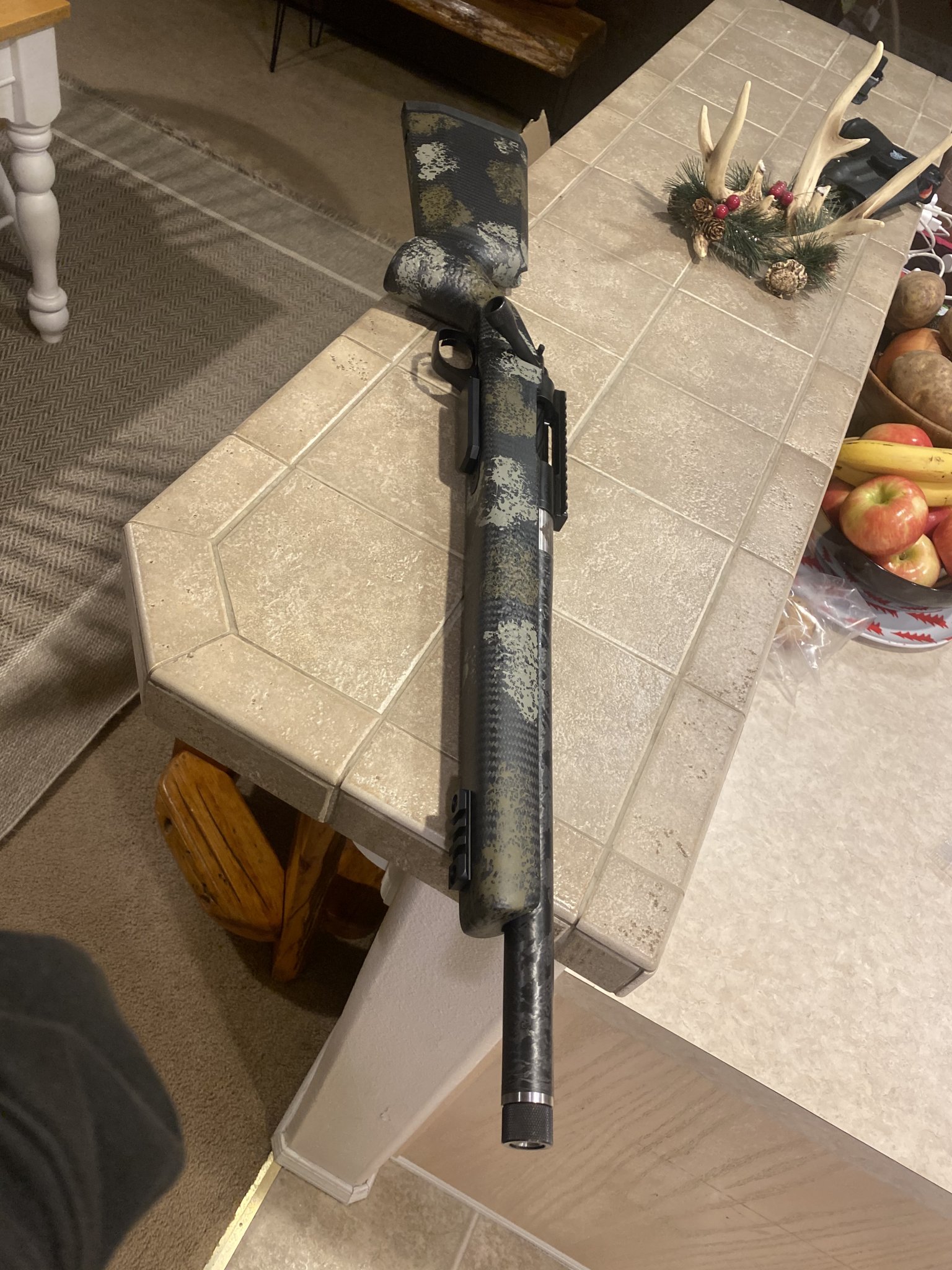

In case anyone was curious what this build was gonna look like together just got it back from @Deep South Tactical it’s stupid short but I’m excited to shoot it and start some load development next weekend
