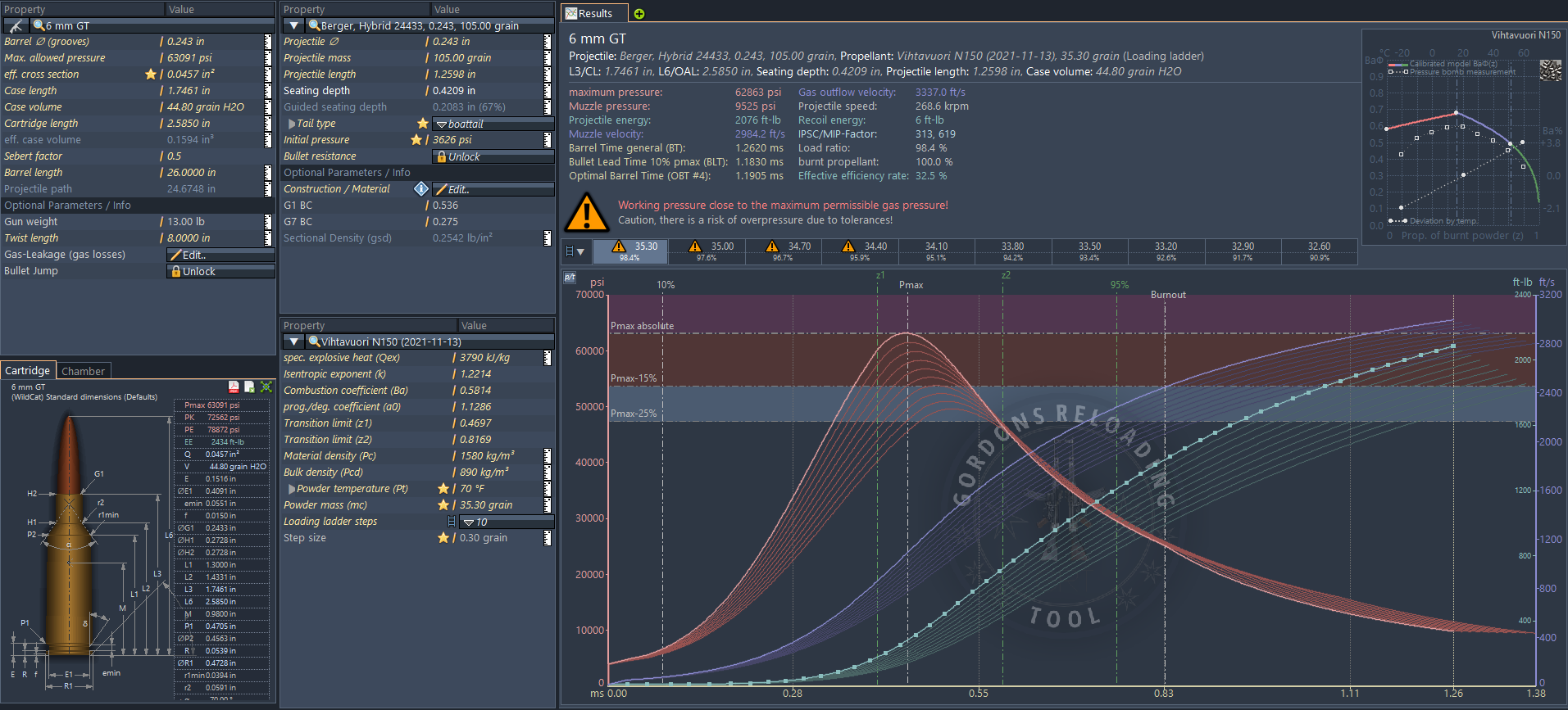

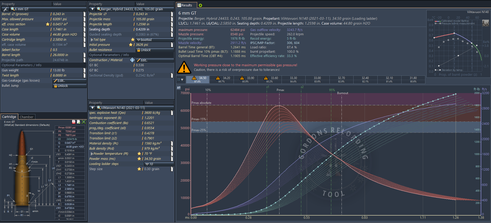

I've tried every which way to get GRT to run on my Mac with various programs, but no joy. Hopefully I'm asking the right questions giving the right inputs.
I plan on living with this cartridge for a while. I'm invested in it, have several more barrels and am not interested in making a change at least through '26. That said, I've tried both N140 and 150 and they both shoot. I'm purely curious what the modeling says is the better choice if I wanted to land on one. Aiming for 90% + fill (alpha and gap) and a 100% (or close to it) burn rate, around 2800 + - . I THINK it's going to be 150, but I'd love to see what the data says if anyone is so inclined. Sorry if I'm missing key inputs, as I haven't got to play around with it, e.g. water volume; I realize these are two different brass brands, but if you're only willing to run one, go with Alpha. Just a general idea from the model vs. real world experience with these powders.

Jump numbers are a little ambiguous. Without being in a very specific discussion with a standardized reamer, the way we communicate to internal ballistics codes is with COAL (overall length). This value affects the case fill value as well.
You will also need your internal case volume, but unless you are tuning a model with your specific velocity and such, it won't matter much because you will get a rough estimate.
Here is your basic run with your given input set at arbitrary length and for what it is worth. I put Varget in here as well. YMMV
N150 is the secret sweet spot for the 6GT in my opinion. I'd better get after it and buy another keg before it goes unobtanium.
Some barrels run Varget better, some do H4350 better (have one of those). N150 cuts the difference, and gives great velocity too.

Def appreciate everyone's replies and input. I actually have both and found a great node for both of them, but I wanted to land on one as an easy button so I don't need to think too much about it. Was hoping from an actual model that that would be informative and remove my own bias.
The node for the 150 is def lower MV, which was what I was after, so I'm thinking I'll stick with it. I'm almost at the end of life with my current barrel and have two more tee'd up, so I plan on running 6GT for a while, thus the purpose of the question around these powders. I very much hope VV won't be unobtainium! It performs awesome, low SD's and is considerably better price than Varget.
