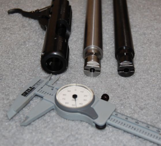

From my initial response:
The 17 hmr chamber is not cut to allow the bullet to engage the rifling.
The Lilja chamber diameter appears to be 0.245"...explains the wiggle I felt
when a round is dropped into the upended barrel, as a 17 hmr brass is 0.238".
The CZ 17 hmr chamber measured 0.247"...two thousandths larger.
I used a cheap plastic caliper to measure with.
That's why I said "It appears".
