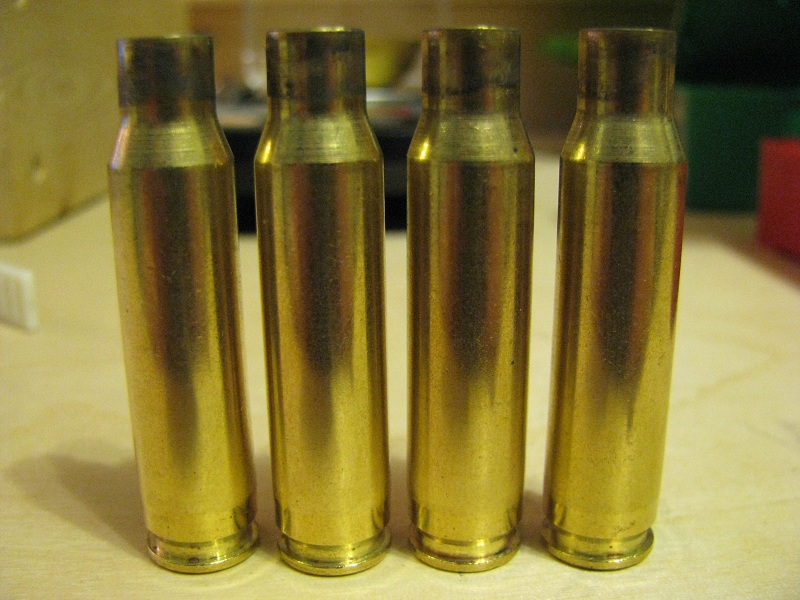

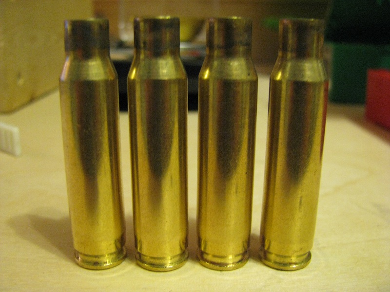

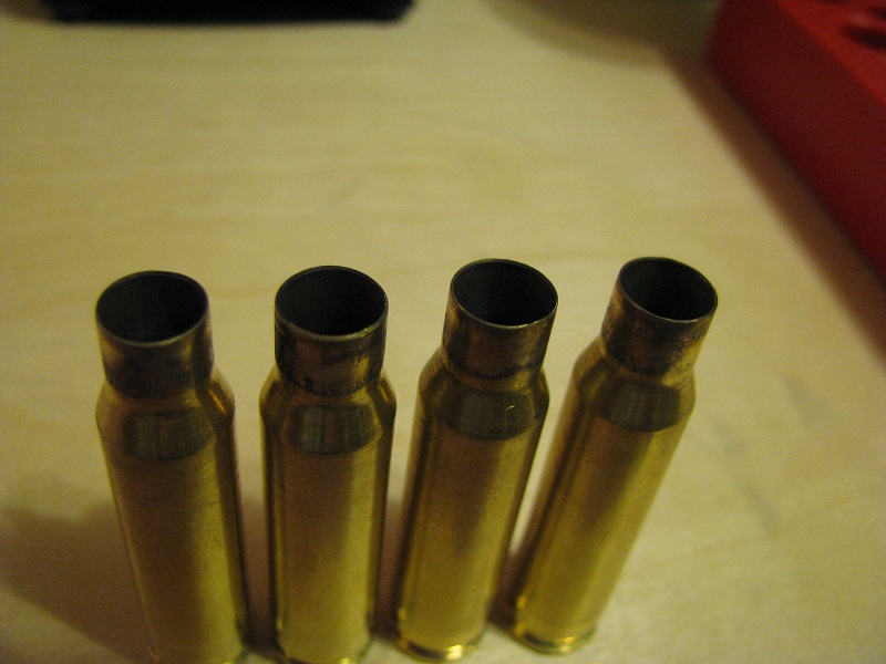

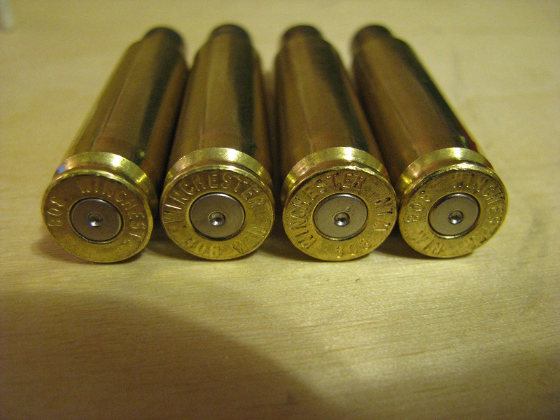

    Temps are pretty much room temp. Didn't shoot for groups yet. Just considering even TRYING 47, as I know its up there. Wanted a second opinion. (or third or fourth)
    I took the rounds, single loaded them, and opened my door and shoot them into my dirt pile. Just pressure testing. So temp is basically room temp. 70f. The powder/brass/barrel might be 60f at the lowest. (since the gun sits by an exterior wall)
    Here are the pics. Left to right: 44gr, 45, 46, 47gr.

    The pix aren't good enough to look for ejector pin marks, so have a look yourself. I gotta say I've never even heard of anyone shooting 47 grains of Varget with a 175SMK. Please take a "Before" picture of your rifle, just in case.
    Stay safe.

    I usually stop when I see ejector pin marks... but I don't have any here, even at 47gr. Which is why I was baffled.
    I loaded up 5 more at 47 and shot them just now. Still no signs of pressure. I've never seen this before in my life. I agree with what has been stated, and it is likely I won't end up at 47.

    I would be looking att he 44gr loads as you have a short barrel the pressure is only against the case for a shorter time but the peak pressure will still be very high it is interesting that at 44.5gr it was lower than at 44gr then at 45 gr it was the same again. That is a big tel tale sign that the pressures are starting to spike in your barrel. if the velocity drops with another half a grain stop there as the larger volume of powder is going slower and detonation comes close behind it dont go up to 46 at all you are in dangerous teritory after 45gr in your barrel the chrono is telling you something. So from YOUR results 44gr would be the place to start.
    Re: 175SMK + 47gr Varget?
    <div class="ubbcode-block"><div class="ubbcode-header">Originally Posted By: Wild_Bill</div><div class="ubbcode-body"> interesting that at 44.5gr it was lower than at 44gr then at 45 gr it was the same again. </div></div>
    Actually that is not correct. I put the wrong number in there for the average, I got those fields crossed up somehow. I did the math on the averages myself, and that one was off. The actual figures are as follows:
    44 Avg - 2514
    44.5 Avg - 2526
    45 Avg - 2563
    45.5 Avg - 2570
    46 Avg - 2624
    46.5 Avg - 2620
    It isn't until 46.5 that velocity starts to decrease. The 45.5 load showed single digit ES and was very accurate. No doubt that I'll want to wait for some hot days before settling on a load. Performing the diligence on each rifle sure does teach you a lot about the differences from one gun to the next... that is for certain.
