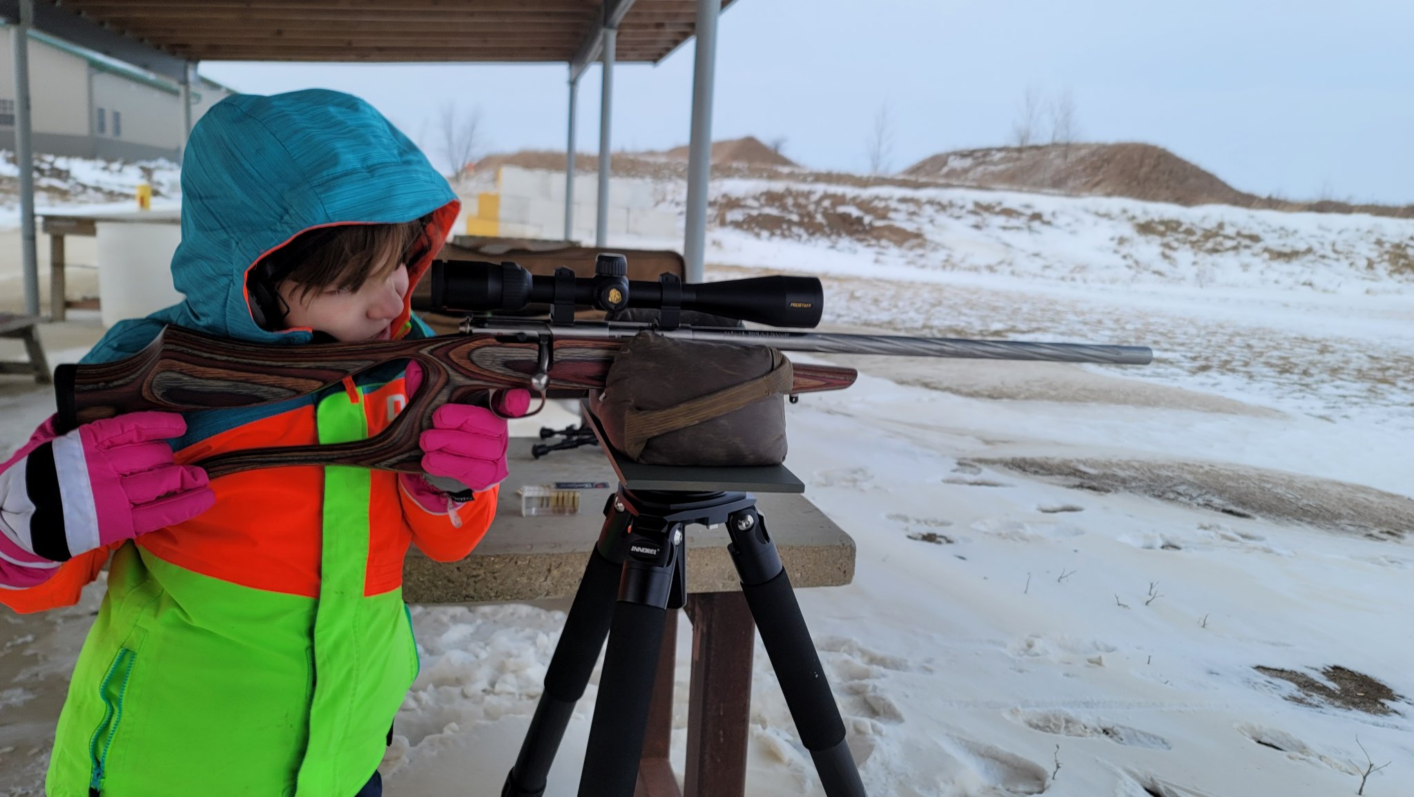

I have 2 girls 8 and 10 they are small. I want to upgrade them from a Henry kids 22 to 17hmr. So far I’m finding there are not many youth models. Want a bolt gun and threaded.
Am I stuck with getting a wood stock and cutting it? Can I purchase a rifle and get an aftermarket stock?
I need ideas and will take any recommendations. Not looking to go cheap cheap like a Rossi I’d say $1,300 if that will get what is needed on the gun itself.

My daughter (9) shoots savage bsev in 17hmr. She manages it. It sucks that we can't adjust the LOP - as it's her favorite rifle. We have couple chassis 22s we use for matches and she shoots those as well.
You'd figure manufacturers would be paying attention but not sure if they are

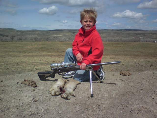

Here is what I did for my boys when they were small. Took a Savage 17 HMR and shortened the stock to about 12" LOP.
As they grew up, I bought another stock from Boyd's that was full length and fitted the action to it. My boys are now over 6' and shoot PRS. I am ready to move the 17 with both stocks and it is now threaded. PM me if interested in this kit?
