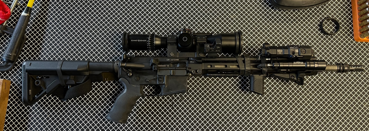

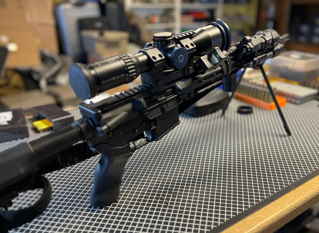

ATACR master race! J/K but really it's an awesome option for this niche of rifle.
There's a YT channel that had some great insights on SPR set up from Ridgeline Defense, one of them being optic selection and I agree with their assessment in that regard wholeheartedly. When you get out of a manicured range environment and/or away from a spotter, you're going to want more magnification.
I use a "mostly this, sometimes that" rule when doing set up and equipment selections, in this case meaning mostly I'm using this SPR for medium-long range and only sometimes for close range. So I have it set up with the 4-16 ATACR that I can use easily down on the lower mags and have it supplemented with offset iron sights for 50 and in basically.
There's a TY channel that had some great insights on SPR set up from Ridgeline Defense, one of them being optic selection and I agree with their assessment in that regard wholeheartedly. When you get out of a manicured range environment and/or away from a spotter, you're going to want more magnification.

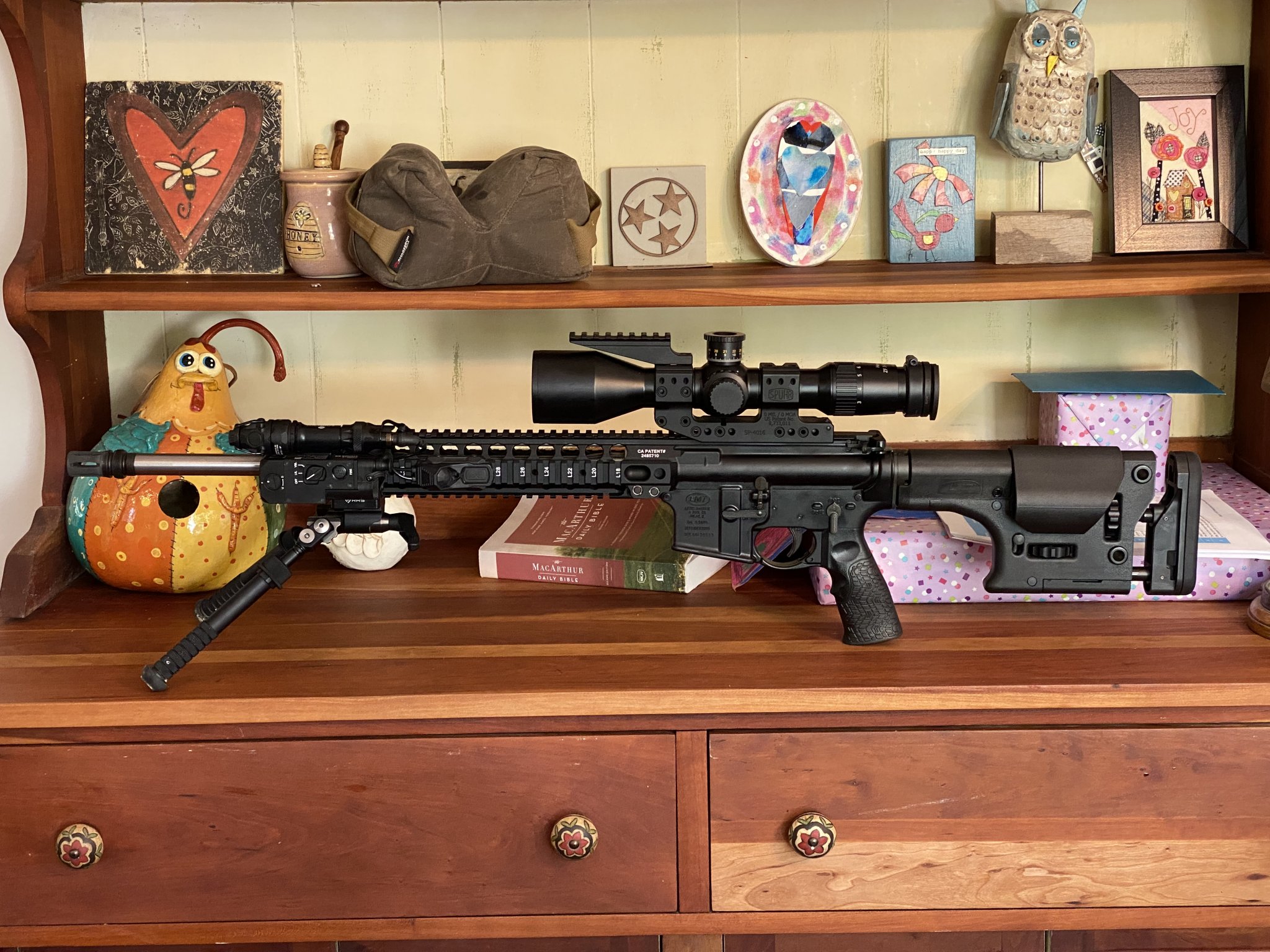

I did some really snobby shit with mine when I got a crazy deal on an S&B 5-20x Ultra Short.

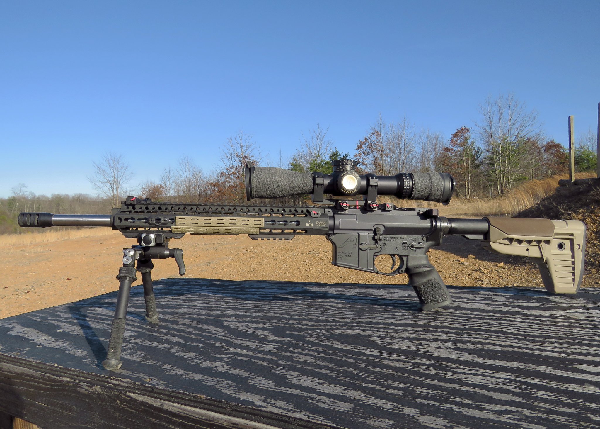

I originally embarked on this project by asking myself "Ok, so you've already got a Mk12 Mod 0 service rifle clone for nostalgia's sake, what would you build with today's components for that mission?" So I started with an LMT MLR 18" and used a Vortex 1-10x but found myself spending most of the time shooting with the magnification way up and wanting a bit more. I tried an NXS 3.5-15x I had laying around which was a bit of an improvement but much too large of a scope. That's also when I added the offset RDS, which confirmed that a midrange optic with RDS was the way to go. Then I got this crazy deal on an S&B 5-20x Ultra Short non-illum w/ H59 and it's turned out to be almost perfect (3-20x would be better but too long). This combined with the assaulter bipod really turned this rig into something I could almost do everything with and not be a big bulky annoying rig like the Mk12 Mod 0.
LMT 13.25in quad rail MRP with factory 18in SS barrel/BRT gas tube, 3-12x56 Hensoldt with mil-dot reticle, BE Meyers 3 degree Kiji with Steiner CQBL on Echo Arms mount, and LMT DMR stock. I really like the 3-12 range with a heavier mil-dot reticle for this type of setup. The visible laser could be used at close range outside daylight bright conditions. At night with NV the IR laser is stupid easy at 200 yards and reasonable getting hits at 300 yards on 1/3 IPSC.

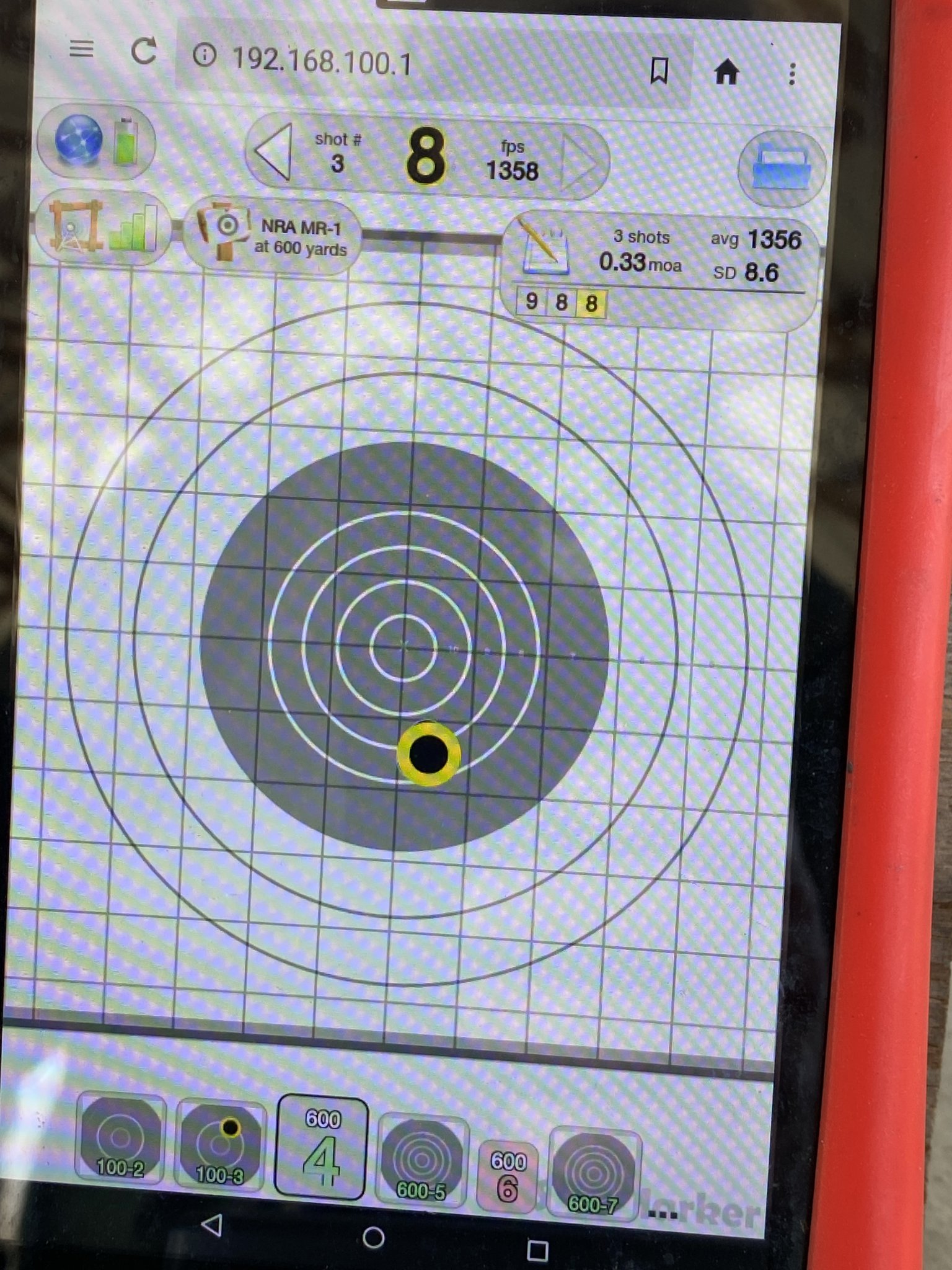

First three shot group at 600 yards with 53 Vmax/N133 load checking dope... I wish I could do that every time! The rifle is more capable than the shooter, I am not very good shooting semiautos but trying to get better.

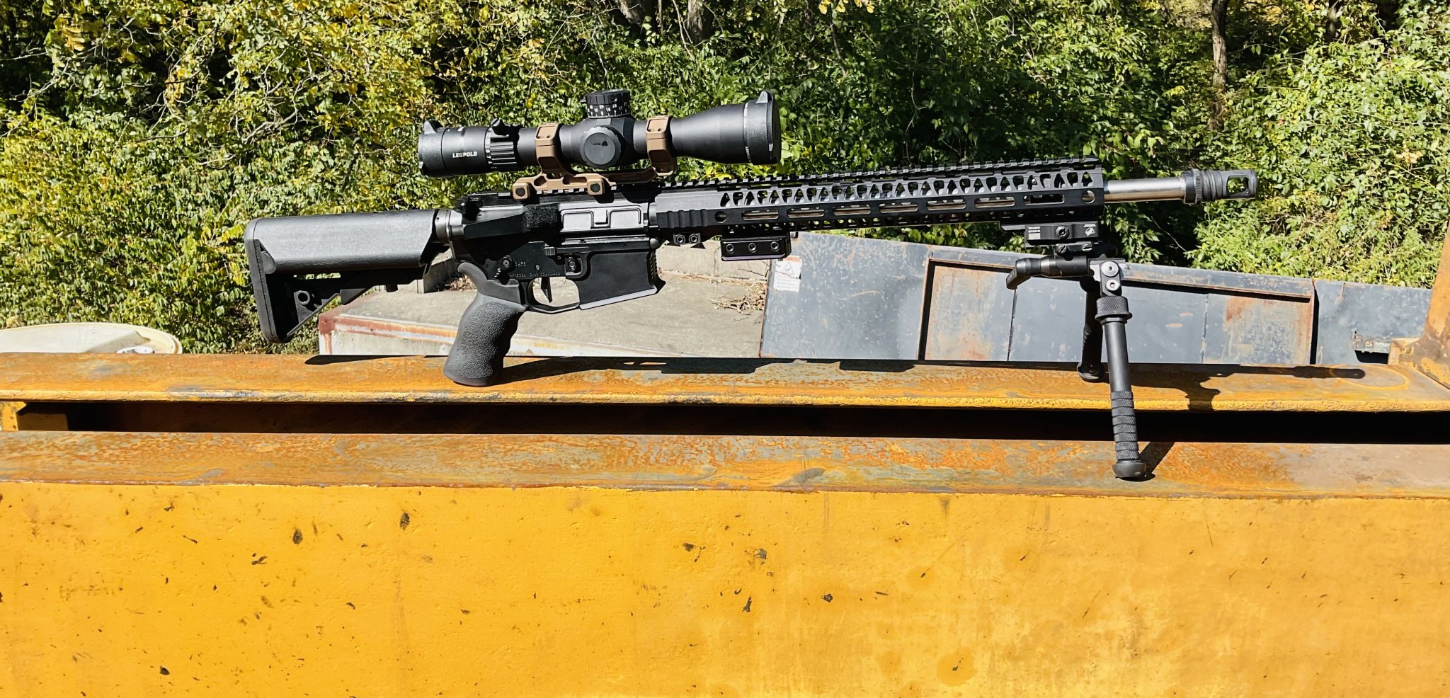

I’ve ran tons of scopes; 3-12 S&B, 3.6-18 mark 5, 3-18 XTR3, 2.5-20 NX8, 3-12 LRTS, 4.5-18 LRTS (LRHS too), 4-16 arken, 3-10 mark4.
Mark5 was my favorite. Until I got the XTR3. The price was a steal (especially what I pay). I didn’t feel it was giving up much except a few Once’s.
I have one 18” gun left in 556 with a 3-18. My 6arc 18” had a EP5 but I’m putting another XTR3 3-18 on it soon.
I have a 16” gun that is more precision oriented I will be trying the 2-12 Athlon. I have heard many good things about it. Look into that one too.
