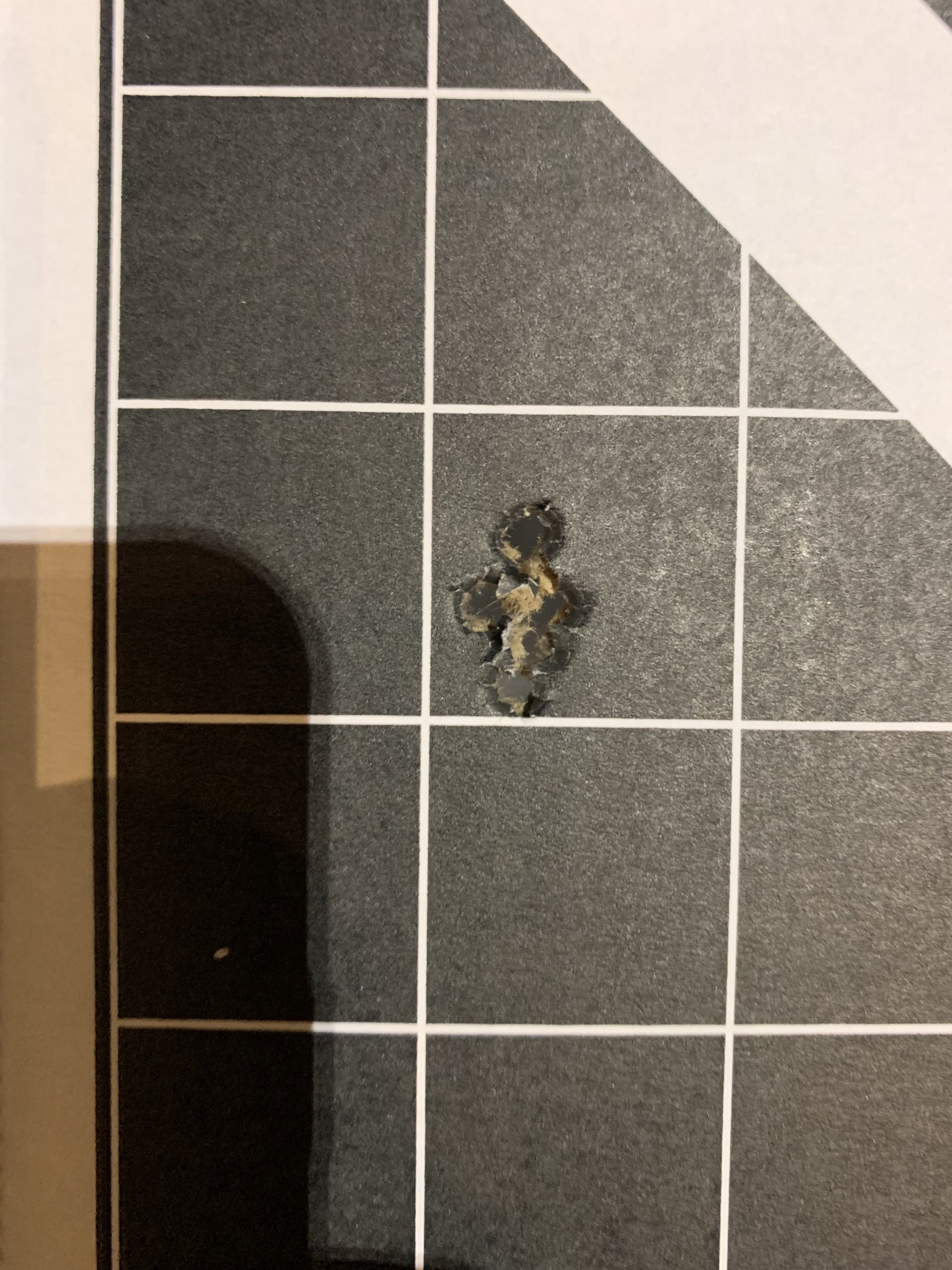

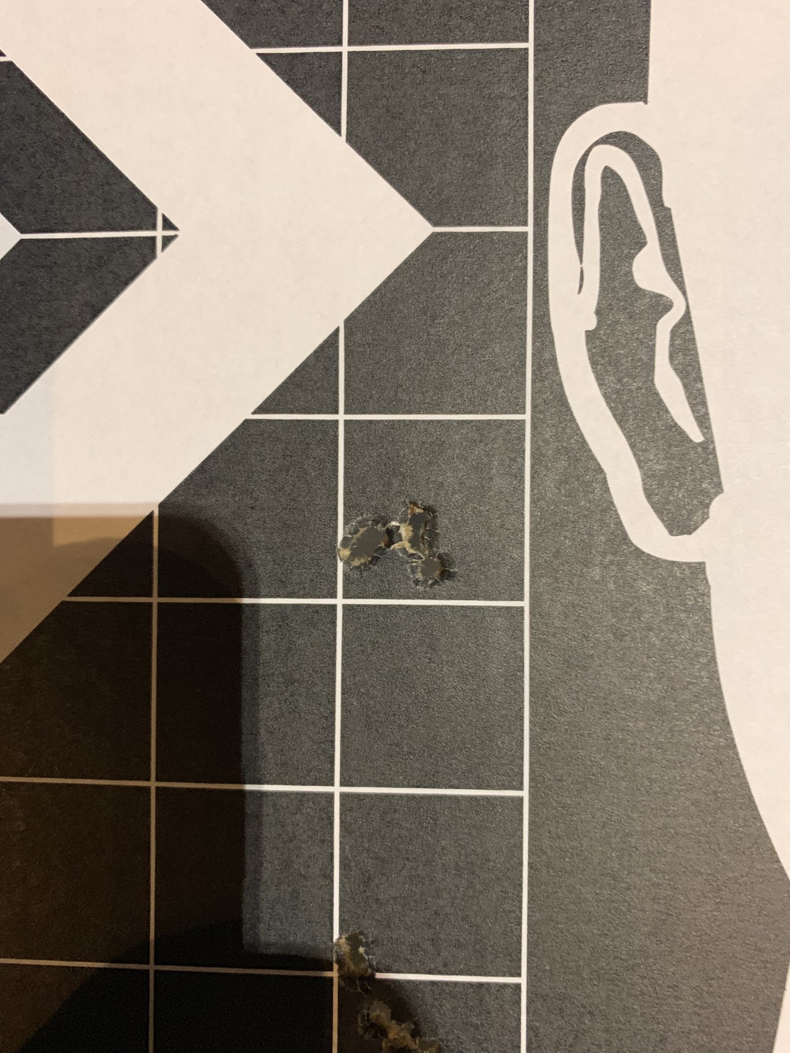

7034765
This is 6 rounds
7034764
5x5 groups shot with no cool down time between groups
18” ARP barrels. Shot prone off bipods with a rear bag.
Reactions: Potss and RTH1800

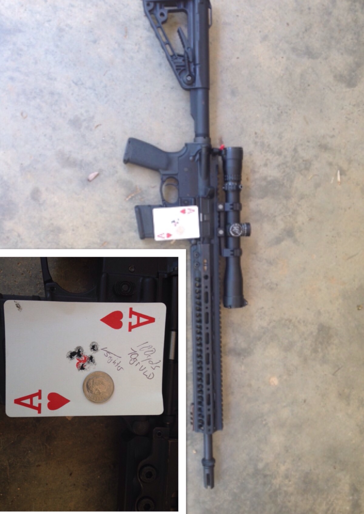

Believe it or not I have a Daniel Def. pro model that shoots right around 1/2 moa -3/4 moa at the most never over 1". I liked it so much I bought another one at a steal of a price on gunbrk. Even IMI 77 gr shoots 3/4 moa and never been over 1 moa. I think they are pretty solid uppers. I would agree that It is better to just get a top tier though then it takes the guess work out- meaning if it shoots like crap it is prob the shooter and.or ammo! Honestly there is not all that much difference in prices between let's say a Criterion and a Bartlein. Maybe 200$ but when you building an entire rifle with parts that total prob. 2k it seems to make sense to splurge the extra 200.
