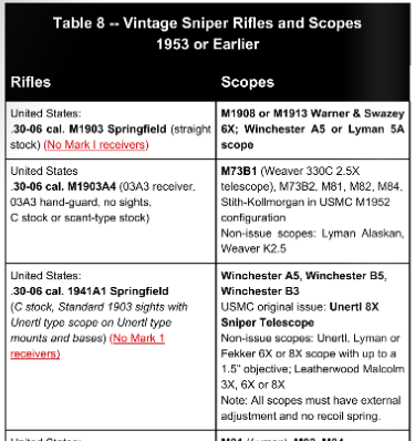

Out of curiosity, how exacting are the rules for the various Military Sniper Rifle Matches? Like rivet/stitch counting tight, or the 5’ rule? 5’ rule being extremely close: action, furniture, optic/sights be close but not exact.
I know the CMP requires the rifles to have a C (pistol) grip stock. Instead of the S (straight) grip stock.
Which is absolute crap as the Marines used both styles. This is one of my pet peeves and has been for over 10 years. lol
Otherwise I think the CMP rules are pretty standard. Basically just a standard 03 with blocks and a scope. There are rules on the scopes but most people use the Malcomb repo scopes anyways.
Scant stocks are verboten?
The way I read the rule book, you can use a Scant on a 03a4. But you cannot use one on a M1903A1 Unertl.
This is one of my biggest pet peeves so let me rant a little bit. lol About 1/4 of all the original M1903A1 Unertl Snipers I know of were found with straight stocks. We have pics of them in combat in WWII with straight stocks. Heck, I have a Unertl Sniper with a straight stock that has all the Marine rifle team mods. So it's an original stock to a M1903A1 Sniper. So I think this is why this rule is such a pet peeve of mine. I cannot use my "Real" rifle in a match unless I would change the stock. Also my rifle is probably one of the most well known ones out there.
But I guess what should I expect, the CMP calls them the 1941A1 Springfield. This says a lot about their knowledge of the weapon. The Marines never used the 1941 Sniper name, let alone the 1941A1 name. All of those are names were created by collectors or some author. So if they don't even know what the rifle was called, I guess I can't expect them to know about the stocks.
I've never seen the 1941 name used by the Marines. It seems we as collectors have created that name for these rifles. Pretty much the Marines just nicknamed them a 1903 Sniper, or 1903 with telescopic sight. Which meant they often confused them with the other 1903 Sniper variants the Marines were using during WWII.
The Marines didn't start building these rifles till Jan 1943, and they didn't plan on using the M1903's till around the summer of 1942. So the 1941 name really doesn't fit the dates they were created or made. All I can think of that would be associated around 1941 would be there was a sniper rifle trial by LLoyd and VanOrden but that chose a Winchester Model 70 with 8X Unertl. Which never happened.
