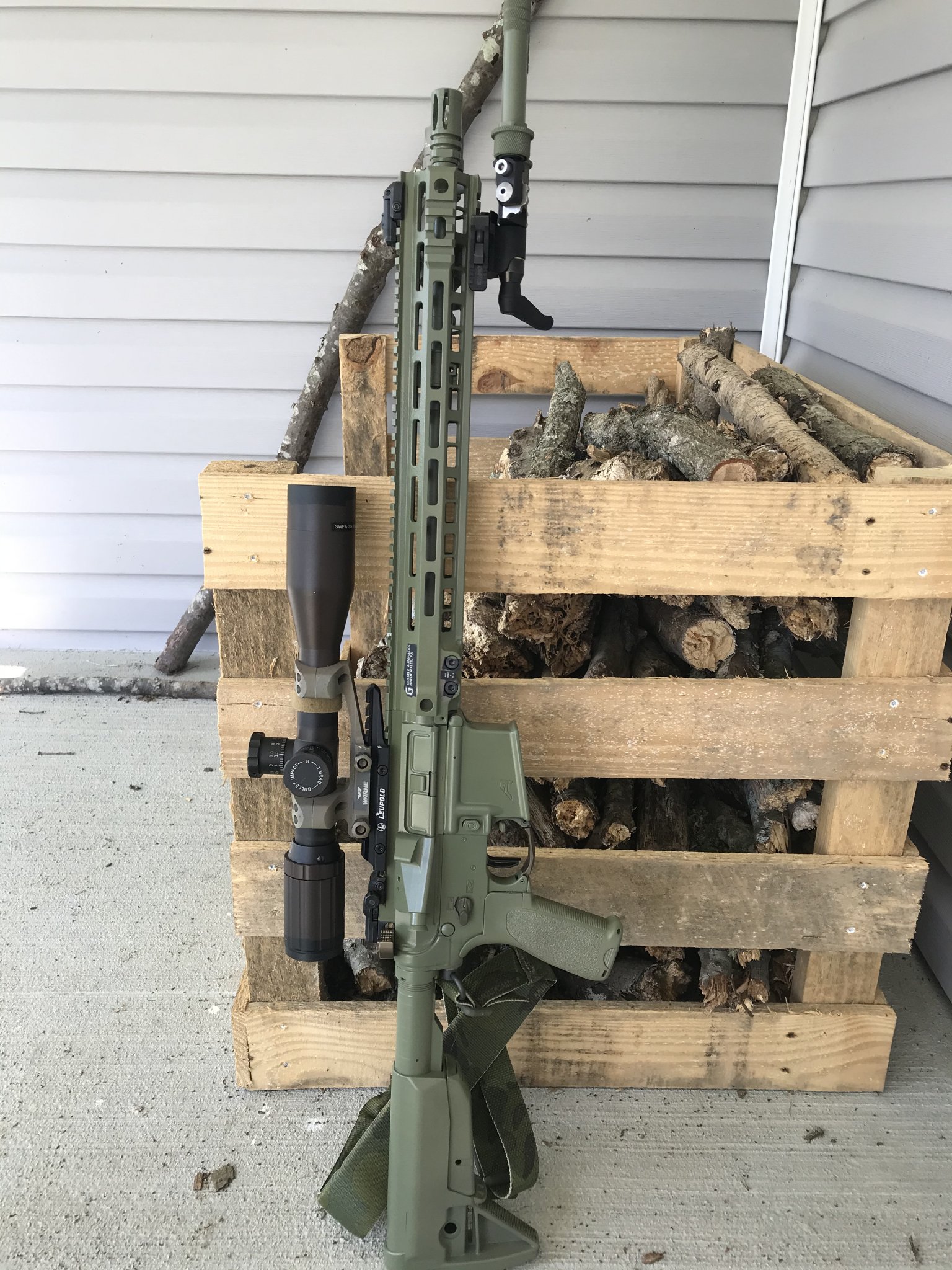

As you can see in the picture, the Warne mount plus riser. It works, but it’ll hopefully be replaced by a 1.57” NF 20moa Unimount or a Scalarworks 1.93”.

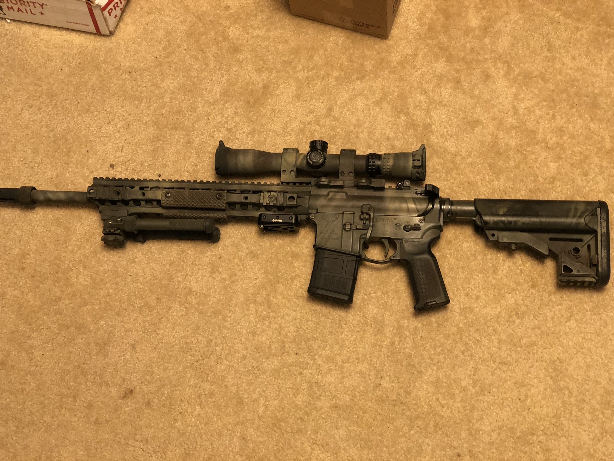

Heres a pic of my recce style rifle for inspiration. 2-10/3-15 scopes are the perfect compliment in capability and weight imo.
ETA: only other thing I can think of is you may find that the short lever raptor is hard to get ahold of depending on where you end up putting your scope for proper eye relief, but YMMV

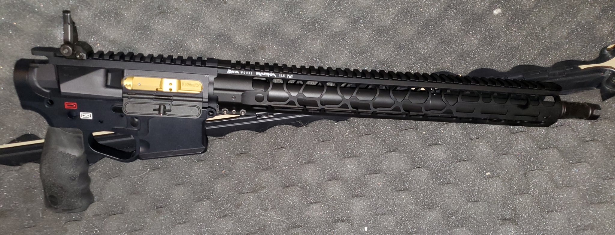

Got the Ragna in. It's well made. The barrel nut is much shorter than ideal, but there is plenty of clearance for the gas block & I don't expect enough flex for it to impact accuracy. I wouldn't use it on an "irons only" build, but I'm going to give it a try. If I find I'm having accuracy issues, it will be the first part swapped out.
Just depends on how you use it as to how much it will flex...................& it will flex.
Load it hard on a bipod & it will surely flex.
Except for the really flimsy rails that you can twist or bend in your hands, it's all about the length of the barrel nut & having enough surface area for the rail to hold onto & how the rail is attached to the nut.
A very short nut will allow more flex than a longer nut, no matter how hard it is to get the rail onto the nut or how tight it fits.
MM
Another little update on the Ragna handguard. Got the V7 Gas Block in, put it on the barrel, just to test clearance and there is plenty. The thickness of the San Tan billet upper the stout barrel profile, & the amount of daylight between the gas block & the handguard, I would not expect any accuracy issues to arise with the rail being the cause. Still wouldn't use it on an irons only build, but for this purpose it should be good to go.
Lancer discontinued the EFX-A1 stock (pity, great cheek weld & the weight would have balanced out the barrel nicely) so I'm putting a Rock River Arms A2 Operator Fixed Stock on it.
Swapped out the Ergo grip for a Blackhawk Knoxx because I like the way it looks better. Super important, I know 🙄
Trigger is ordered. Should have some build progress pics within the next week or thereabouts.
Got the TTU in and installed it. Gotta say, I'm a little underwhelmed. The break is fantastic and so is the reset, but the first stage is...kind of spongy. It's not awful, just would have expected smoother. I'm also surprised how short the first stage is. It's every bit as short as my Triggertechs, just not nearly as smooth. I'm sure with use it will polish out.
