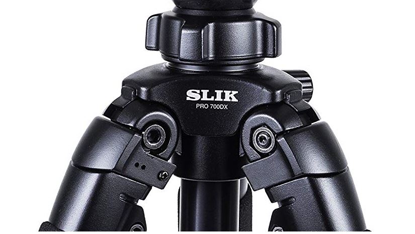

If you are looking for something that won't break the bank, I picked up a Slik 700DX as a first tripod system. I have a manfroto 322RC2 Grip to run my spotting scope or a pig saddle to shoot off of. The system is light enough that it won't break your back. I do have to add some weight to the system when I am shooting though. Typically I'll run 550 cord in front of my bipod to my butt stock and rest my foot on it below the tripod to drive it down. Couple videos on youtube showing this technique to help stabilize shooting off a tripod. Definitely a budget tripod but it works.

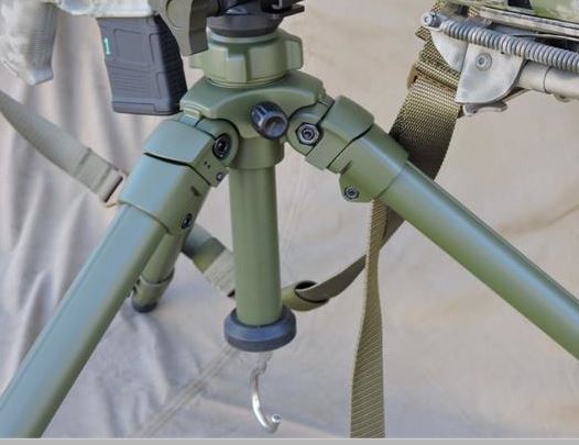

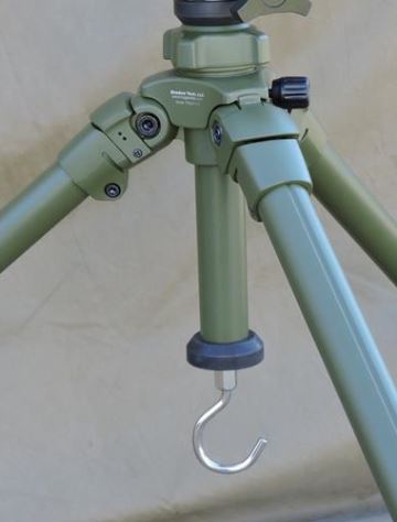

I went with the PIG tripod and an Innorel 44mm ball head. For $220 is seems like a solid setup but it's also the only tripod I've shot off. Added a RRS M-lok plate for my AR. My 10 year old took a 5 pt opening morning on her third shot ever off a tripod. So I'm calling it good enough. After season I'll try and stretch it out to see how the setup does.

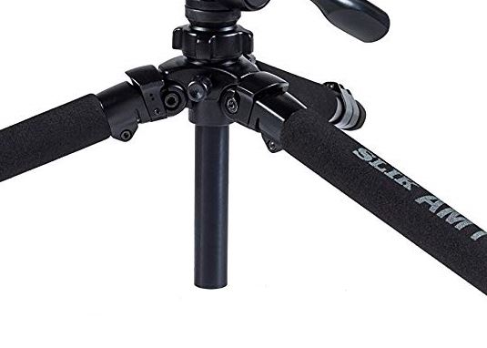

Aside from the paint job, hook at the bottom and the spiked feet the PIG tripod and the Slik 700DX sure do look alike. Lol
