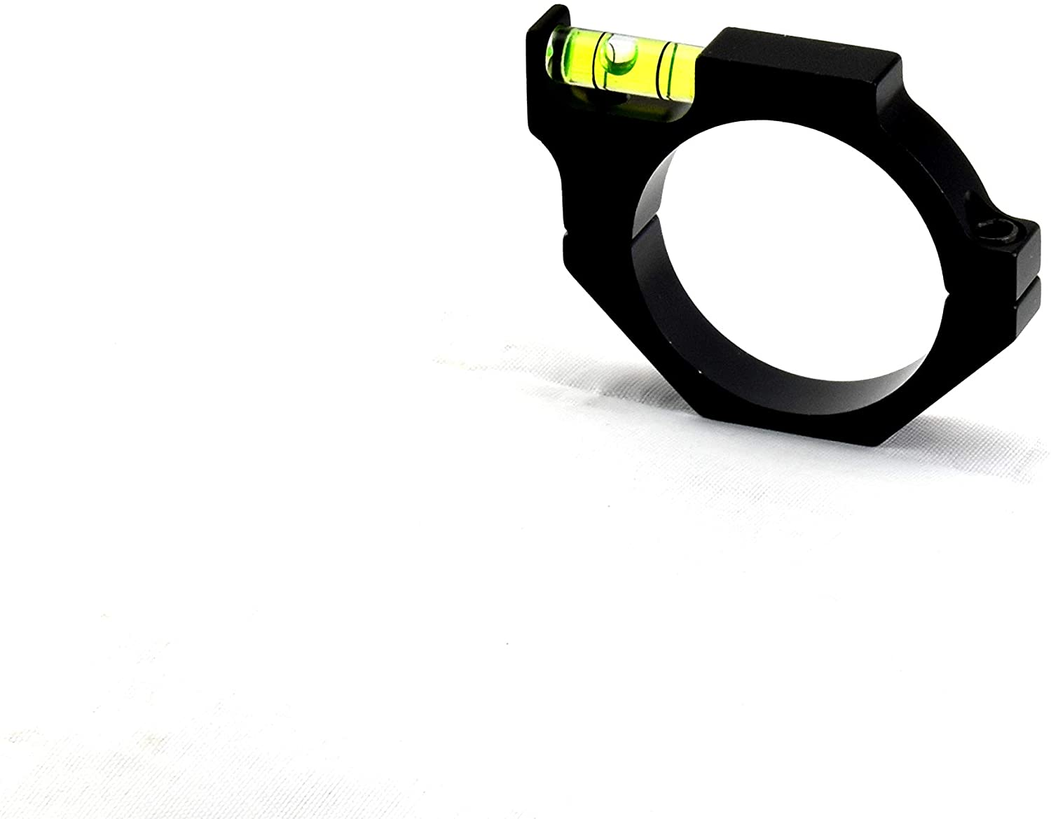

im just going to stick with this style. Get it level to the reticle. forget about it. even if removed from the mount, leave it on the optic forever. Better than anything else i've ever tried using. They can be cheap $4 or they can be nutts $200. Personally i would not buy one of the folding/telescoping ones. Basically Get one with no moving parts, clock it to be exact with the reticle.
