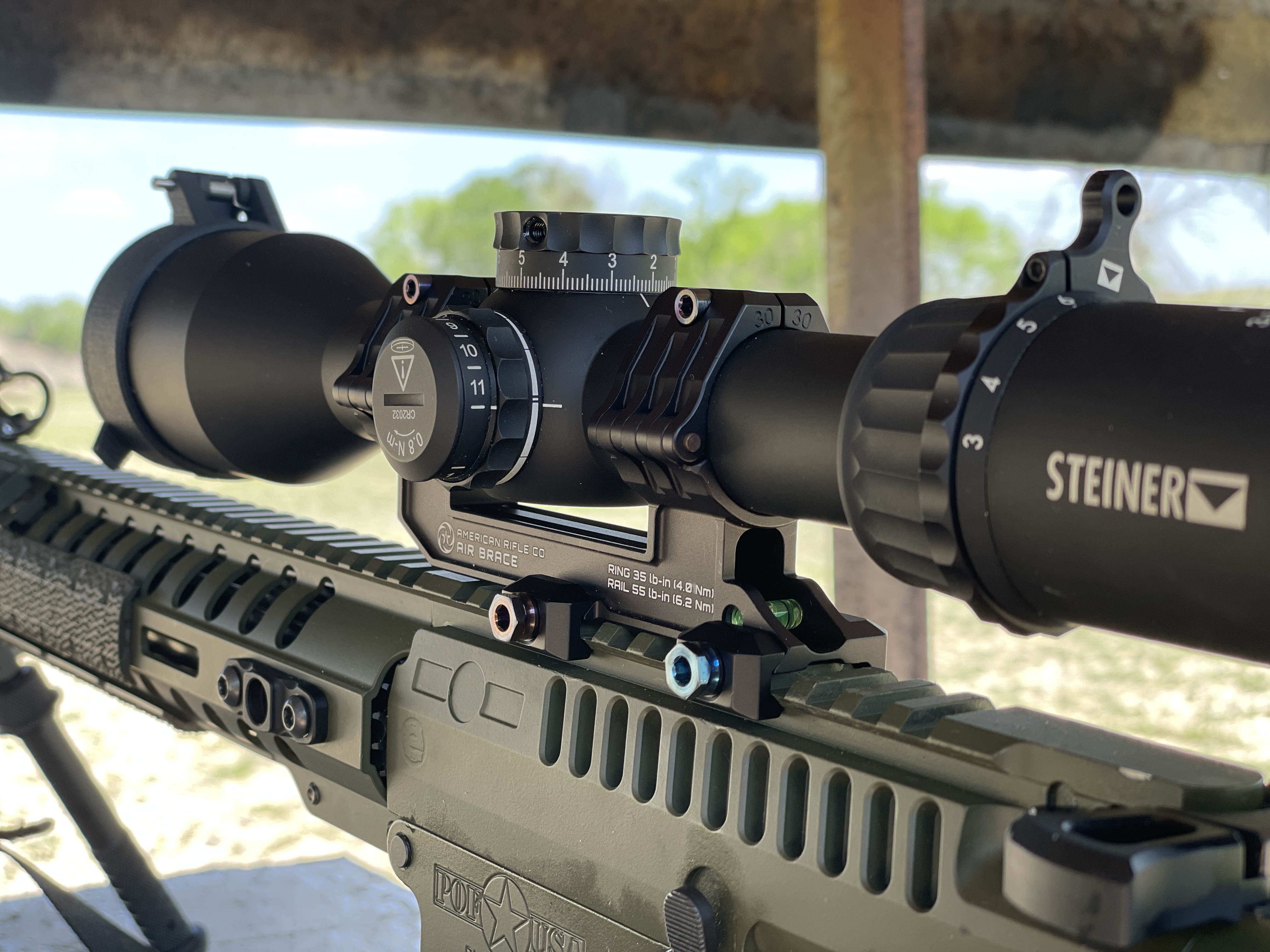

Mine arrived rather suddenly last Thursday. Got the notice on Wednesday and it was in my hands on Thursday. If y'all sent it overnight, you certainly didn't have to do that but I do appreciate it! Haven't used it yet but color me impressed, really nice build quality. The bolts look like heat treated titanium even though I know they're stainless. Now I have to decide what rifle/scope to use it with or do things properly and get a new rifle and scope to go with the mount.
i have one in the 30mm 20 moa variety and its the standard ARC quality. scope doesn't move at all when you clamp the rings down. level is perfect and the new colored screws are cool.
Big upgrade to the old ARC QD-L mount I used for years on my AR.
But I miss the QD-L thumb wheels, Ted mentioned early in this thread that would be coming, still waiting for that @karagias
