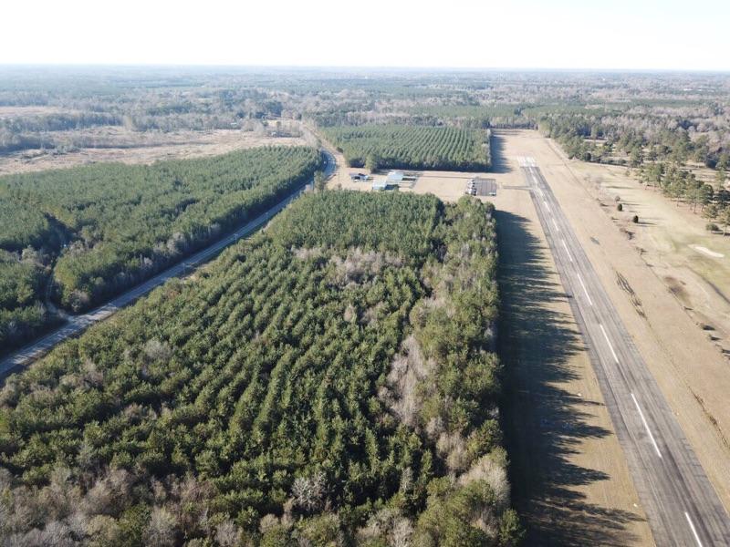

I shoot in several different terrains via images below and each of them demand a different degree of knowledge, support equipment, etc etc.
Flying into a "green" shooting facility. We have access to utilize the runway and safety zones on each end of it to set up for Doppler testing.

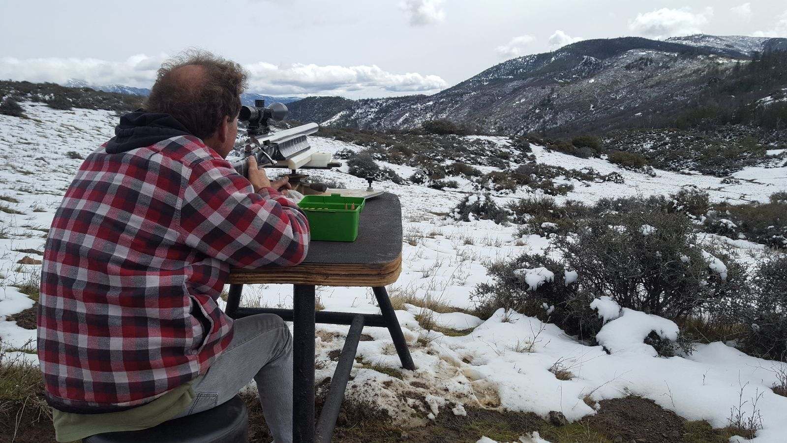

Then...arriving at mountain/winter shooting environment. This is absolutely my worse and least favorite shooting environment.

Hi,
Absolutely in agreement that terrain/environment is a major factor in the success or failure of an ELR venture.

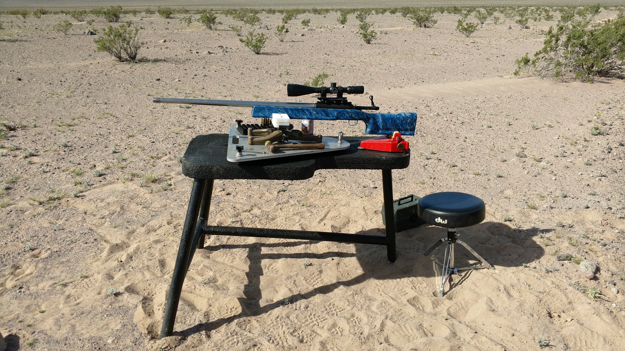

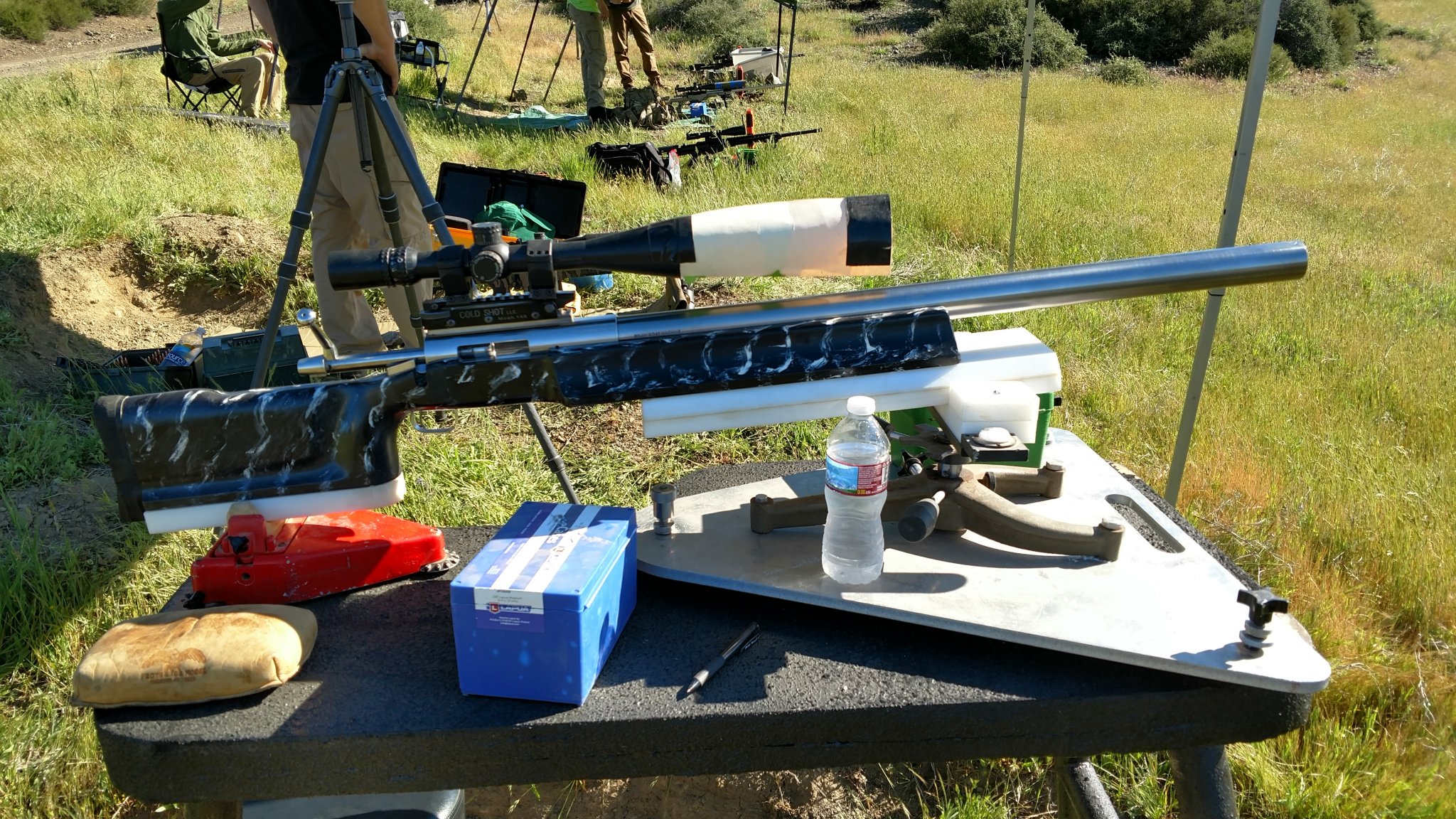

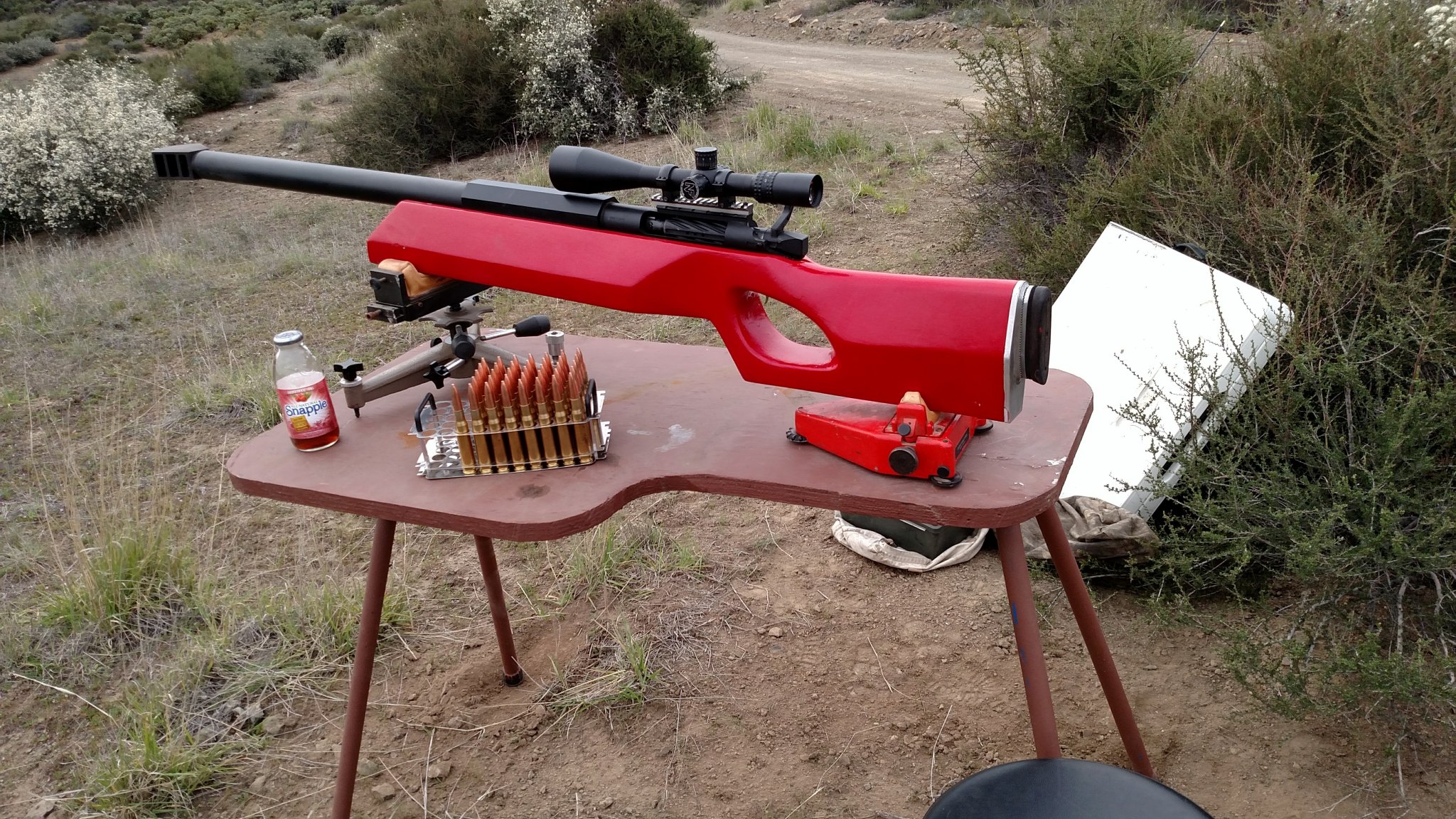

Some pictures of our conditions. I have better pictures but they won't upload.
338 Lapua Ackley Improved
338 SnipeTac
375/50 BMG
50 BMG
I shoot from the bench but most shoot prone.
