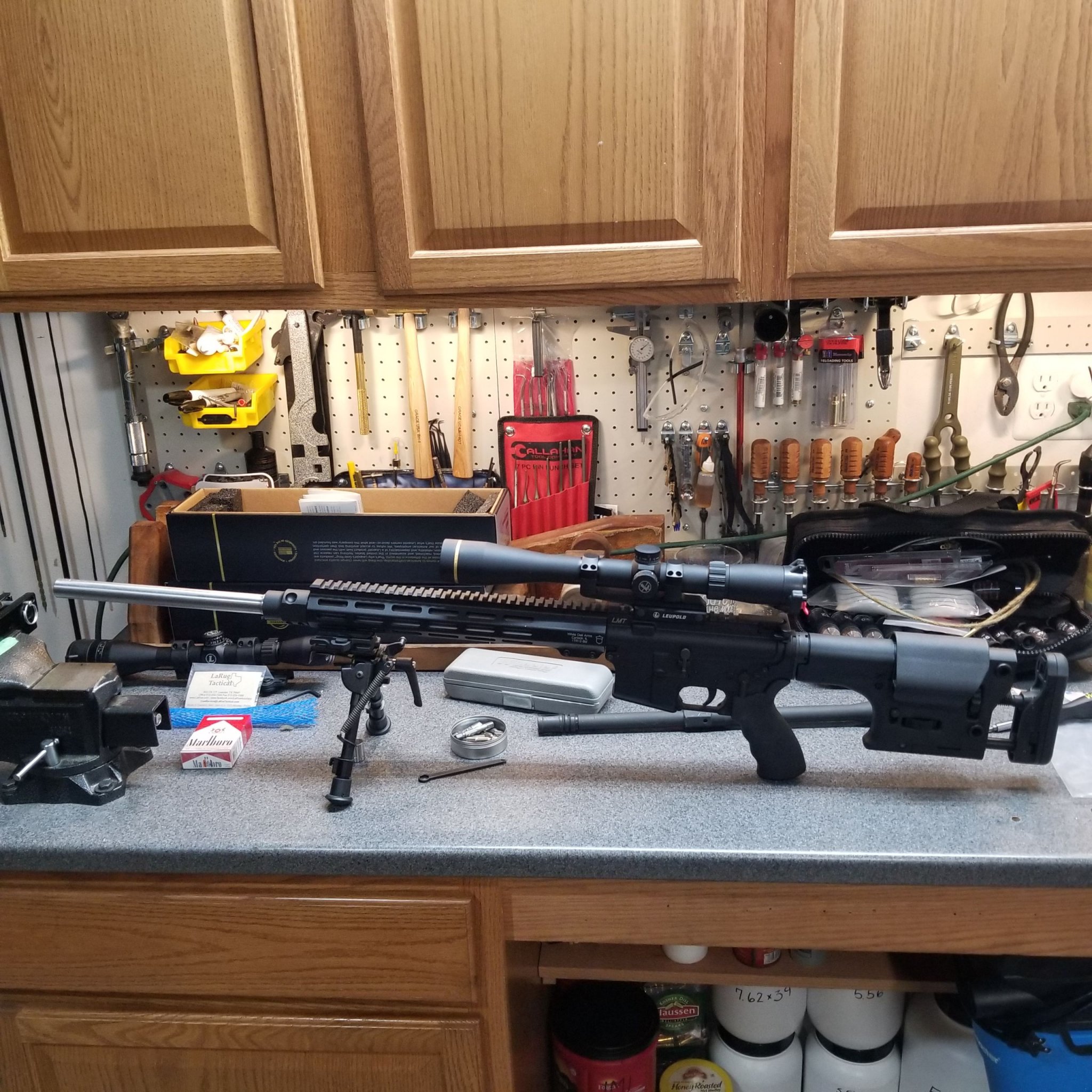

    WOA 1in10 24" in a LMT upper/lower. Pardon the bench mess.
    Reactions: supercorndogs
    WOA 1in10 24" in a LMT upper/lower. Pardon the bench mess.View attachment 7461712
