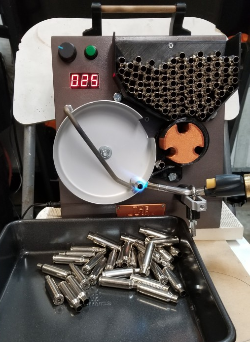

Oh BTW ... annealing probably comes before any tools for seating force measurement. I consider the "Annealing" step to be mandatory. Go buy an AMP ... and skip the whole "propane mess".
I agree with buying the best annealer you can afford. I decided to build this one to see for myself, the benefits of annealing. Kits and plans are availavle on the internet. The plans, diagrams and templates as well as 3D printed components for this one came from Etsy. The remainder of the components came from Amazon and Home Depot. It took me a day to build and was well worth the effort. After converting 6.5 Creedmoor to 8.6 Blackout, I am sold!
