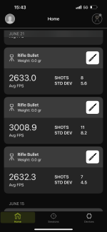

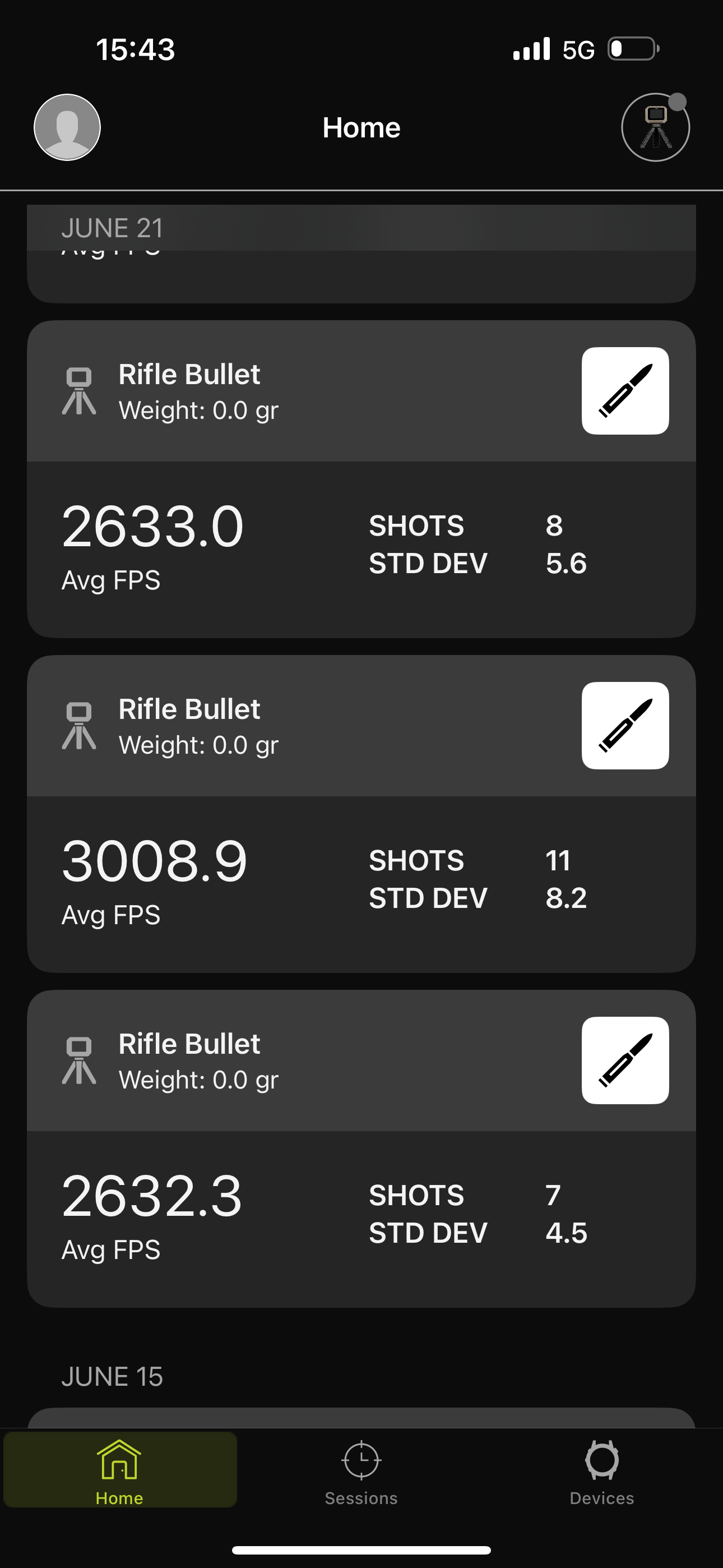

Just start with the expander (I shot every round above with an expander - I own a mandrel). later on you can play with Mandrels if you get bored but it’s completely unnecessary.
Only $300+ dies have a mandrel function built in and it’s not a true mandrel so you don’t have to worry about those.
You should eventually anneal. Just get some good groups and learn first then add it in. It’s not critical to learning to reload.

See if you can get retumbo. Hornady brass is good but shows ejector swipe quicker than adg brass. That's the brass to get.
I've got a 26" and running the 180 eldm which in my opinion are the bullets to use for hunting. Alot of shooters in the west run match bullets and call them killing bullets. If your not hunting rino or not going with all copper (barnes) I'd just run the 180s. I like barnes alot just hadn't got to use em on an animal yet.
With 180s eldm, adg brass, 13ths off lands, 2ths headspace, cci br2s, retumbo 69.0 grains = 3,014 es23, SD 7.8 and 0.51 moa. SD was alot higher during the test but seemed fine out to 1100 yards. May try retumbo.

I didn’t see a lot of people using Retumbo in the thread but I’ll keep that in mind. Definitely some good performance having SD’s in the single digits. I’m shooting out of a 22” so getting 2900 would be great with a 180 assuming 25fps/ft
