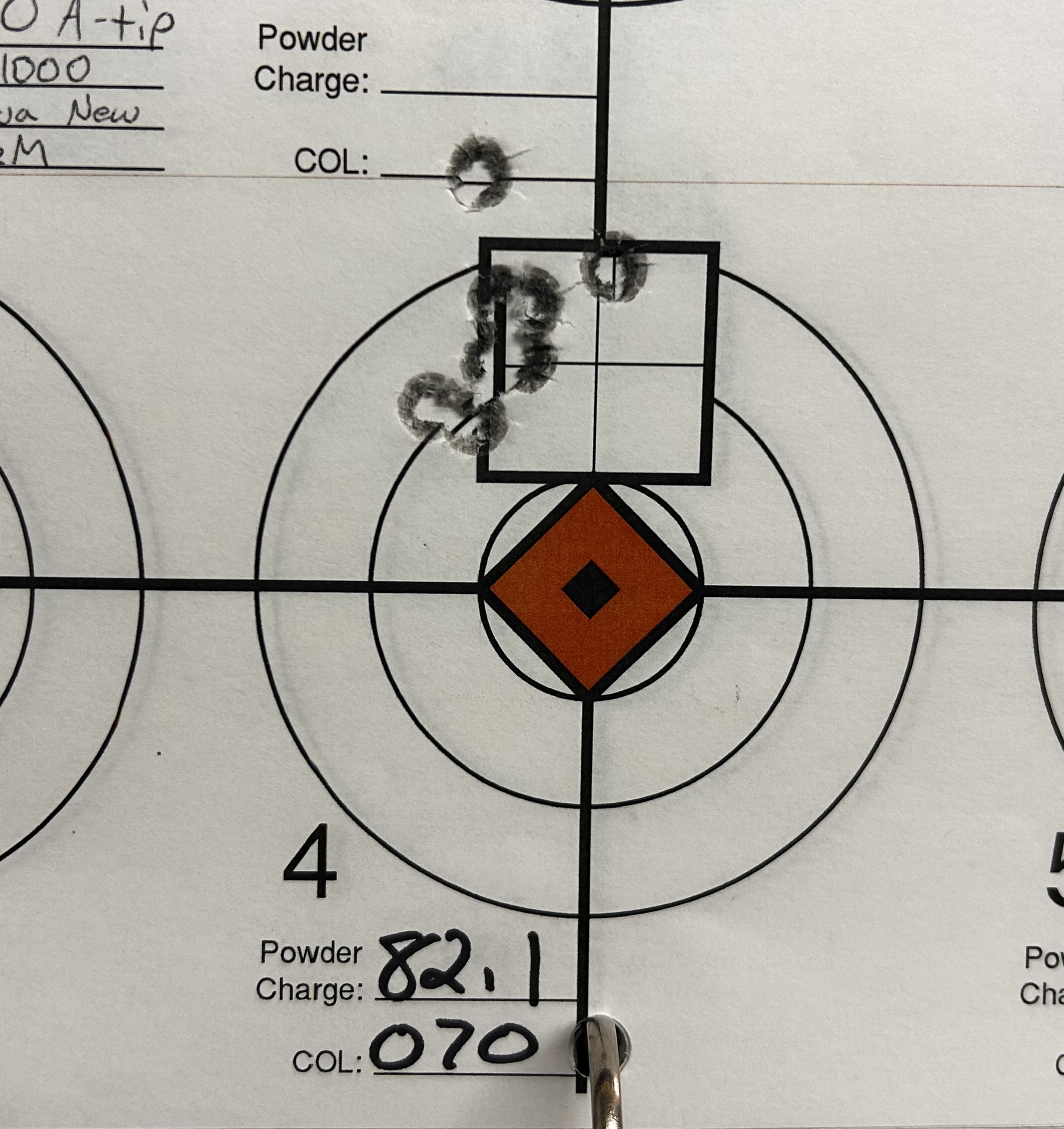

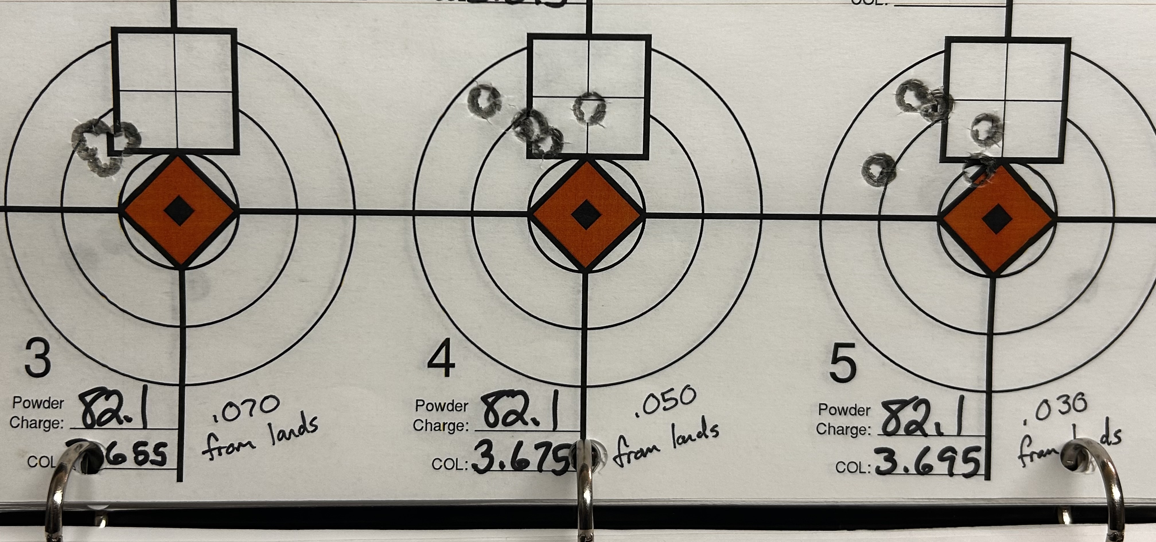

I loaded up five rounds each of 82.1 at .030, .050 and .070 from the lands and fired them in the same ascending order style and got these results.

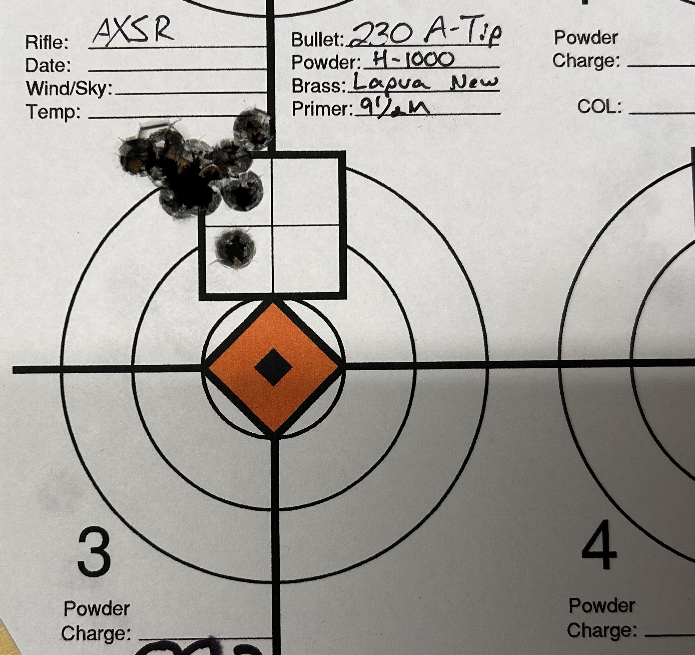

Loaded up 10 rounds at 82.1/.070 to see if I could confirm it and it looked like this.
Decided to test the same load again to see if this was me and to check neck tension results so I loaded up ten each at .002 and .003 neck tension and got these results. ES at .002 was 21 and at .003 was 49.

So, some of that looks like shooter fatigue to me. The .070” off group at 82.1 looks good and shows what the gun is capable of (albeit a small sample so we’d expect that group to grow if you shot 20 rounds.). If it was me, I’d stop right there. Come back, if you want to verify, and shoot a three shot group at some later date when you are warmed up but haven’t shot much.
OP, I hate to say it, but it looks like you got bit by the sample size bug. The good thing is that you repeated the test, instead of going off of one group and calling it good (BTDT and learned my lesson many years ago).
