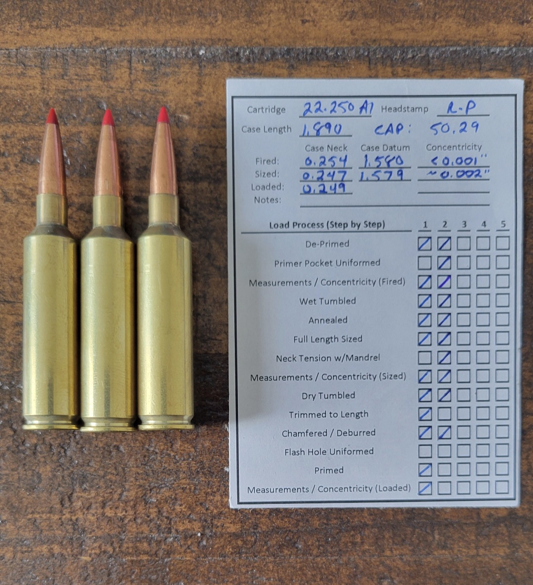

Not an application, but I made this reloading card in Excel (where I keep my load records and even printable targets). Its just another tab.
Documents my process and marks where I'm at by adding a slash in the box when complete. That way when I come back to brass 6+ months later I don't rely on my memory to know if I already sized or not, etc.
Easy to modify with your process. I print them and each box of brass gets a card.
Once each of the 5 loads has a slash in it, I go back with another slash to make an X. 10 size/loads per card. Simply add more cards to that brass if needed. Great way to keep track

Great cards, I have thought about making one myself but havent gotten around to it yet.
Everybody has their own eccentricities - possibly forever adding / removing steps / fields.
You’ll really have to roll your own.
I personally print four 4.25” x 5.5” quarter sheets at the most - not more than that because I’ll likely be unhappy with what I have by then and would want to have something changed.
Minimizes waste that way.
Caliber and Quantity: 7.62x51mm
Brass Manufacturer and Date: Lake City 2011
Firearm / Barrel History / Remarks: AI AT Lothar Walther 1/12” barrel from hell, fat - bottomed bases
Firings: 2x | Reloadings: 1x
Cleaned Y/N | Method: Ultrasonic
Swaged Y/N/NA | Primer Pocket Uniformed Y/N | Flash Hole Uniformed Y/N 0.062" (small) | 0.082" (standard)
Sizing Method: FLS, Small Base | Headspacing: +0.001” above SAAMI maximum
Case Neck Dilated Y/N | Mandrel Diameter 0.3065"
Neck Turned Y/N | Neck Thickness: 0.01450” | Neck Sizing Bushing: 0.335” (if so employed)
Case Trim Length: 2.010”
Annealing Program: 75
Primer: Remington 9 1/2 | Powder: IMR 8208 XBR 42.4 gr | Bullet: Sierra MK 175 gr
Cartridge Overall Length Seating Depth: 2.820” | Ogive Distance From Lands:
Temperature / Pressure / Humidity:
Date Reloaded:

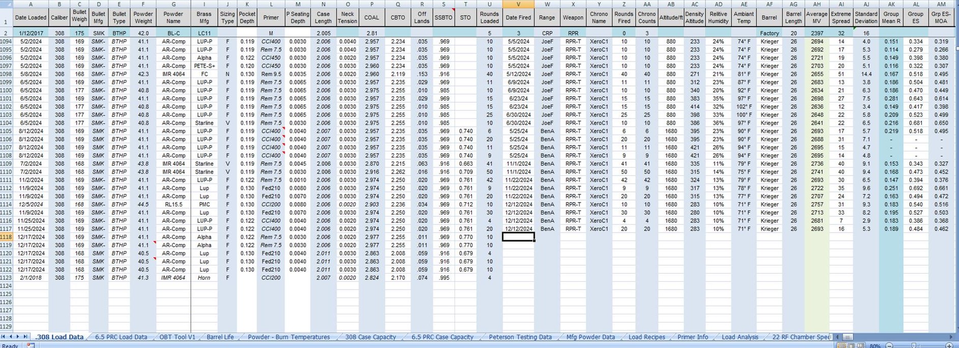

For brass prep, I have my prep steps listed on both sides of an 8x11 piece of paper that I keep with every batch of brass that I have that's in their own container. Loading data and results are kept on a spreadsheet. The spread sheet makes for easy searching and sorting for comparisons, putting notes on any particular item, and I also have various tabs for other data, as you can see at the bottom, that I collect for my library of information.

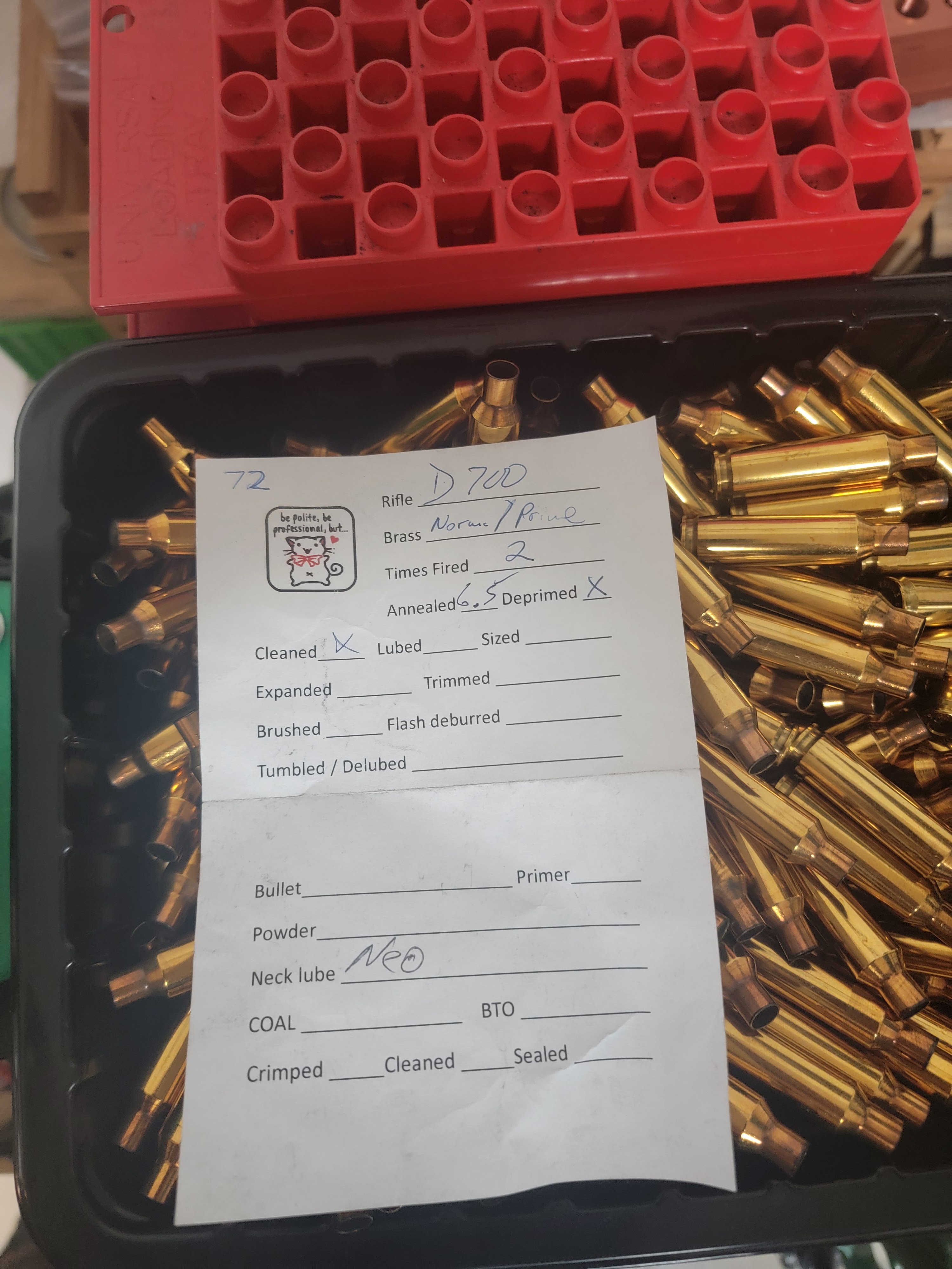

Man, I just use a piece of masking tape on the ammo box - marked with the part of the process I last completed. I am woefully lacking on my data recording. :D
Since my brass prep is the same for every cartridge I load for, there are no special steps that I might miss.
