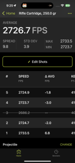

It’s performing well at a mile. It’s just physics says it should not.
See the picture. Four shots 3.9 SD and one is 30 fps lower. Going to try even more careful set loaded for this weekend.
