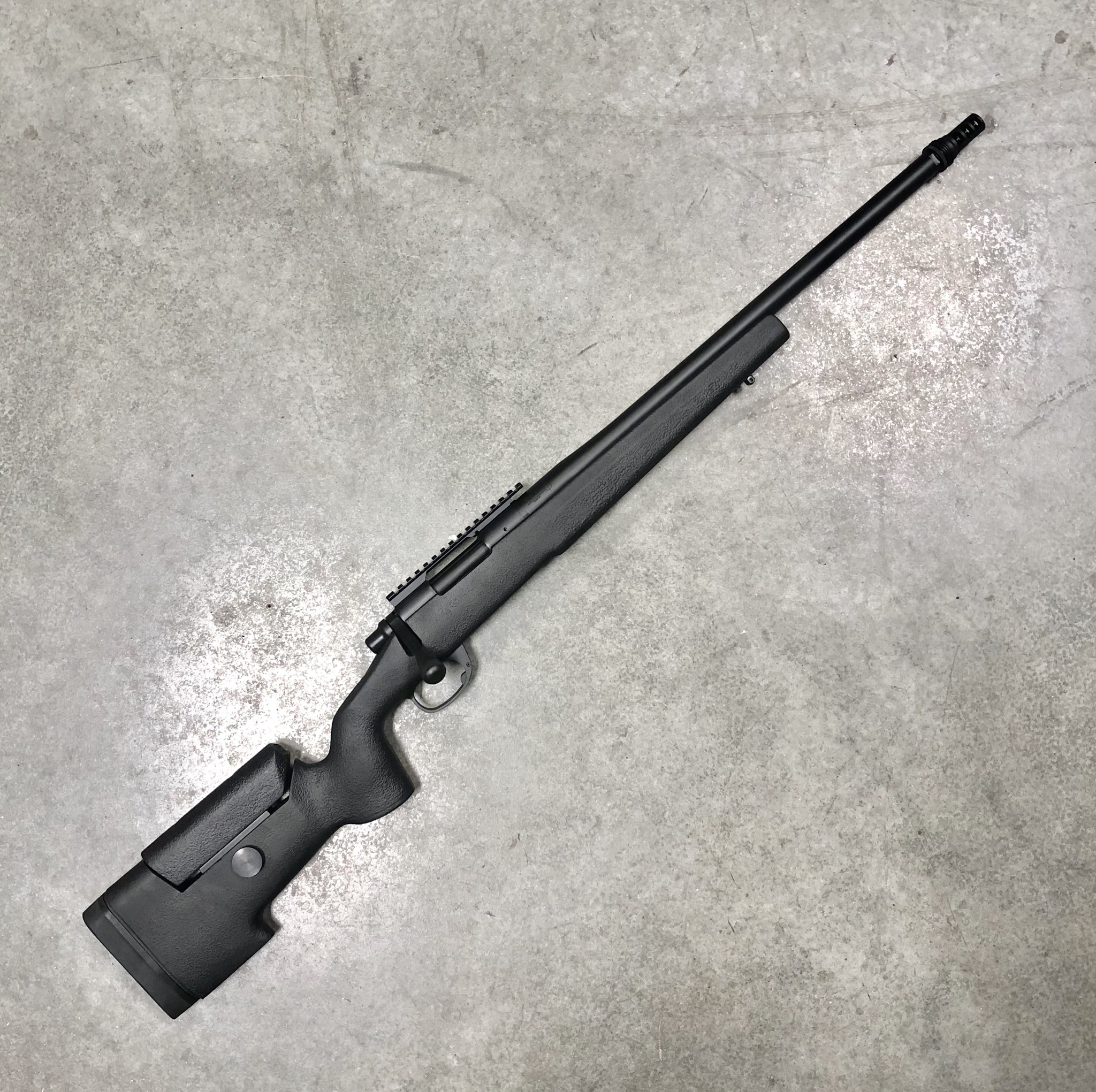

I really like my .20 practicals. The first one was 26 inches, and hunted a season with it. I shot 39gr bullets. The next one was 19”. I’ve got two and a half seasons on it now, and while it’s giving up velocity to the 26, I’m scoring just as good. In fact my longest 20 cal kills are with the shorter gun(beyond 500 yds). Still shooting the 39 BK as well, due to the better wind drift performance. At the same time I built that gun, I barreled a friends Howa at 20”. We had sequential Krieger blanks, and his results are identical to mine. Where we shoot p-dogs, it’s typically a hit and run affair due to a lower number of animals at each spot. I chose handy over ultimate performance. Been whacking the shit out of coyotes with it too. .20’s are badass!

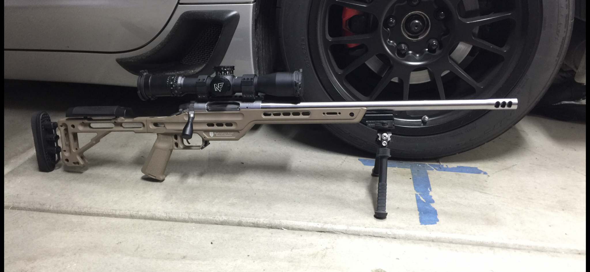

I have a 25" barrel on my 20 practical bolt gun. One of the most accurate rifles I own... pure blast to shoot, very entertaining in the gopher patch!
It loves any tipped 32gr (Zmax, Varmageddon, Blitzking, etc)
The 39gr Blitzking is also wicked accurate and the projectile of choice for the longer shots.
I'd recommend picking at least an 11 twist barrel if you plan to try shooting 40gr bullets. The 32-39gr work great in 12 twist or tighter.
I've got a few 20 cal guns and the ones with 12 twist don't do well with 40gr bullets for me.
