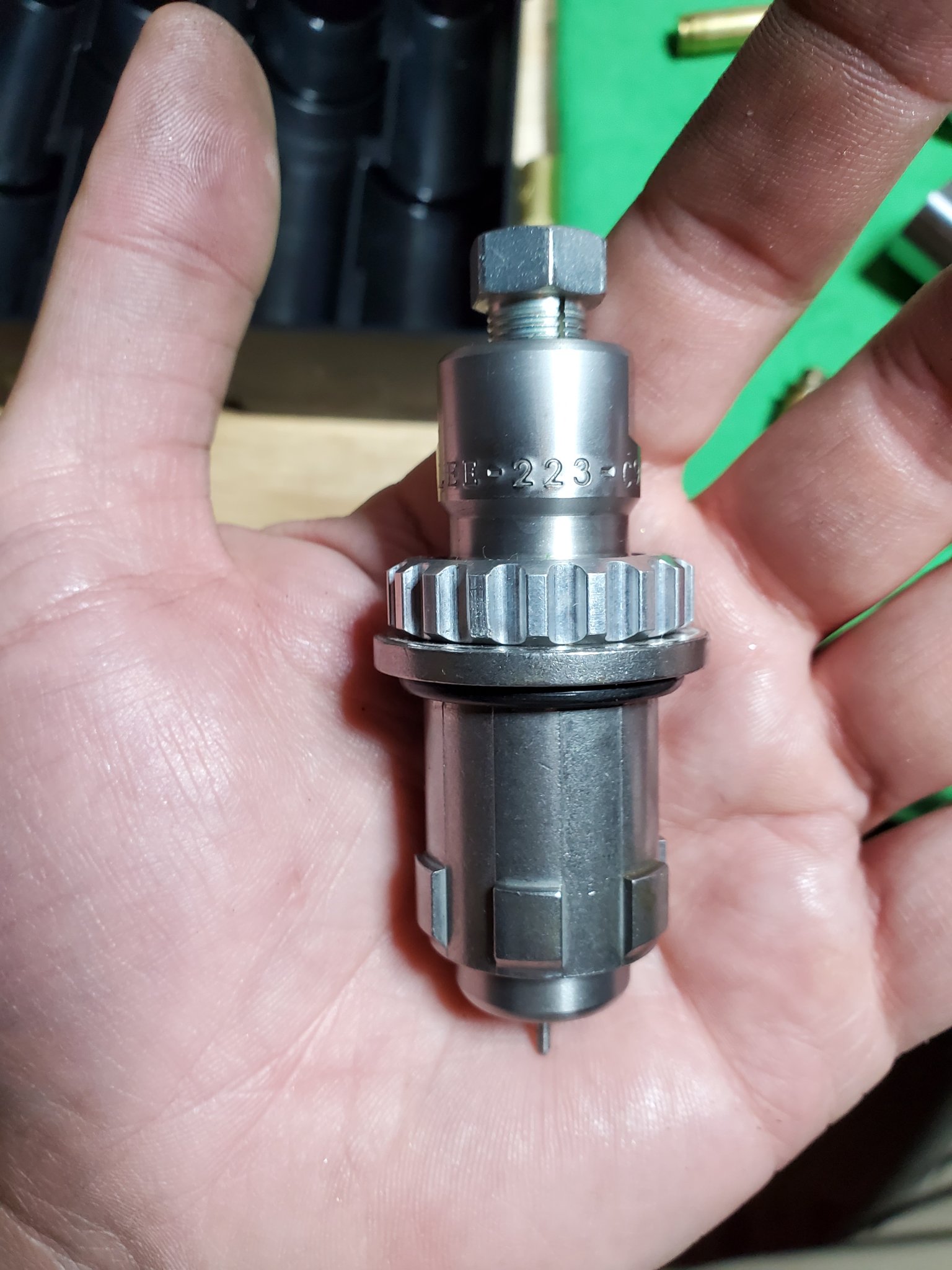

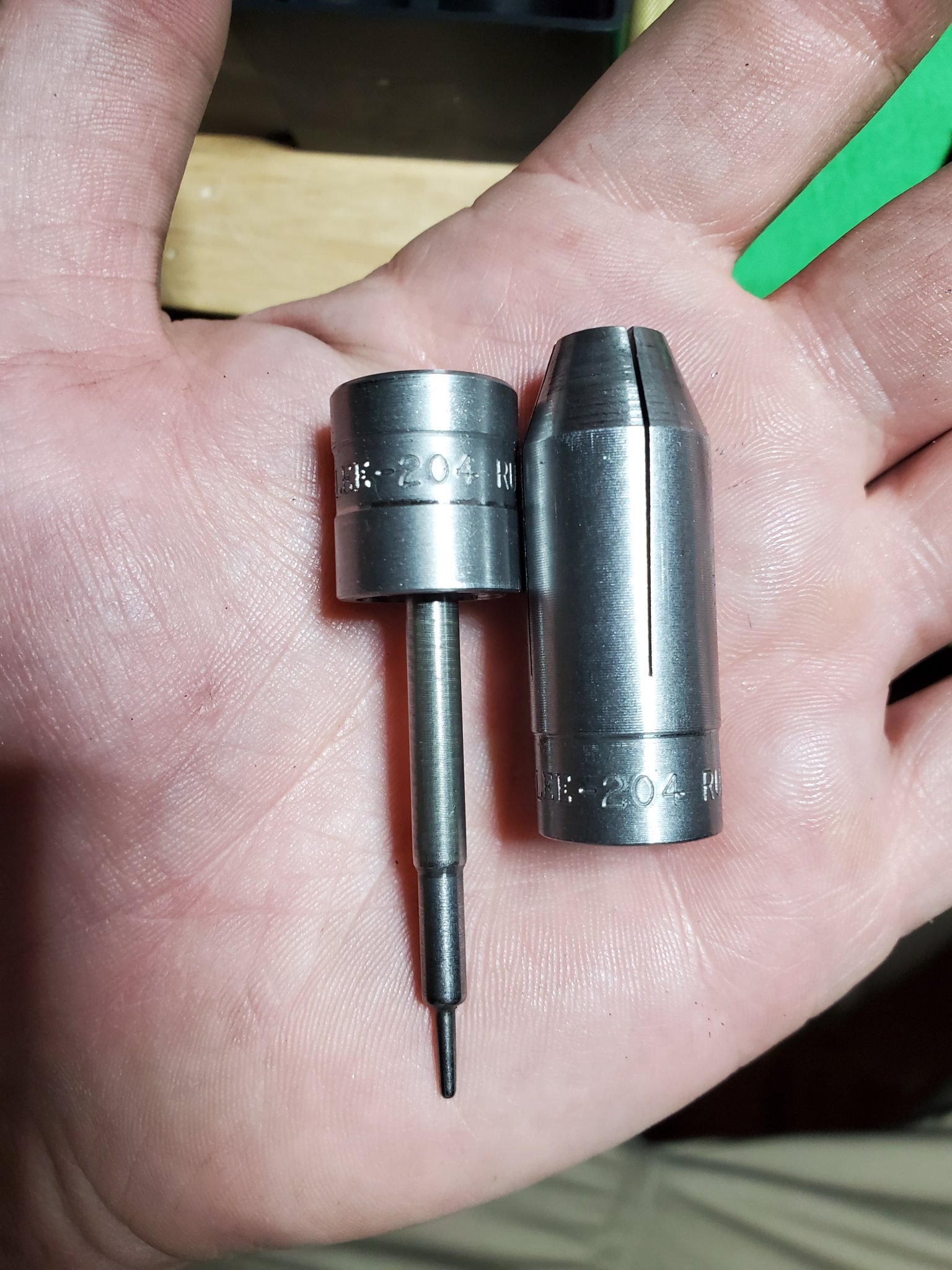

Hey Guys. Has anyone here formed resized 20 practical brass with Lee collet dies?
I recently put together a 20 practical on a savage action and have been trying to put dies together to reload with no luck. I'm into dies about 120 bucks already and not sure what I am doing wrong.
Long story short is I followed instruction from another forum and bought of 4 Lee 223 Collett dies (full size, neck sizer, seater and crimp). Then I purchased the 204 ruger mandrills and 204 collet for the neck sizer die. After putting the pieces together I full length sized the brass (with 223 die) then every time I try and neck size with the 204 collet it smashes the shoulder instead of reducing the neck to 20cal.
Did I waste a bunch of money on Collet dies when something else Is required? Any advice is appreciated thanks

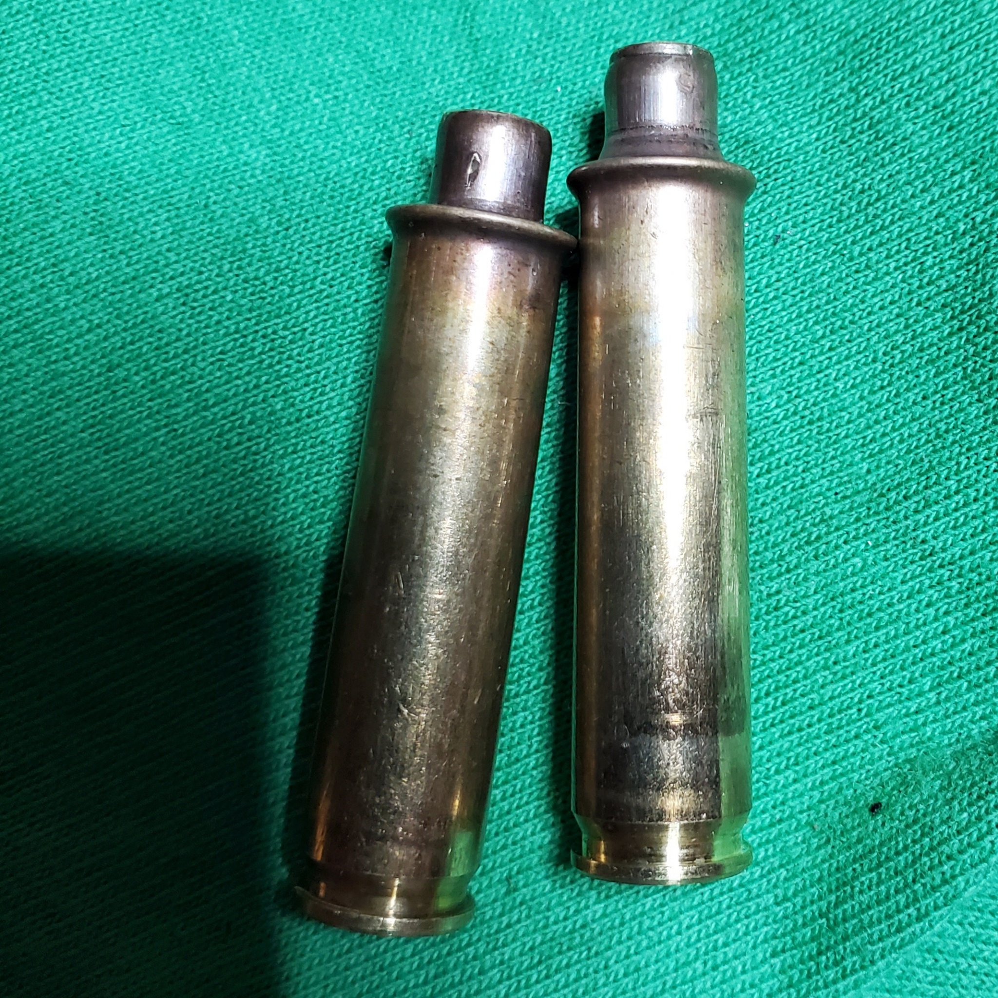

Basically the 223 neck is not making it inside the collet and instead is pushed down and collapses the shoulder.
Gotcha. I have seen a few people on other forums using lee collet dies to form 20 practical is the reason I went this route. Is there another step that I am missing like necking down to something in between 22 and 20 cal? Or what would you suggest. thx

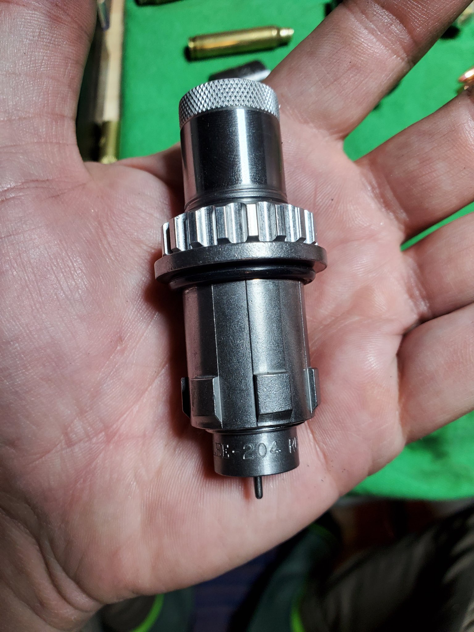

I use a Redding type S FL 223 die, with a 204 recapping rod and expander ball, and the appropriate bushing to size it down a little smaller than the expander ball. I have brass made, I am still waiting on a barrel that was supposed be done about 8 weeks ago now. LOL.
Yeah It looks like the collet dies will work great only after they are already sized for 204 not to neck down from 223. The Redding bushing method is the most popular so ill probably have to cut my losses and buy that setup now.

Below are my notes about how to form 223 cases, any 223 cases, into 20 Practical cases. I have done a lot of wildcat brass forming and this is as simple as it gets. So far, I have not proven that any particular brand of cases is better for this than another. Think about that before you blow a lot of money. Feel free to ask me any related questions. Use a 204 diameter decapping rod in the die. I set up a Redding 223 small base sizing die for this and do not use if for anything else. Therefore it is always set up for this cartridge and specifically not for the 223. I seat my bullets with a Wilson Chamber Type seater die in 20 Practical using an arbor press.
This is not hard.
8 FEB 21​
  • CLEAN THE BRASS
  • INSPECT BRASS
  • CHECK PRIMER POCKETS
  • ANNEAL IF APPROPRIATE
  • LUBRICATE
  • SIZE USING YOUR REDDING .223 SMALL BASE SIZING DIE WITH NECK SIZING BUSHINGS. NOTE: OLD INFORMATION SAID TO PUT THE NUMBER ON THE BUSHING UP. PRESENT VIDEOS DO NOT TELL YOU THAT YOU HAVE TO DO THAT.
  • PRELIMINARY RESIZE
  • SET BACK SHOULDER
  • PRELIMINARY NECK SIZE USING 0.233 NECK SIZING BUSHING
  • FINAL NECK SIZE USING 0.226 NECK SIZING BUSHING
  • TRIM FOR LENGTH IF NEEDED, SAME LENGTH AS 223 CASE

I just tried using the seating die from the Redding Custom for 17-556 KAK on 5.56. Using the sizing die on the 5.56 cases, I was getting 50% crushed cases. Running them through the seating die, THEN the sizing die it worked 100% of the time. It leaves a little dimple on most shoulders, but that will go away with the first firing. Thanks a Million!
