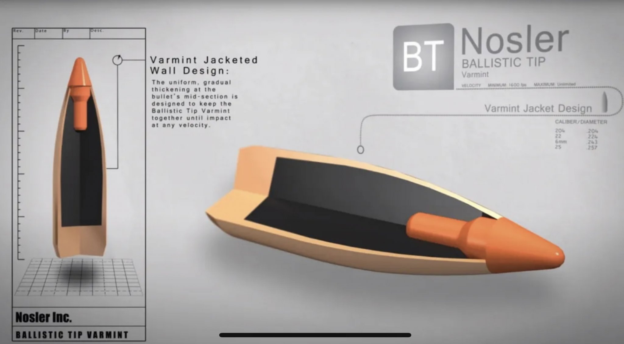

Like @MarinePMI said, bullets matter. My coyote bullet is the nosler ballistic tip. The heavy base and tapered jacket does coyotes just right.
