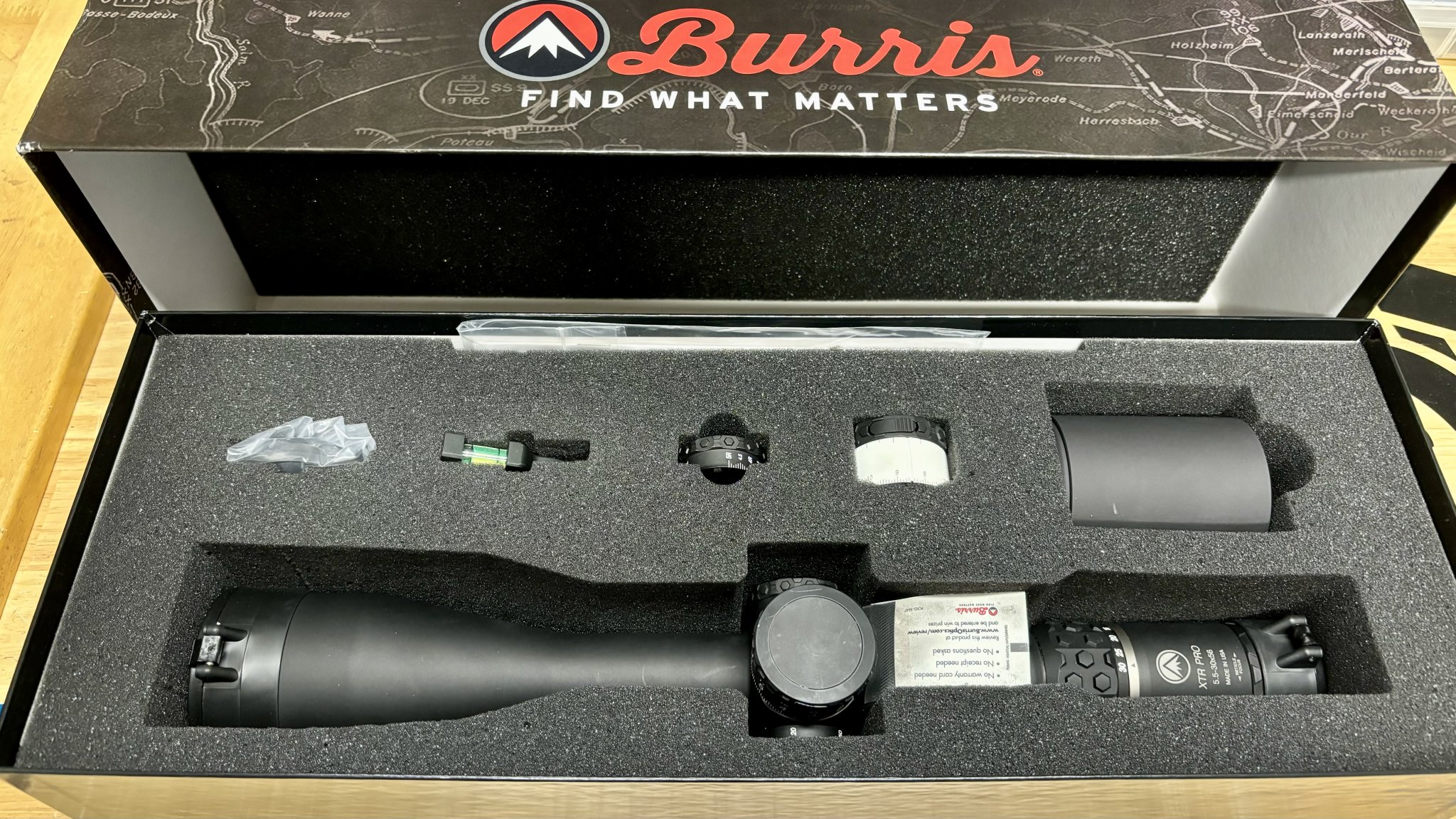

Both mine came with the throw lever, Burris branded Butler Creek scope caps, sunshade, and bubble level. I hadn’t seen anywhere else that others had gotten the bubble level. Maybe that’s a new edition? Maybe I just missed it?

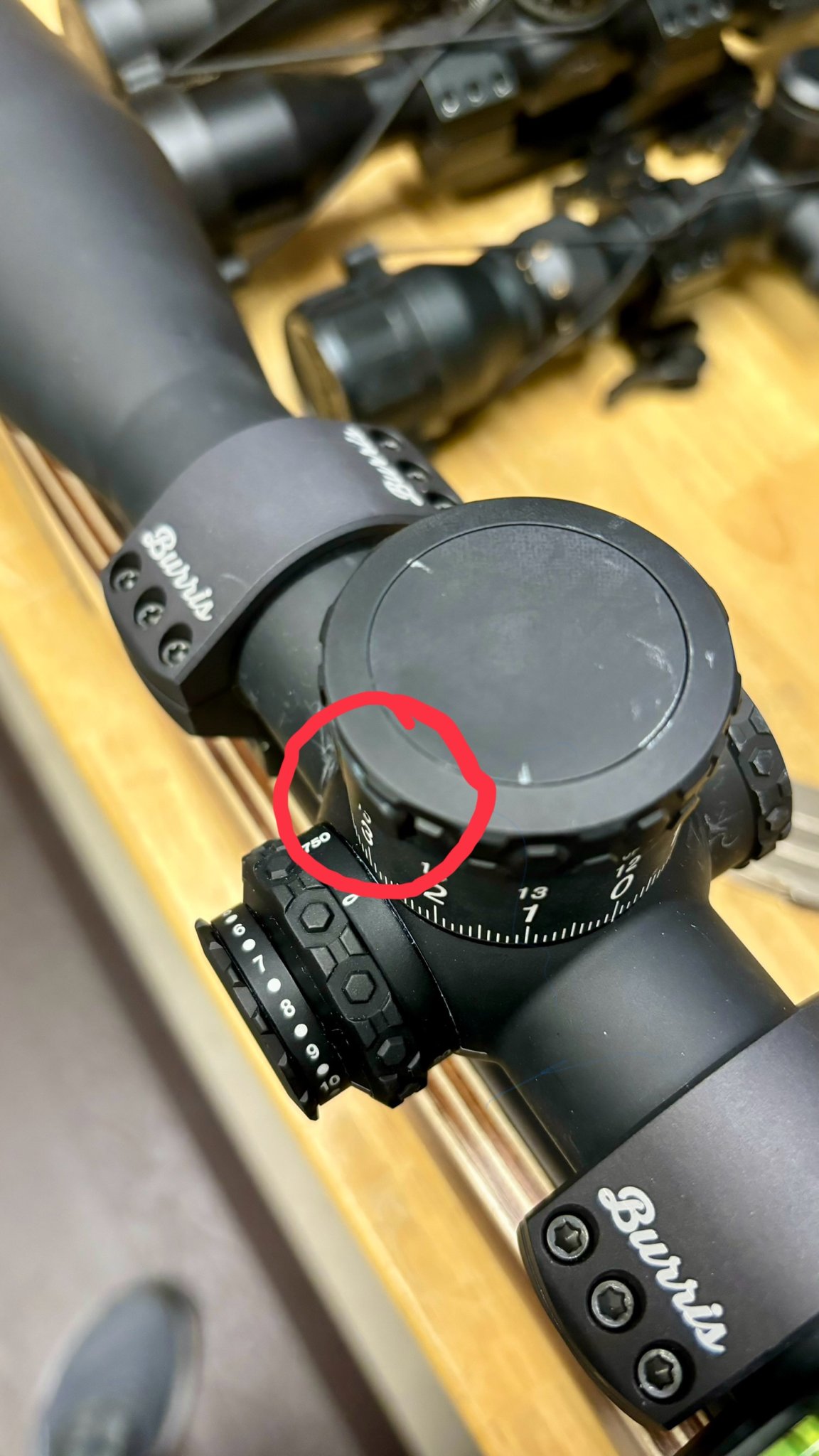

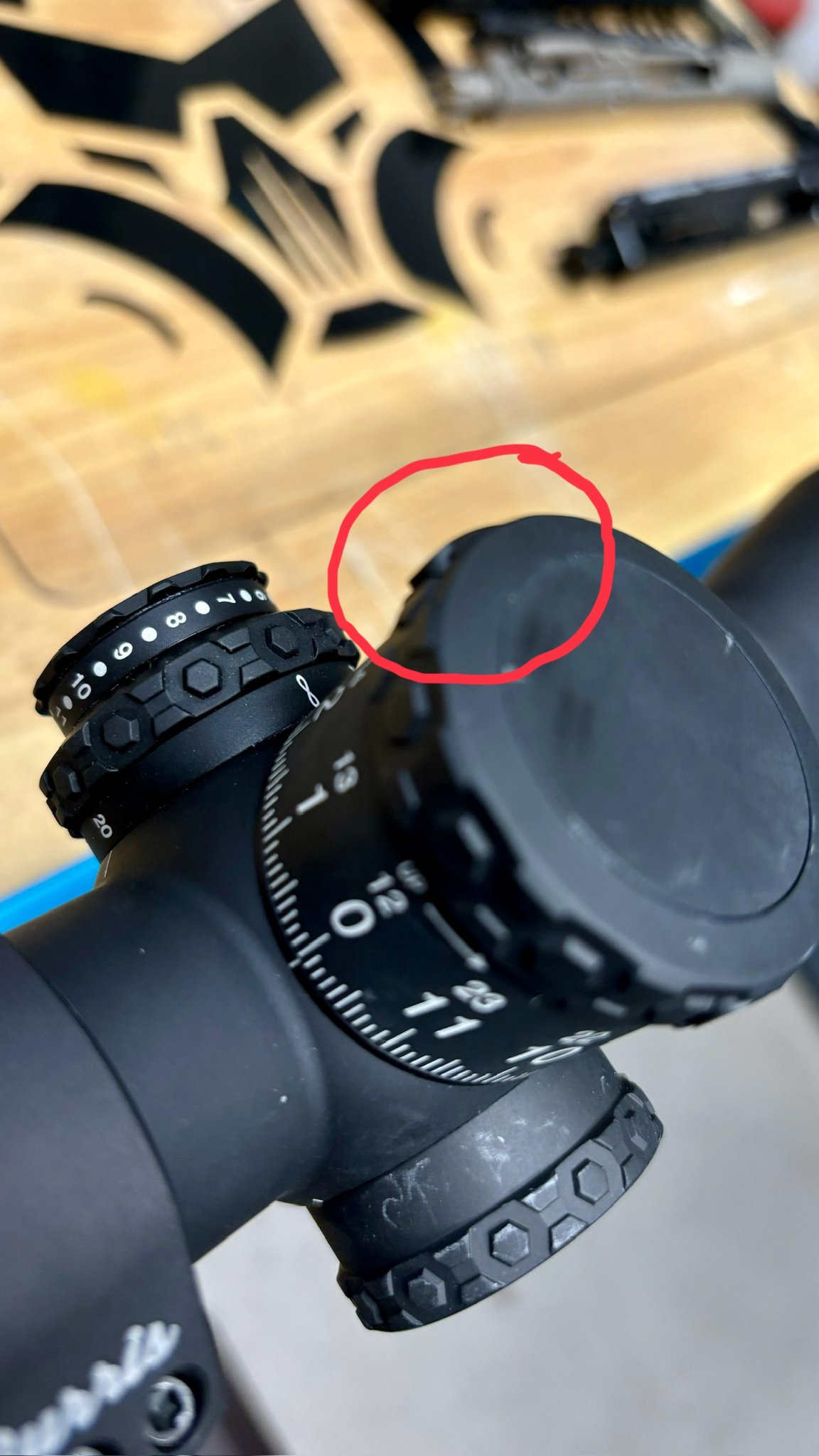

On the first scope I received the standard black turret cover does not appear to seat fully. Not sure if you can see it in the pictures or not? If you pull a little while turning, the dial will dislodge. The race dial seats fully. And on the second scope both dials seat properly.

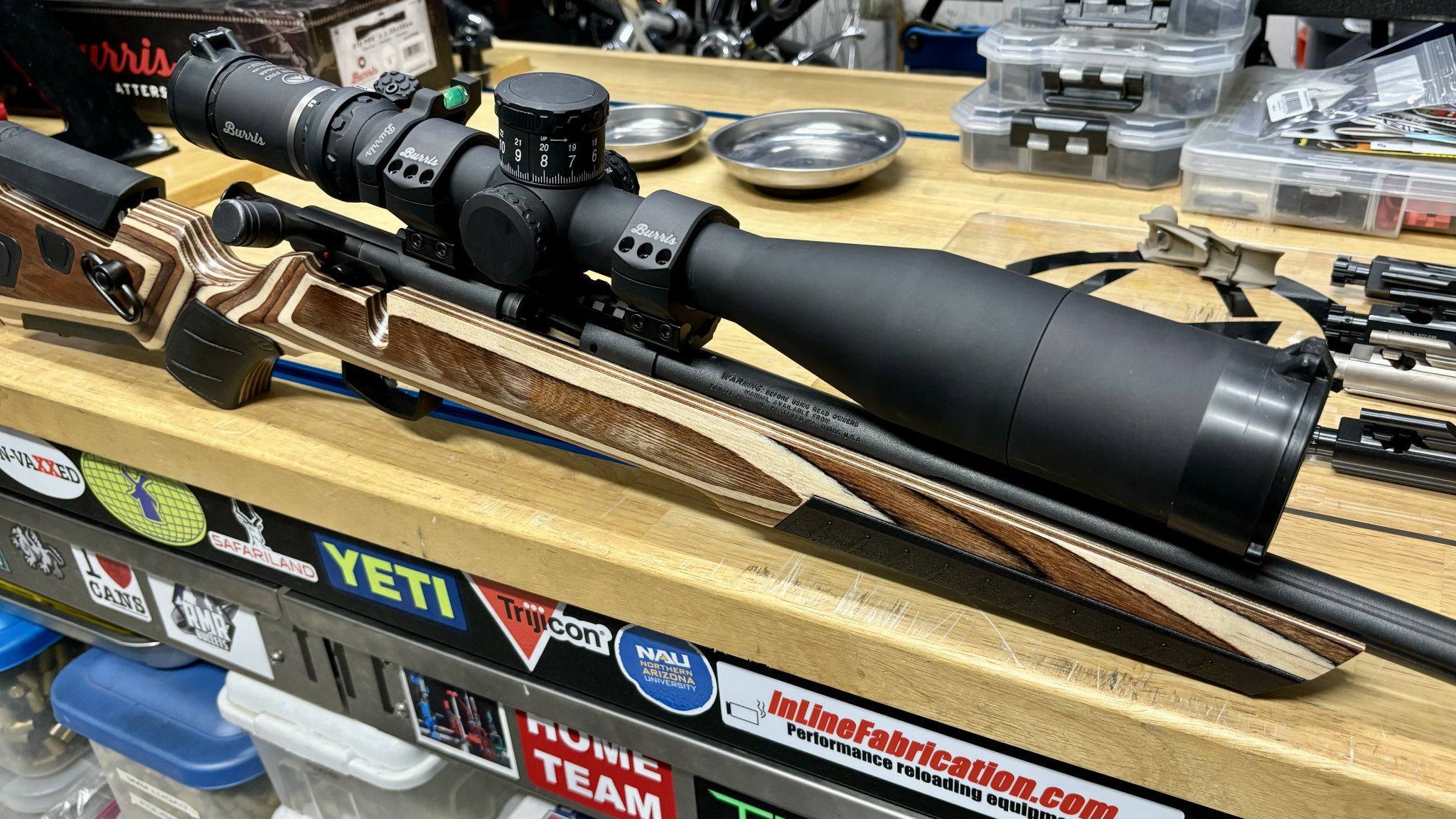

Both Burris will be mounted in the Burris XTR Signature Rings. First one is mounted on the Savage Mark II FV-SR. The rings are little more challenging to get set up, but again, it’s a very cool concept. On this rifle the rings are on a 20 MOA EGW base. I used the base MOA, scope internal adjustment, and ballistic calculator, and came up with a guess that the 20 MOA ring inserts would get me close to having full internal adjustment available for elevation adjustments. Shot a couple at 25 yards and it appears once I zero at 50 I may be able to get the 5 MOA ring inserts in the back and get myself a little closer to having that full internal adjustment available. All that to say, yes, the rings are a little trial and error, and hence more work to set up, but on a firearm where you need that internal adjustment, they may be worth the effort.
