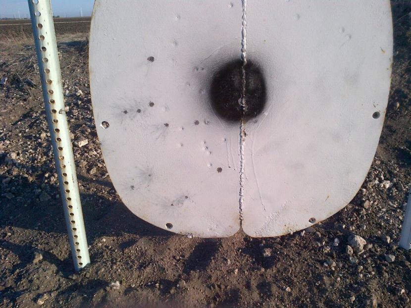

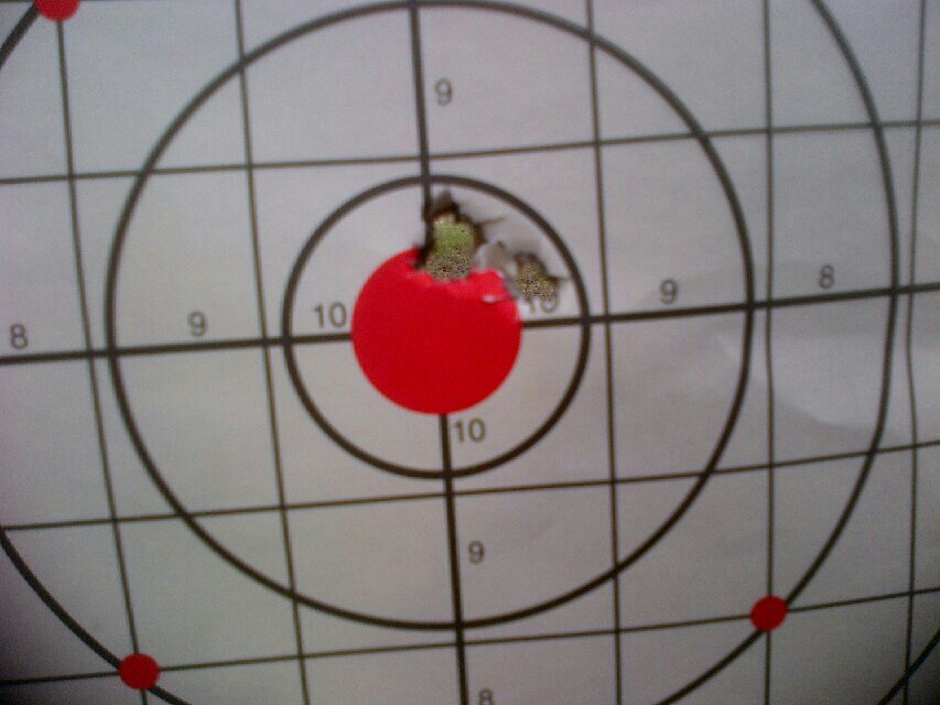

If you can't shoot a good group close it gets worse the further you go out target is a 3shot group at 100yds I pulled the last shot the plate is 1000yds.
