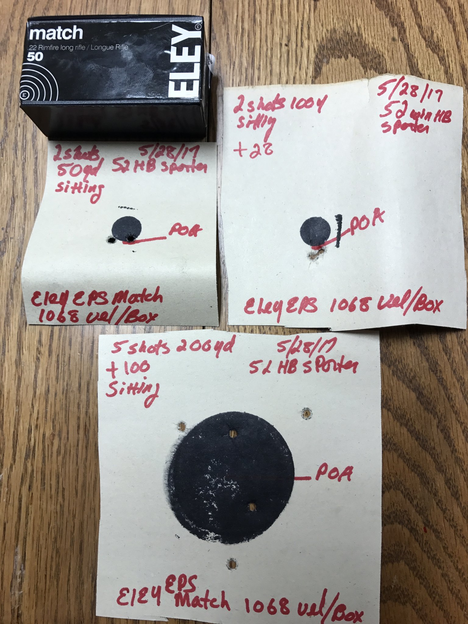

@justin amateur do you have any access or data for Aguila 60gr subs ?
My idea is in a vudoo they would perform better because of twist rate, 9 vs 16.
Any ideas or thoughts on this ? @RAVAGE88 have any input ? I don't have easy access to the 60gr here in Australia, however apparently I can order some to try, lead time will be horrible. Worth me trying or not ?
I'm not a fan of the Aguila 60 gr ammo. Low quality, a lot of variation one round to the next within the same box of ammo.
Hope this helps....

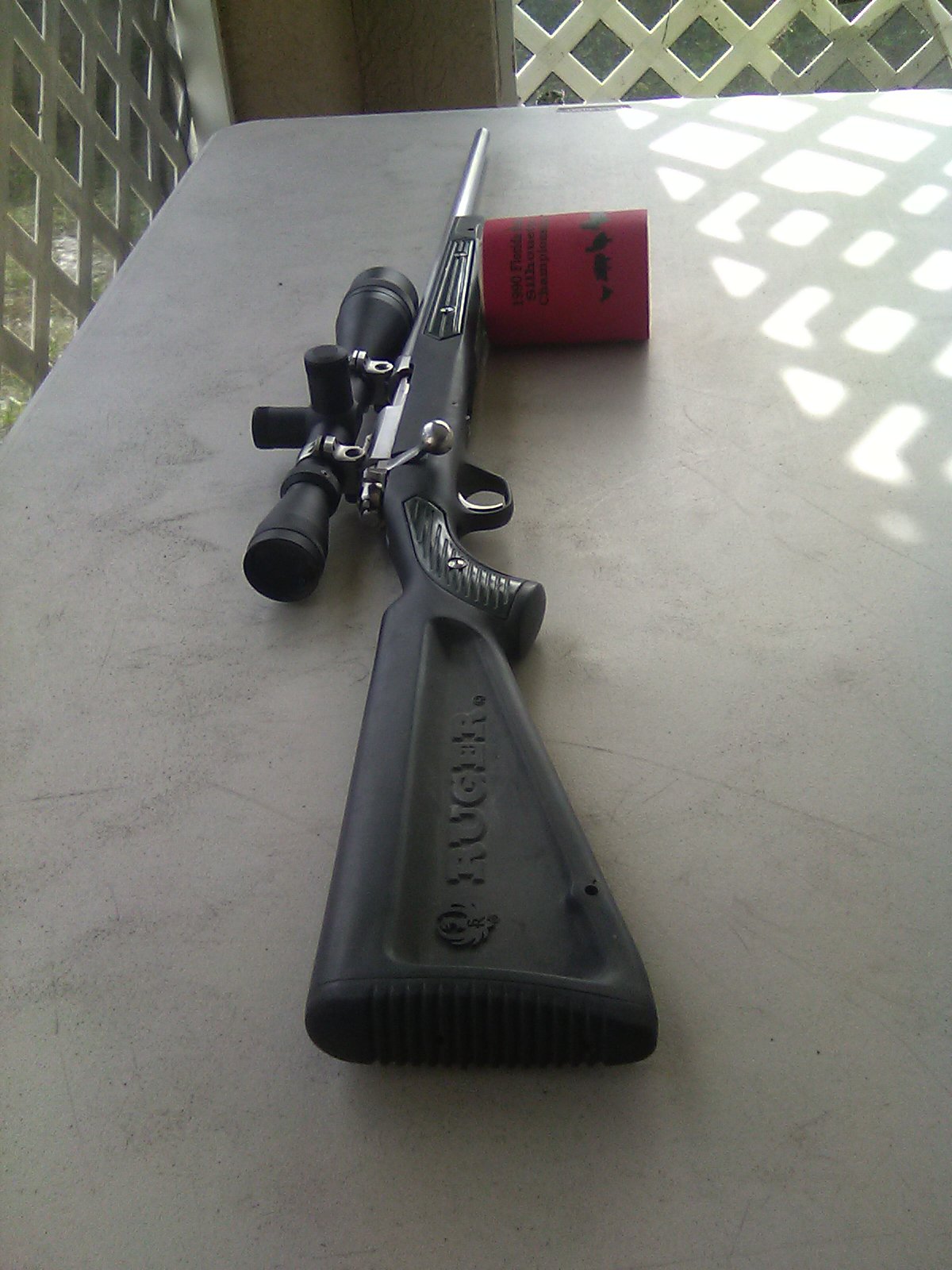

Here is mine Ruger 77/22 all weather that shoots cci sv at 1/5 nra mall bore silhouette targets at 50,100,150 and 200 meters
Nothing fancy Leupold 6x18 with Hawke 25 MOA shims .It will reach 300meters no problem .

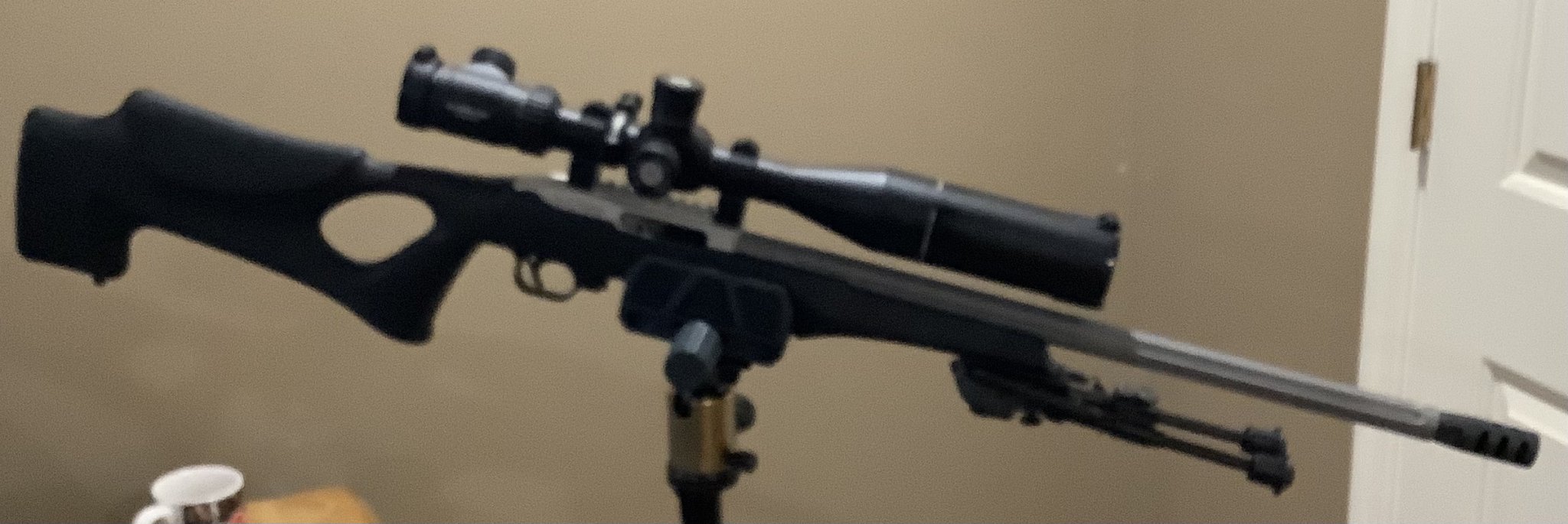

CZ 455 Lilja, Sinclair bipod, rear bag

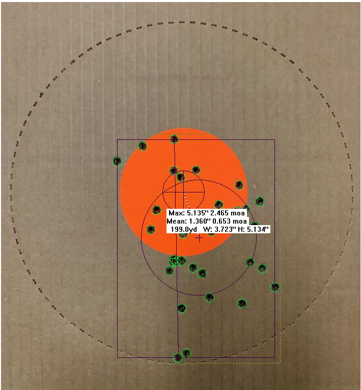

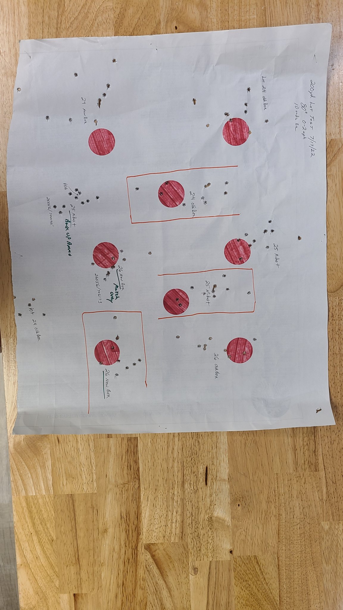

ES in excess of 100 fps, 12.5 inches of spread, not RWS's best.
It is labeled as hunting and plinking ammo.
AM-JKLWTB1hUpm5G5GeTlpj9whifL5cwAOrR9rv_C-Hip26gAPSDz0cao1YANSqM72gI8QlzCsm0vpxU3FHE-br7xTn4PEISFUlE11bcbhB61nYdGahw374ydx_i8kJhPHdJe_4CtX1nAG_1u6r6bsECjE1O=w552-h643-no
This cartridge has an mv well above the transonic region.
Passes through the sound barrier just before 100 yards.
Yet no keyholing visible on target. Clean holes in the backer.
Spread in direct relation to distance traveled, no different than I see
from standard velocity 22lr. No big variations relative to time of flight.
Results due solely to cartridge quality, not muzzle velocity.
These cartridges produced 2 inches of spread at 50 yards,
5 inches at 100 yards and 12.5 inches at 200 yards.
All on cartridge quality, not transition caused spread.
The bullets pass back down through the sound barrier between 75 and 100 yards.
If the transition had any effect, then the double the distance triple the spread rule
should have shown a major jump in spread.

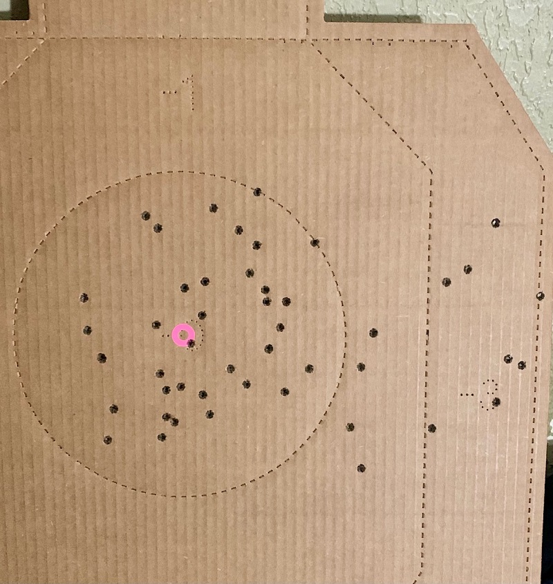

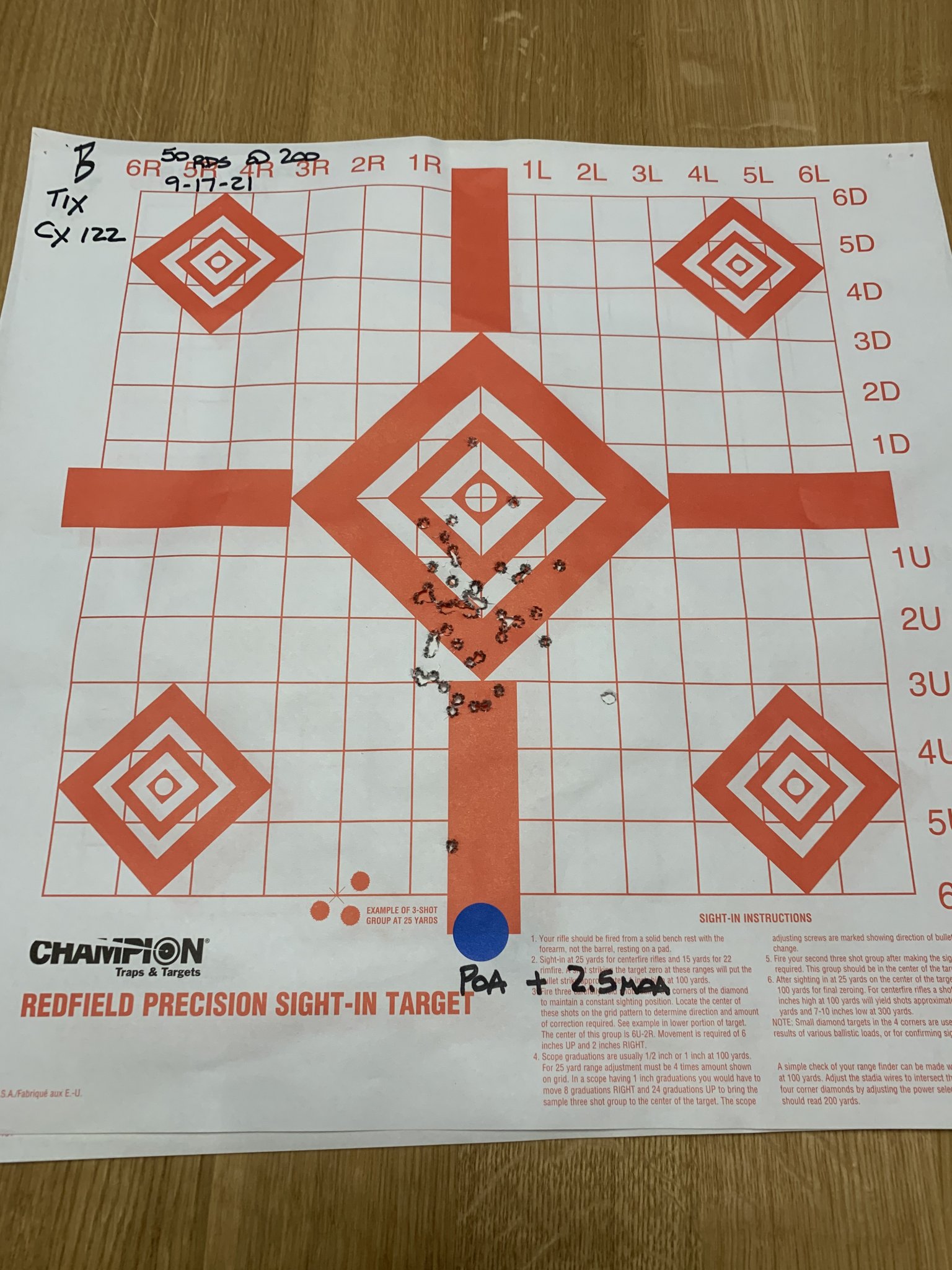

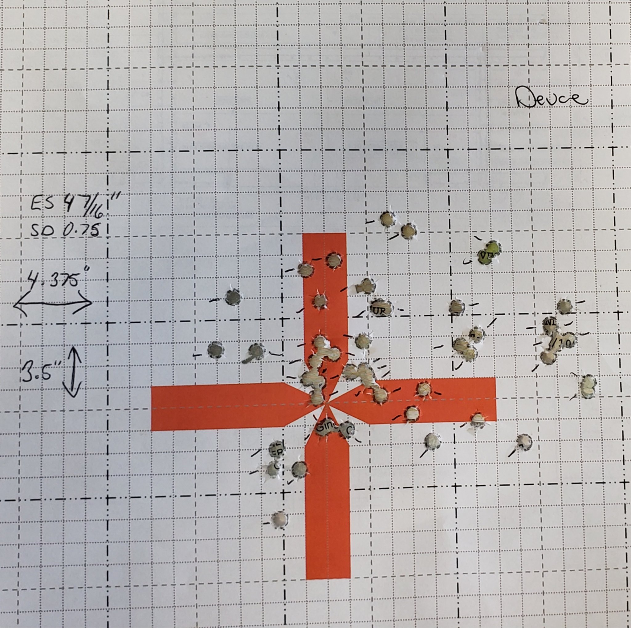

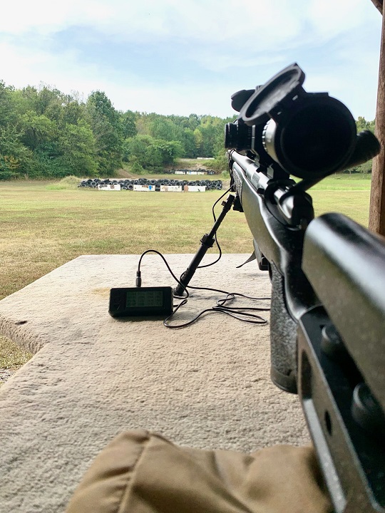

I'll play! Full disclosure.. I suck, the Kestrel LIES, and I can't read wind worth a crap but got a handle on it-ish. :LOL: Anyways, Bergara B14R with a DeadAir Mask (and a MagnetoSpeed bayo hanging off the end as well), and SK Standard+.
Full size IDPA target...
First three shots didn't detect and I had to crank up the sensitivity...
Hey Nut.... wasn't all that difficult to accomplish, was it?
Next time, pay attention to those wind shifts, watch those vegetation movements.
Wait for the lull, then squeeze. Standard plus is adequate for short range use,
but for 200 yards, use a midgrade or better to minimize cartridge defect caused strays.
You should be capable of sub 5 inch 50 shot groups,
with some decent ammo and a bit of patience to wait out the wind.
Try it again, better ammo, let's see what you can do.
Don't forget to drop a scale next to the results for the pic. ;)

Rifle Pron coming up!
Could have sworn I had a pic of down range... I'll get one this weekend when I go back armed with some SK Rifle Match and Biathlon!
P.S. The -0 circle is 8" if that helps but I'll dig out some scales!

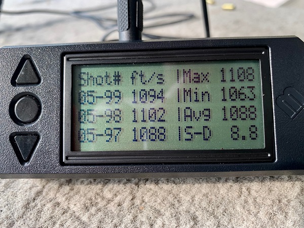

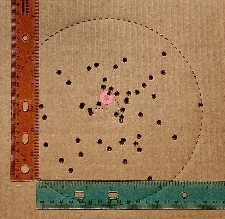

Went and tried again with Rilfe Match this time. A 99 round sample size gave an SD that was a smidge smaller but ES is larger. Winds were running 0 to 4mph at the bench and the grass at the target said there wasn't a breath of wind up there. This is too much fun and I know I can do better! On to the pictures and results...

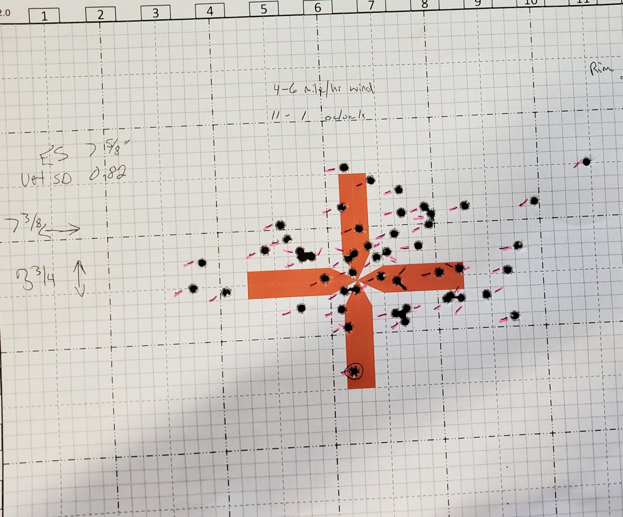

Went back and tried again with SK Standard+. Full disclosure only 34 shots as I had to re-zero but losing the suppressor (and the MagnetoSpeed bayo) really helped! I'd guess the vertical shrunk by about 35%. Gonna do it again tomorrow with Rifle Match....
Same rifle pron. Same view. :LOL:
Daaaayyyyyuuuuummmm 545!
If you hadn't a caught them hot and weak cartridges,
that'd a been a sub 4 inch group...jumping carp crap! :D
Bet the ES was 65 fps based on the hi-low points of impact. :(
Reactions: nikonNUT

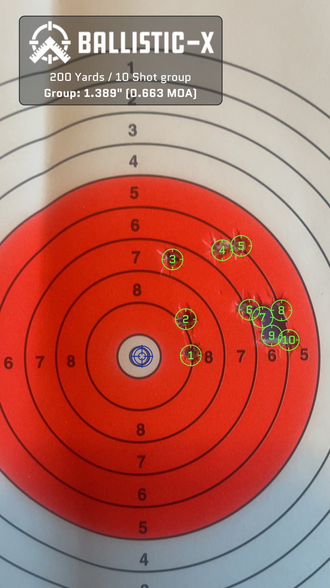

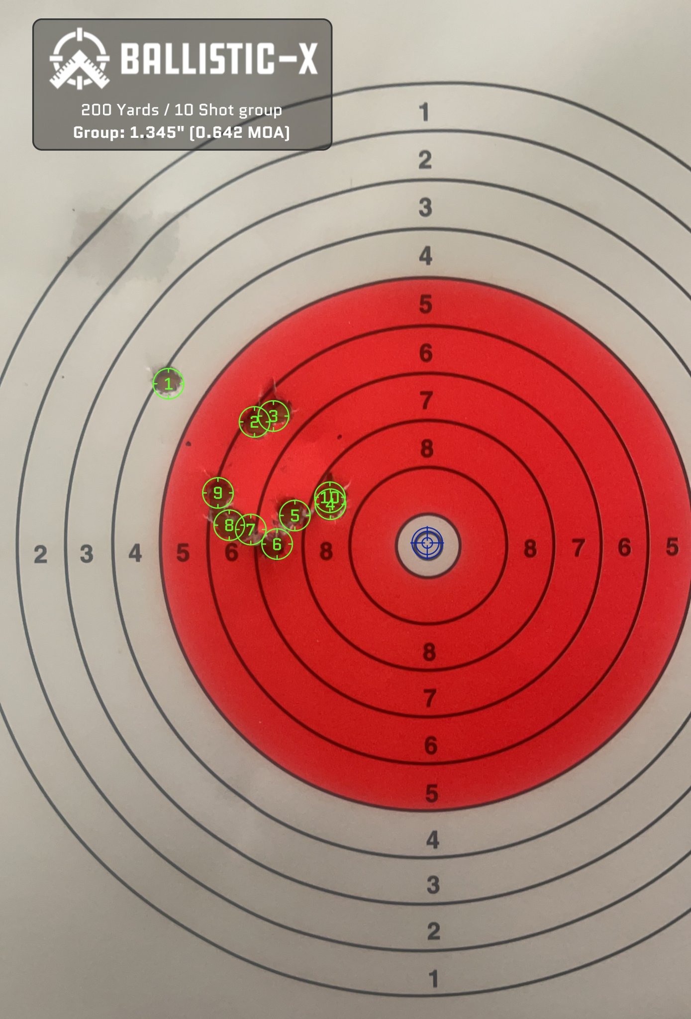

I don’t think there is any way to avoid those odd ball rounds unfortunately. This is the lot that showed best during testing at Lapua. Super cool time chatting with Luke while we watched our 3 T1x’s get tested for best lots. BTW all 3 of our T1x’s favored diff lots. I didn’t expect to see just how much of a difference there was between 3 guns being that they set up identical. After seeing the results in person there is no way I could have tested to that level on my own.
Haven’t done this yet but I like the idea. Will post some groups next time we go to the range. Been shooting ten shot groups out to 300 yards on 18” steel plates. Have tried 400 and 500 yard shots but the wind was not cooperating either day. Fun stuff!
I have done a lot of ammo testing. Numerous brands from Lapua center x to CCI and nearly everything in between. My particular set up likes Fiocchi 300 match. If we are plinking Federal auto match shoots well too. I can consistently shoot 1 moa or less with either. Anything else and the groups open up to as much as 2-3 moa. Ammo is everything especially when it comes to rimfire! You will not get sub moa groups with a $2.50 box of ammo. Fiocchi 300 runs about $14.00 a box here when you can find it. It is good stuff! Standard deviation is between 5-10 FPS if memory serves me correct.
The trigger is the other part of the gun that helps with tightening things up. We use ours to practice for ELR since we cannot shoot beyond 1500 yards here locally. 500 yards with a 22LR is about the same as shooting a mile with a 300 WM. I’d say a little harder considering we have done the latter with some measure of success but not been to consistent with the 22.
We are shooting a custom T/C 22 Performance center 10/22 with an Athlon Argos Gen 2 6-24 on it. It is a fun little set up. I look forward to posting some pics and data in the future. It will be fun and interesting to see the results. Good post!

I've intended to do this for some time. Finally its happened. Once again the vertical dispersion SD is the "same" as the 20 shot groups I use for the bulk of my testing. 10 isnt enough 15 is min above 20 is a waste of ammo unless its good therapy. Which it is for me.
I enter each POI into a spread sheet with notes. This lets me pull group data on a lot of ammo and compare how it did in different rifles or compare 20 shot groups vs 50 etc. Plot out how it did at 50 vs 100 etc. or any other way I find useful.

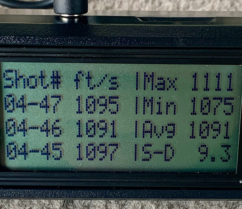

Shot at 23⁰c 986 hpa 4-6 mpr 11-1 wind I'm in the open so no funny berm stuff going on. 1098 fps ave both rifles
Ultimatum Deuce IBI 1-12 Eley Match
Rim X IBI 1-12 Eley Match wind really got me 🤷‍♂️ held 0.2 mil right to 0.4 mil left.

Ya' have to pay attention to detail at any distance,
but at 200 yards y'er focus has to be intense in order to maintain decent results.
My best is right at 4 inches of spread for 50 shots with the 22lr, limited mostly by ammo quality.
Break out the Shilen 223 F-Class and my hand loads, I can cut that in half, even with wind.
Thanks Justin! I've enjoyed watching what you all come up with. A few years ago I did a test comparing shots per group to see what was best for drawing solidish conclusions. But it was fun to do this again.
This is actually part of a bigger test I'm doing. I have a barrel I can run in my Deuce and RimX. I can also adjust headspace so both these groups are the same barrel and ammo but different actions and headspace.
Both are in MDT ACC chassis and I shoot prone with bipod and rear bag.

I have a Vudoo with a 20" MTU Ace. I shoot Lapua ammo pretty much exclusively.
With the current ammo situation lot testing means you buy multiple bricks when you can then shoot it and hope for the best.
Some will be excellent, some you can live with and others you wish for a refund, LOL.
Most all of the ammo looks good at 50yds, separation of the lots start to show at 100yds but getting out to 200 is where the wheels will come off for some.
Shooting PRS is what I do most, with time constraints and quick decisions on wind holds sometimes with the longer shots (175yds and out) I am left wondering what happened especially when target placement gives you zero feedback on misses.
So this brings us to the 200yd thread when I begin Shooting a bench silhouette match (chickens 86yds, pigs 122, turkeys 175, rams 205) that has a sheet metal backer plate for the targets so you get to see everything. In this match you have 10 minutes for your 10 shots, almost like F-class you get to watch and wait for conditions.
So I'm shooting the rams seeing the flash as they fall, impacts are within my wind bracket and then one dips out 6" below the waterline. This is what prompted me to run all my lots through a test at 200, this morning was perfect as there was virtually no left to right, the vertical dispersion shows in all it glory. Sorry I could not run 50 rounds at each target although promising lots were repeated for 20.

Wind beat me down hard at a little match yesterday. I'm shooting CCI SV, the guy who won is shooting SK yellow box.
Looking at your reviews of both boxes.... ammo didn't beat me. The dude is a legit good shooter.

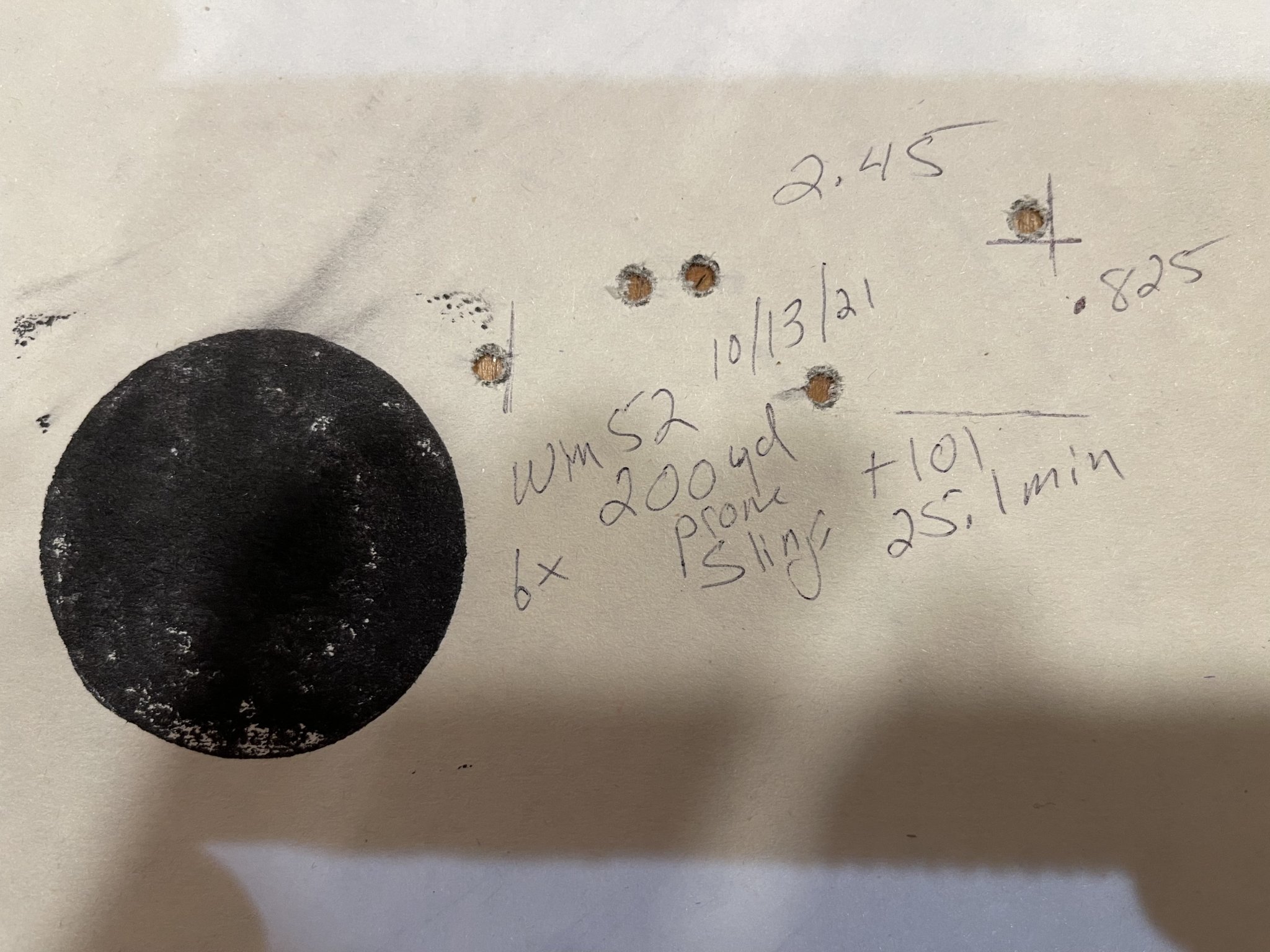

I will post a couple of 200 yard groups. No chrono data. Only 5 shots each. I simply have no interest in shooting long strings at paper. Rather squirrel hunt or take a nap. I shoot the groups to determine where to adjust the sights for longer shots on crows.
First target was shot to get data for custom
Reticule. No concern for windage. Details written on both targets. Note lack of vertical in first target. It was shot prone.
The large dot on the 200 yard target is 2”.
I am aware that these targets will be called “wallet groups” but really don’t care. They represent what my rifle does in good conditions. I don’t test in other than near perfect conditions.
Groups were shot prone with sling or sitting with sling and backrest.
My accuracy expectation at 200 yards is sub 4” under field conditions. Anything over is my fault. My average is about 2.5”. Occasionally I do a good bit better.
Both the rifle and ammunition were carefully selected over years of testing. Several dozen top quality rifles and countless lots of ammo.
Rifle is in bottom photo.
